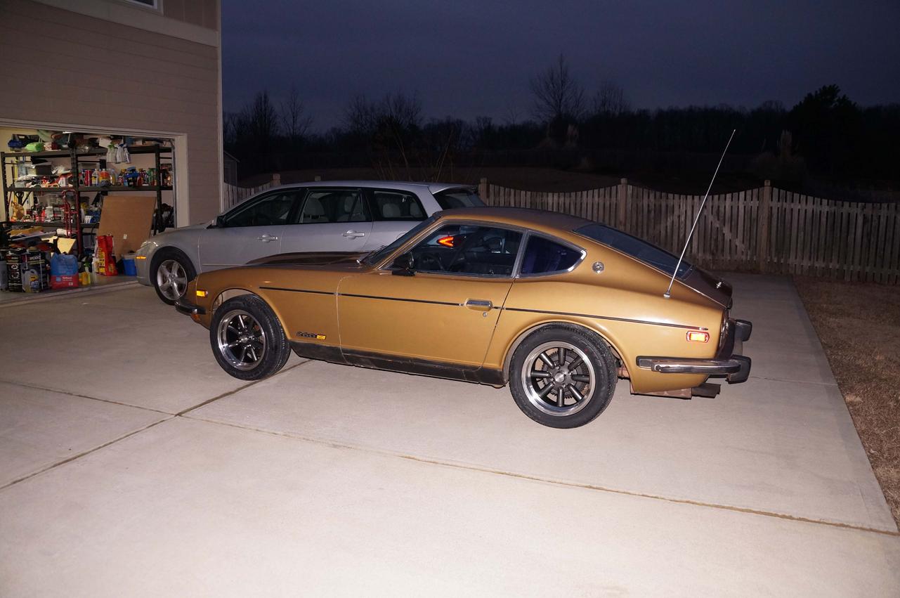

June 2, 201411 yr comment_449052 I like a firmer ride. With the stiffer springs and 16s, I do feel some bump steer when I get to the small drop at the end of the driveway. You can get a wider variety of tread compounds in the 16 inch tire, so if you want to improve performance and traction, you have more options.The Rewinds have received more than their fair share of complements over the Iron Cross ZX wheels that you can barely make out in my avatar. I think I have a picture of my car with the Rewinds in the "What did you do with your S30" thread. Link to comment https://www.classiczcars.com/forums/topic/49354-graphite-konig-rewinds-needed/#findComment-449052 Share on other sites More sharing options...
June 2, 201411 yr comment_449053 Here's the picture with the Rewinds. I need to take another to show the car with the new springs. Link to comment https://www.classiczcars.com/forums/topic/49354-graphite-konig-rewinds-needed/#findComment-449053 Share on other sites More sharing options...
