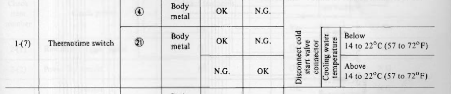

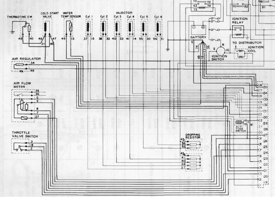

Actually, it's just a switch. It's either open or closed to let juice flow through the CSV. And you don't measure across the terminals, you measure from each terminal to ground. One side is the internal heater, the other side is the ground for the CSV. 4 and 21 are at the ECU connection.

That's the heater side of the switch. You want to measure the other pin to ground to see if the switch is closed when it's cold, like it should be. You should see a closed circuit, very low to zero resistance, on the other pin, to ground, when cold. That lets power flow through the CSV to supply fuel when cold.
