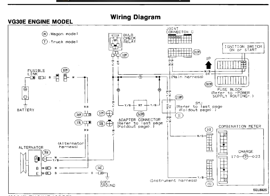

Here is a block diagram for an internally regulated Z and it shows the sense tapped from a downstream (of Fusible link)
For convenience, when converting from external to internal regulation, I connected the yellow sense to the 12V bus wire that is downstream from the battery through the fusible link. I guess if the fusible link burned up the sense circuit would fail however I am guessing the sense wire should be fused for safety.

Edit - as of 1995, Nissan was running the S wire almost to the battery post, or at least one connection point away from the alternator. Notice which side of the fusible link the junction is on, it's not actually at the battery, but it's still almost connected directly to the charge wire at the alternator.

I think I'll connect it close to the fusible link but on the same side as the alternator output. Like the 1995 diagram Zed posted. That'll account for the drop on the wires between the alternator and the link. Essentially it will regulate the alternator side of that fusible link.
