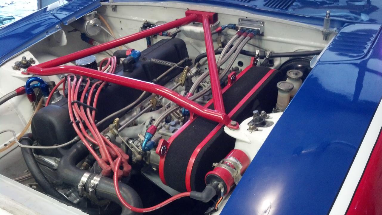

BSW - as someone who decided early on not to install an L28 turbo, an RB, or a LS motor and instead started with a stock L24 and have ended up over the last 14 years with a foolish 3.2L (L28 stroker with triples making 358@crank) running on 100 octane, do whatever makes you happy.
And yes, if you increase hp then you MUST increase your braking ability. As to the thought that all the hp is wasted because it just means you end up spinning your wheels and can't stop, well that is not quite correct until you get up over my level of rear wheel horsepower (or have trouble knowing how to artfully use both your right and left feet in unison). There are traction limited Zs with LS/LT/RB/L28-turbos and those folks got what they wanted.
As to S30 body Zs (70-78) being happy with just 150-200 hp, I have only to look in the engine bay of any of the early Bob Sharp race cars ( let's say they made a tad more than 200hp and might have handled just fine) or drive a friend's Z with over 400hp and the only issue is that I hit 140 as I transition into 4th gear. That said I understand the need for balance (think AC Cobra with a 289 instead of a big block) so plan your build in a holistic manner taking into account how you will use and where you will use your Z.
And if my engine couldn't go 30 minutes without a cylinder wall issue being a concern, I'd replace the engine or engine builder.
So which engine is in the car now? The L24 making 240hp or the L28 making 285+ with a CR of 13.5? Can either spin the tires? Does going from a stock 150hp to 285 make the car handle any differently? In the dry, no. Do you need more brake? Yes.

An L6 can go plenty fast, Pierre Perrot had one up to 160 mph at El Mirage in the 70's, and there's a member on this site that runs the quarter mile in the mid-twelves with SU's. If that's not fast enough you can turbo it or run a side draft belt-driven blower.
For engine swaps, I like to see something different. There are a lot of RB twin cam swaps in my area but I bet they'd get some attention in Louisiana. Plus it's keeping it in the Nissan - Datsun family and it's a high-revver. How about a twin-turbo V6 from a 300zx? Probably some around in early Z's, haven't seen one yet, though. Or even one from a late-model Z-series. Or be a real iconoclast, find the biggest rotary engine available, and swap that in. Of course the best swap would be an S-20, with the 2400cc kit (available in Japan). That one would be pure Z-ness. Maybe expensive though.

Through lots of research and all the comments. I am going to keep it nissan. I just have to decide if it will be the l28 or rb25. And so far leaning toward the L28. I lean more to the purity of it and that most people look for bigger and better but efficient is often overlooked. It is appealing to me. Thank you for all the various input and links. As soon as I am settled on my new location the build begins!
