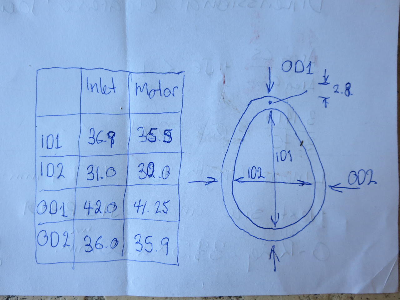

Problem here is that the O-ring has taken a set from years of compression, and the groove that it sits in is not round, so it's not like you can easily measure the ID and OD. Depth is no problem, but anything having to do with circumference is tough.
I measured my old O-rings using a gauge of appropriate diameter. I came up with 33 or 33.5 mm depending how much stretch I estimate occurred over the years. I suspect either size would work OK, and if it comes to that, I'll just order both sizes and use the one the feels right. Of course, I'd still rather have a recommendation from someone who's already had success.

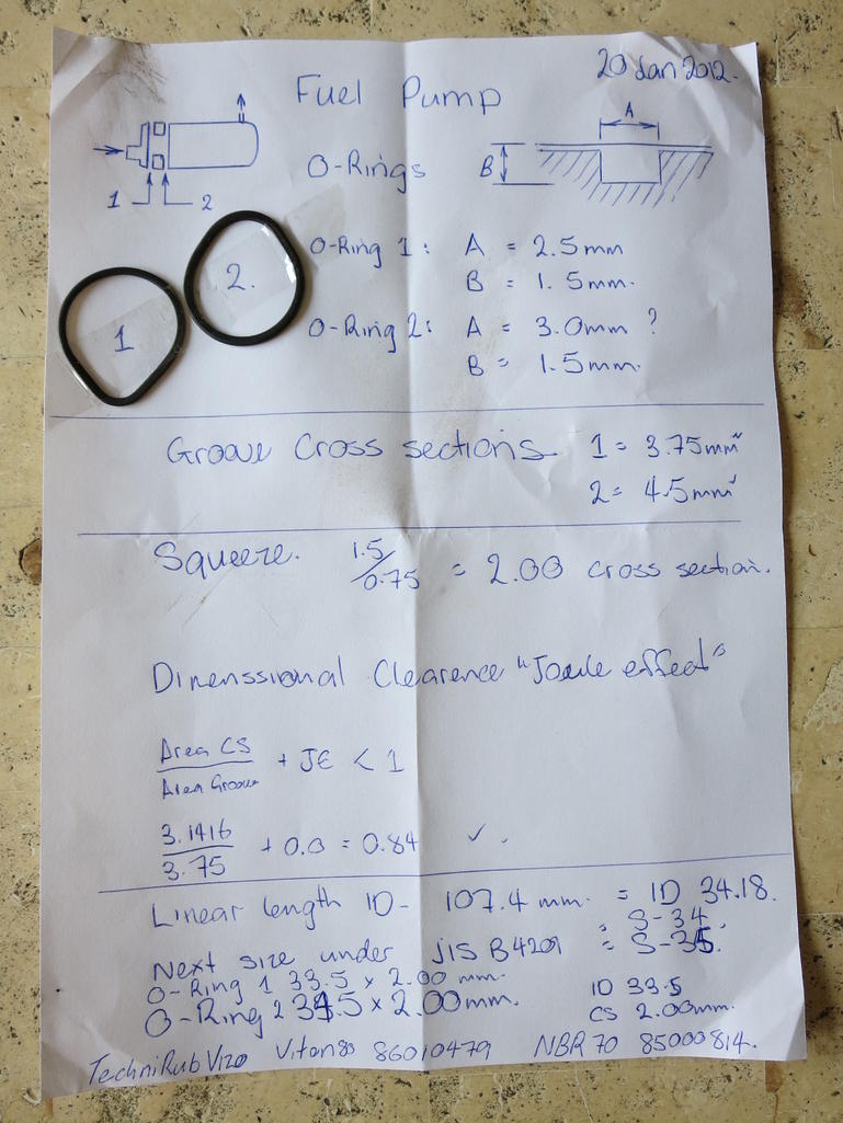

I found my notes and the old o-rings for my pump. You are right I noticed a difference in the groove width. The depth is 1.5mm for both, but the groove by the motor is 0.5mm wider 3.0mm.
The o-rings I used are 33.5x2.00mm and 34.5x2.00mm. They are both according to the JIS B4201 standard. Numbers S-34 and S-35.
I ordered them at a local rubber supplier "TechniRub Vizo". See photo for the workings.

Just to clarify. I used the same cross section 2.00mm because the depth of both grooves was the same and o-ring squeeze should be between 20 to 30% depending on material and hardness (often noted as Shore A or Duro).

I measured the depth of the grooves to be 1.6mm (instead of the 1.5 you got). It was a little tricky to measure because the grooves have a small radius at the bottom corners, and if you get hung up on the fillet on the inside corners, you'll measure a little less depth. I was careful to measure at the center of the groove, and I got 1.6mm. Slightly less crush than what you calculated, but more than enough.
I did not measure the groove width, but I will next time I'm in the shop.
I see that you calculated ID from linear length, and I was curious... How did you measure that?
I measured ID directly with gauges (rods of appropriate diameter) and found the IDs to be 33.0 and 33.5mm with the smaller O-ring located near the motor.

I noticed the different sizes in the grooves and took some measurements on the back side of the paper. See photo. I only had a set of the old non-digital type verniers at home. Shallow depth measurements are hard to measure, so my measurements could be a little off. I normally take fillet into consideration when measuring so the 1.5mm could be just a question of tolerances in my measuring:rolleyes: or from the factory.
The inlet cover o-ring is the larger diammeter. Looks like I got that mixed up on the front page.
I found the receipt for the o-rings and I ordered one size: The 33.5x2.00mm NBR 70A Part nr. 85000814.

The pump is German made so it could be DIN3771 standard used for the original o-rings. I know that in the seventies Germany used their own standards a lot so I don't think it will be an O-ring from the AS, BS or Le Joint Francias standards.
Linear method:
Where I work we use the linear length method to measure o-rings in odd shape housings like Lobe pumps etc. We use our standard elastomer suppliers for FDA/USP validation reasons. Some pump suppliers won't give the sizes, just their part numbers. To get around this problem we use a very thin plastic wire (a bit like plasti-gauge). Run that around the inside diameter and overlap the ends. Then cut though where it overlaps with a stanly knife. Remove it, lay it out and measure it with the calipers. Then use pye to calculate diameter.
