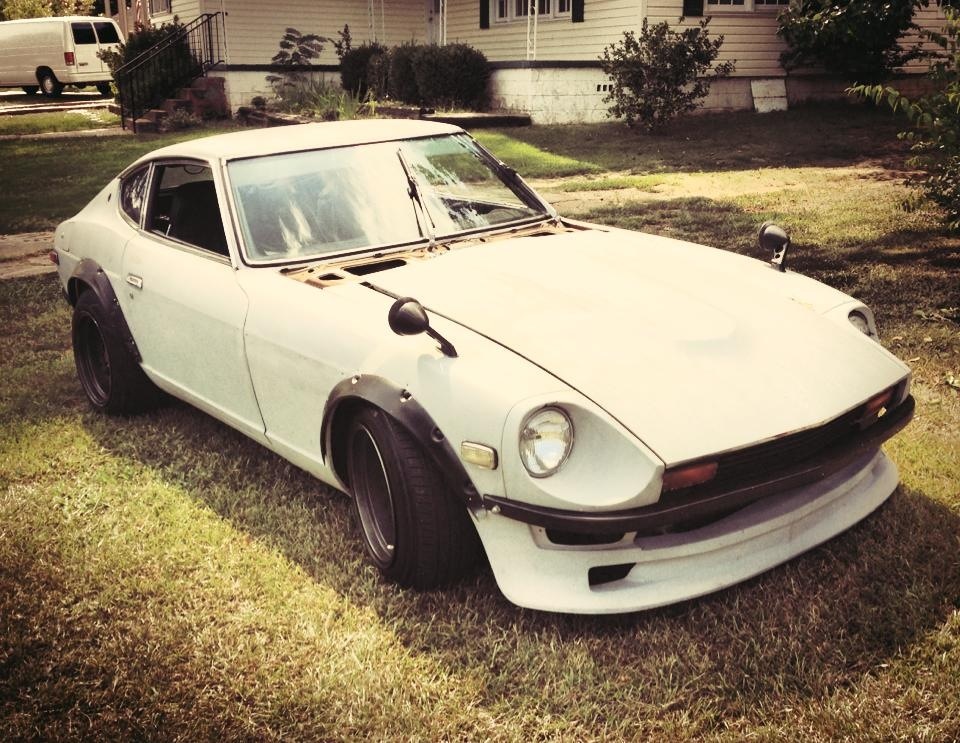

I've seen many pics of wipers sticking up and not laying down. I can get a new motor but wanted to see if there was a simple fix.

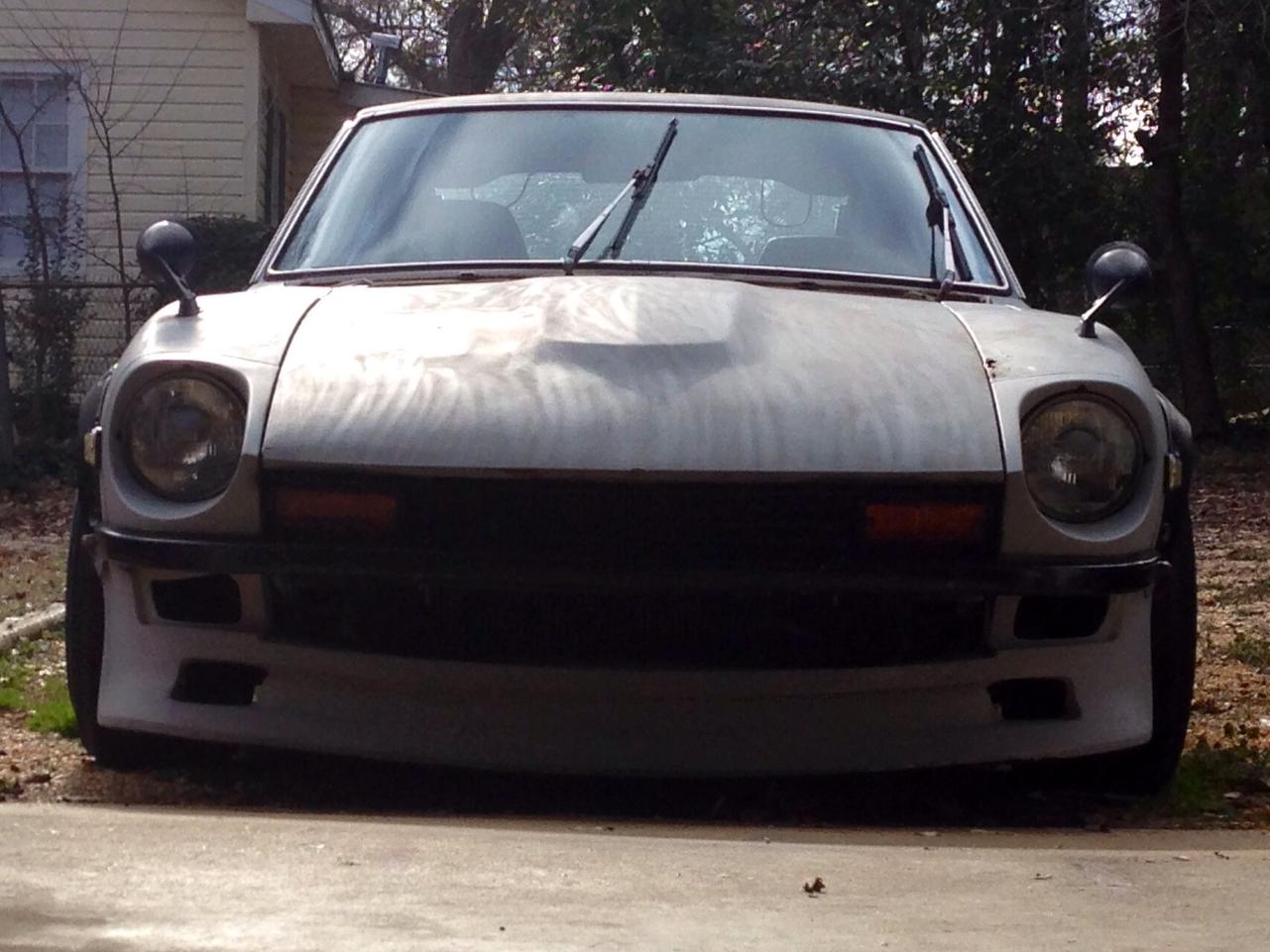

I think he's talking about the wipers parking in the up position.
Yes they park in the up position.

I want them to park in the normal position

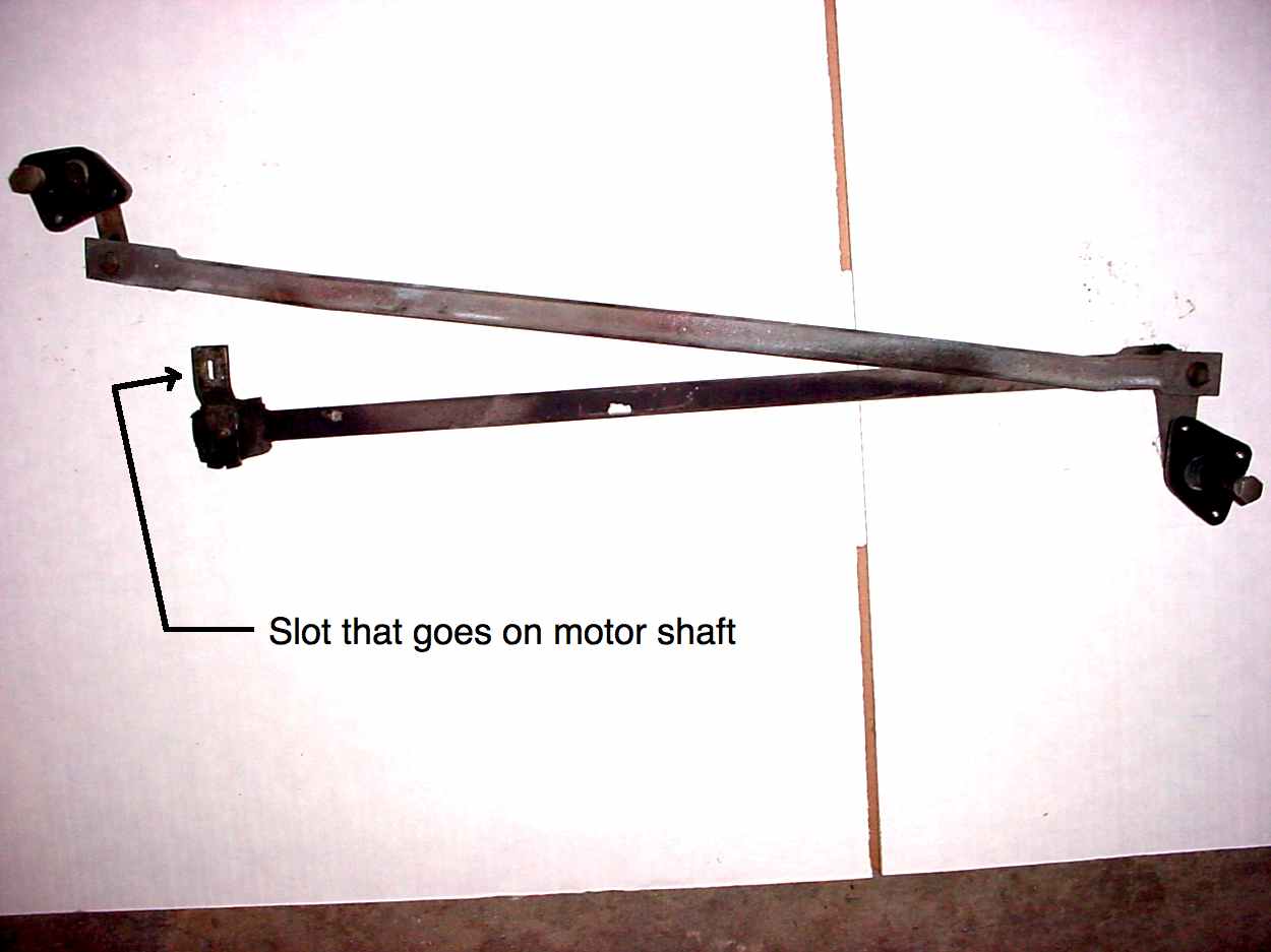

After I replaced the wiper motor on my 73 my wipers did the same thing. Turns out I re-installed the linkage wrong. It has been about ten years and I don't recall specifically what I did to fix it, but you might look into the linkage.
I wonder if putting the slot on the end of the linkage that goes on the motor shaft 180 degrees out would cause the wipers to park pointing up?
