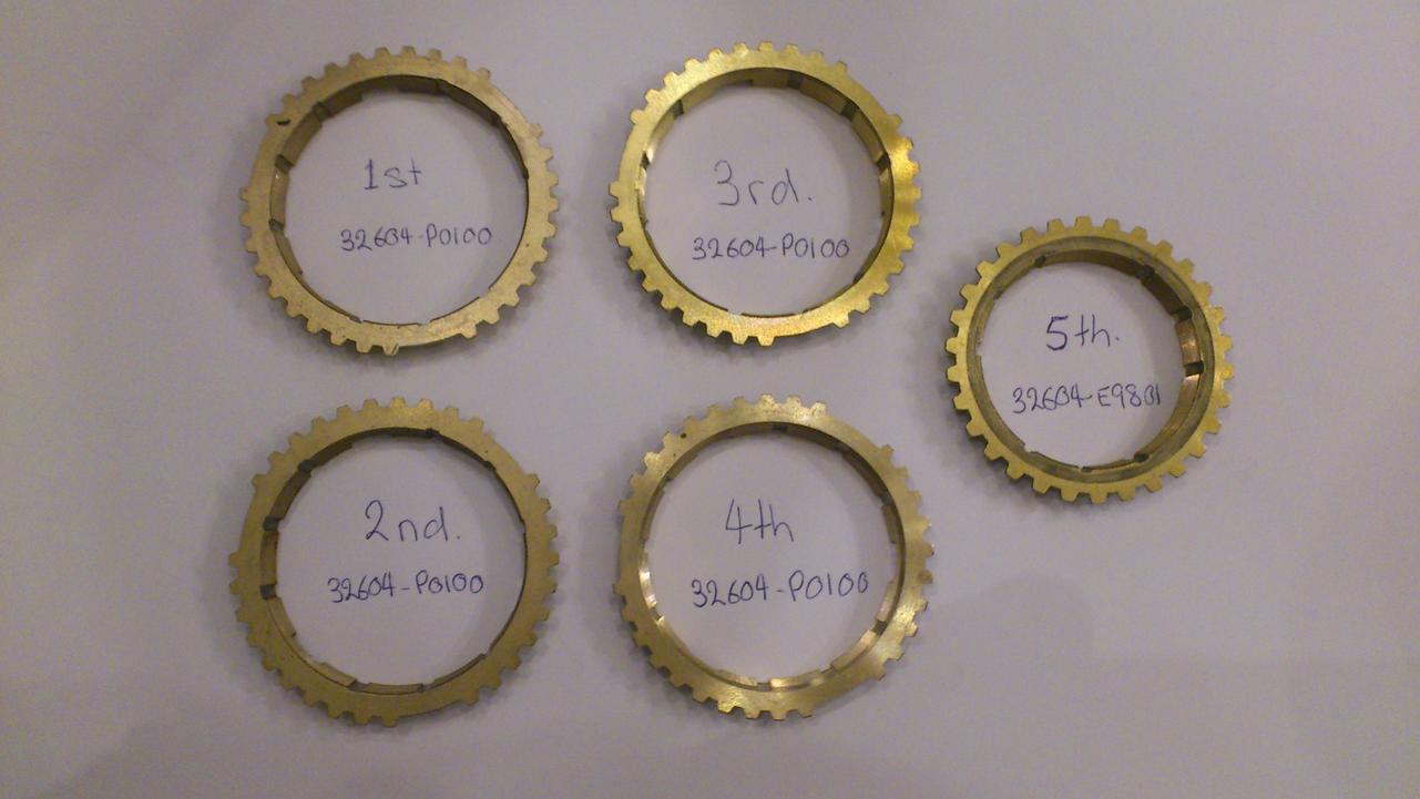

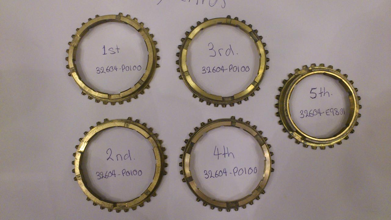

I found the info I used to order the synchro's for my tranny.
Synchros 1st - 4th are all the same. P/N: 32604-P0100 €26.85ea
The 5th has a smaller ring. P/N: 32604-E9801. I ordered that part number, but Nissan delivered 32604-36N21 €25.95ea. It was the same, just a number change.

All the 1 - 4 synchros in the F4W71B, FS5W71B and FS5W71C are the same and all still available through nissan. Somewhere in the 5 speed models they change from the fibre ring to the brass. The fibre ring is NLA. The later 71B and the light versie of the 71C also use the same brass synchro rings.
Im not certain about the interchangability of the later version 71C. Its the one used in the 240SX with the synchro on reverse gear, wider 20mm gears and thicker main shaft, but thats not the case here.

Here are some photo's of the spare set I have for my 71C out of a 300ZX.
