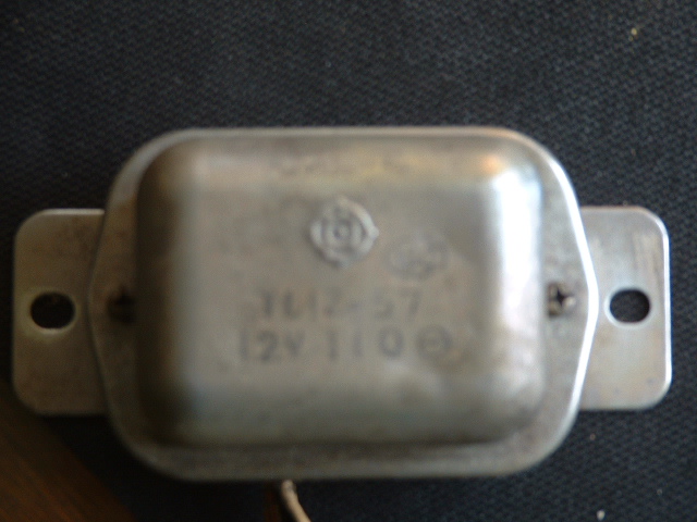

April 12, 200322 yr Author comment_33690 I bought one of those Furuhashi regulators off of eBay. It is almost identical to the one on my car. Here is a picture of the one I took off. Could it be original? Also on the side are 5 or 6 Japanese characters with "Heat Compensated" under them. Link to comment https://www.classiczcars.com/forums/topic/4806-voltage-regulator/#findComment-33690 Share on other sites More sharing options...

April 12, 200322 yr comment_33706 bought one of those Furuhashi regulators off ... Don't know about Furuhashi or whatever, but that is the Hitachi Logo on the cover. Link to comment https://www.classiczcars.com/forums/topic/4806-voltage-regulator/#findComment-33706 Share on other sites More sharing options...
April 12, 200322 yr comment_33707 That picture is his old one. Link to comment https://www.classiczcars.com/forums/topic/4806-voltage-regulator/#findComment-33707 Share on other sites More sharing options...
