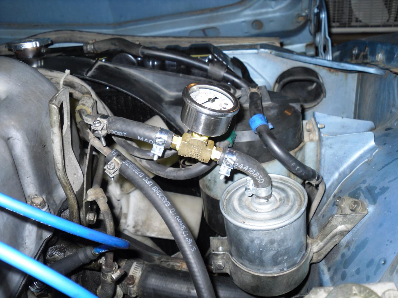

If you are not handy with threaded fittings and making them leak-proof you should probably buy or borrow a fuel pressure measuring kit. It will come with a plastic T-shaped fitting and a short piece of hose that are inserted between the filter and the fuel rail. The old fuel hose will be difficult to remove and may need to be cut off. Gas will spill. If you need to cut the old hose off you can just cut it and insert the gauge then replace the hose with new when you're done. Quicker.
If you know how to work with fitting you can buy a gauge and fittings and fabricate your own gauge system. Depending on the price of brass fittings at your location it might be cheaper to just buy a gauge kit at a parts store. The hose is 5/16" internal diameter.
Here's what I did at first. You can reach across the valve cover and rotate the throttle rod.
here's a good detail of parts needed to put together a gauge, http://www.classiczcars.com/forums/fuel-injection-s30/50946-sorry-redundent-help.html, read post #31. You'll be able to get the "T" and the hose barbs from an auto parts store, seems like I found the T in the brake line fittings cabinet.

I had a similar problem you are having. My 280Z was hard to start when it stood longer than a day or so.
If you follow the instructions from Zed head and siteunseen you can test the different sections of the system to find where its leaking.
I found my leak (check valve in pump) by doing these steps.
1: Fit pressure gauge between filter and fuel rail.
2: Run fuel pump until pressure reaches peak. 36psi. (engine not running).
3: Check leak down rate. (psi/minute)
4: Clamp the fuel hose shut. After the pressure guage. (I fitted new hoses and used a G clamp. You can change the hoses when fitting the pressure guage. Old hoses don't like being clamped shut very much).
5: Run the pump for short period to build up pressure. Be carefull not to overpressurise the system. You don't have the FPR to limit maximum pressure.
6: Repeat step 3. If the leak rate remains. The leak is in the pump. If it doesn't loose pressure the leak its further down the system.
7: Remove clamp. Run pump to build up pressure and then clamp to Fuel return line (From FPR back to tank) shut.
8: If it holds pressure, its your FPR. If it still looses pressure, it must be leaking through one or more injectors or the cold start valve.
I lifted all the injector with them still connected to the rail. Took some time getting them out, but then you can see if they leak with the pressure test. The cold start valve is easier to remove ( keep hose connected) and test.
