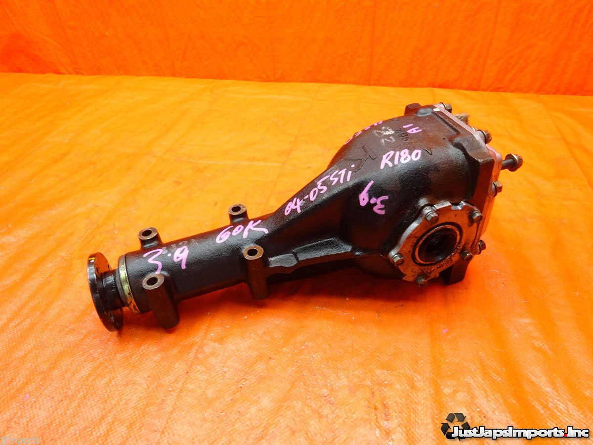

Yup... I like what you are doing but $500 for the stubbies from Wolf Creek is the hardest part of the upgrade in my opinion. There may be a less expensive solution. The Yoke solution arose from your trouble getting those short faced D cut bolts. A Yoke with 27 splined shaft would be a nice keystone.
To revisit an earlier part of this thread....
Couldn't the $500 for the Wolf Creek flange-shafts be saved by either A) installing splined yokes, as Blue mentions here, and then replacing U-joints to mount up the rest of the 240 half-shafts, or for that matter B) just re-using the flange-shafts from the original R180 that is being replaced? Even if opening the diffs were required to swap in the threaded buttons, it seems like a good way to save a bundle of $$.
Am I missing something here? That seems like the obvious and cheap solution.
EDIT: Never mind... I just figured it out. Datsun spines are 25 tooth, Subaru are 27. Bummer.

After installing a STI diff in I figured I would share my experience. Ok the folks at Wolf Creek say to hit the stub axles in with a hammer. Mine did not go in so easy so i put it on a press . Don't do what I did~! You must center the C-clip that lies in the diff between the shims of the LSD. I being a newbie did not know and broke the C-clip. Luckily it fell into the spider gear and locked the diff so when I turned in a parking lot it was like having a welded diff. After taking back out again and taking it to local diff guy he re-stacked the plates and replaced the C-clip all is good now. Much better handling ...
