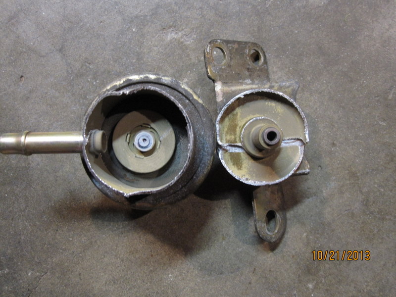

Messing around with things and I cut an FPR open, mainly for the mounting bracket, but also to see what the valve looks like. It's a steel tube mated against a steel disc, both highly polished and very flat. You can see how a little bit of crud or even just a hair could cause it to leak.
https://www.classiczcars.com/forums/topic/47764-inside-an-fpr-the-valve/
Thanks for that pic. That's a cool shot. The only one of these I have is the one on my car or I would have dissected one. Thanks for taking care of this. :beer:

Glad you got some value from it. I have an adjustable Aeromotive regulator that leaks down in seconds. It uses a big ~3/8" diameter steel ball in the diaphragm seated on a hole in the aluminum body of the bottom half. Terrible design for sealing. I even tried to fix it by lapping in a better seat in the aluminum but it's impossible. I'll probably sell it to somebody for use with carbs (it has a low rate spring for carb usage). That's what got me interested though.

Thanks for the pic. I bought a chiwanese adjustable online but haven't plumbed it in yet. I wondered what the quality might be. Hopefully, it will work out. Wiring a "prime" circuit in would also help out the leak down.
