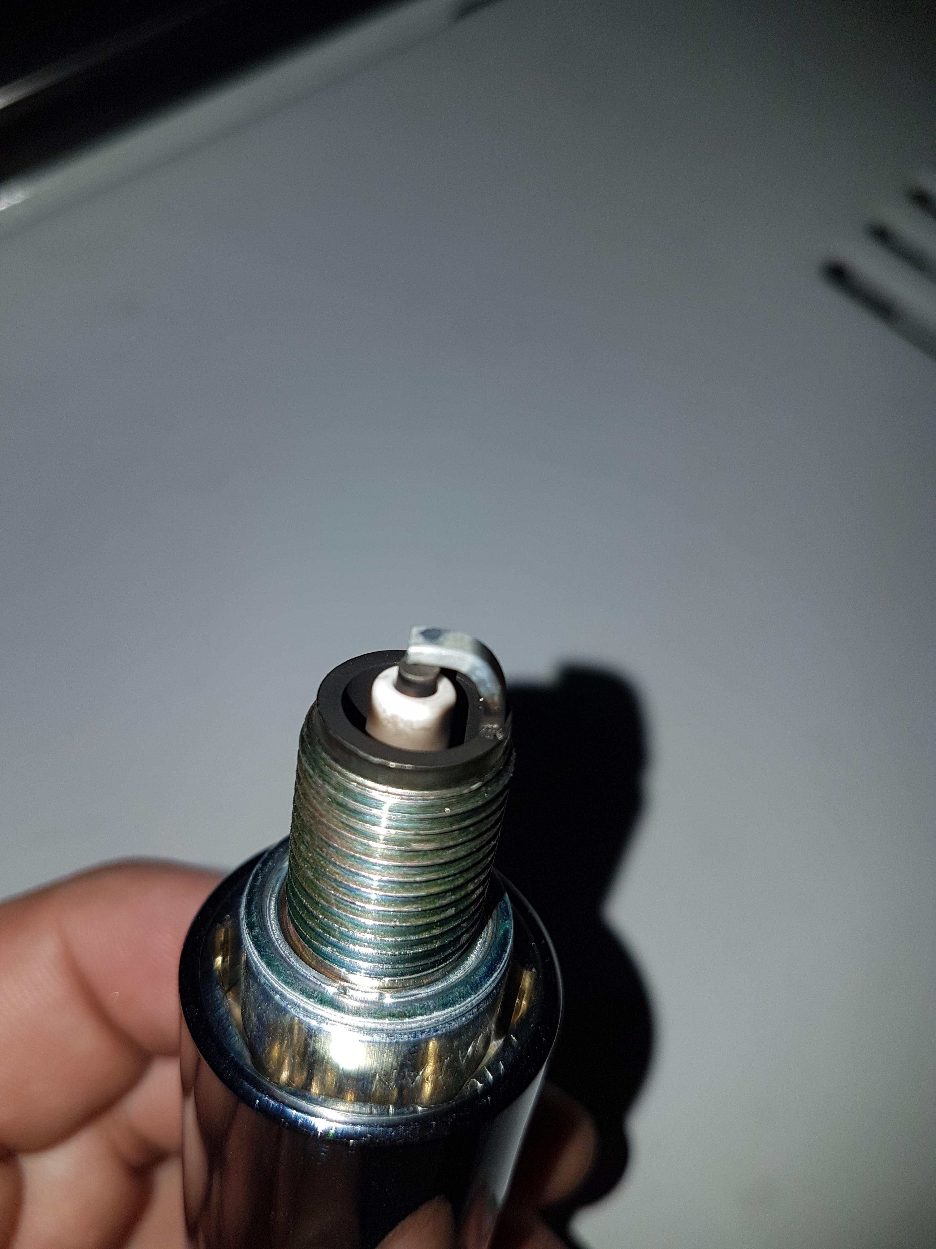

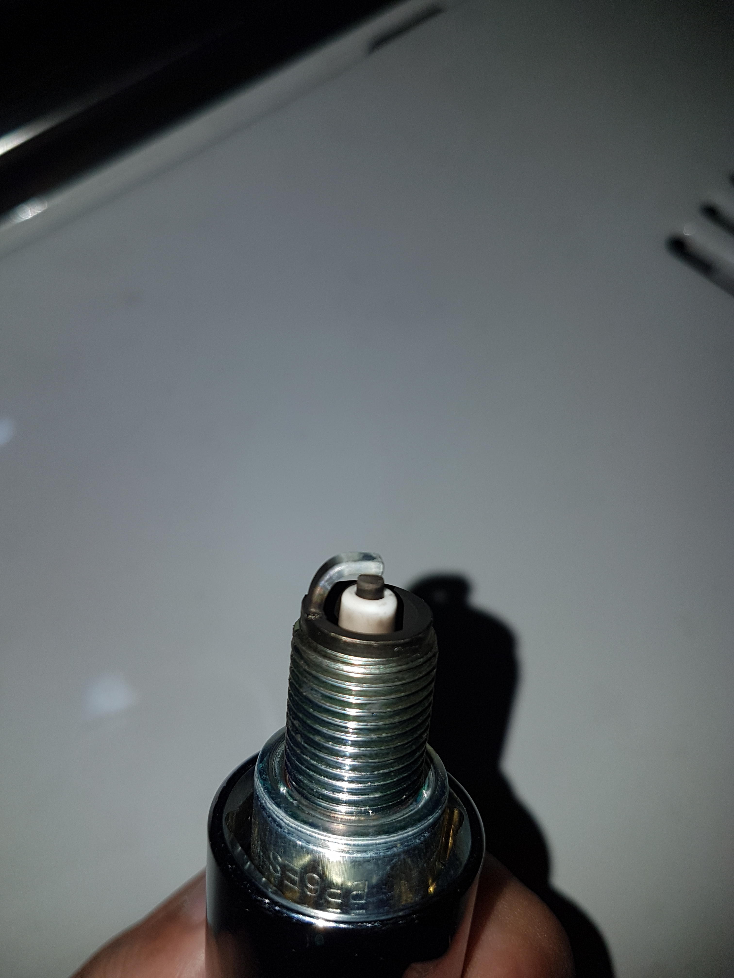

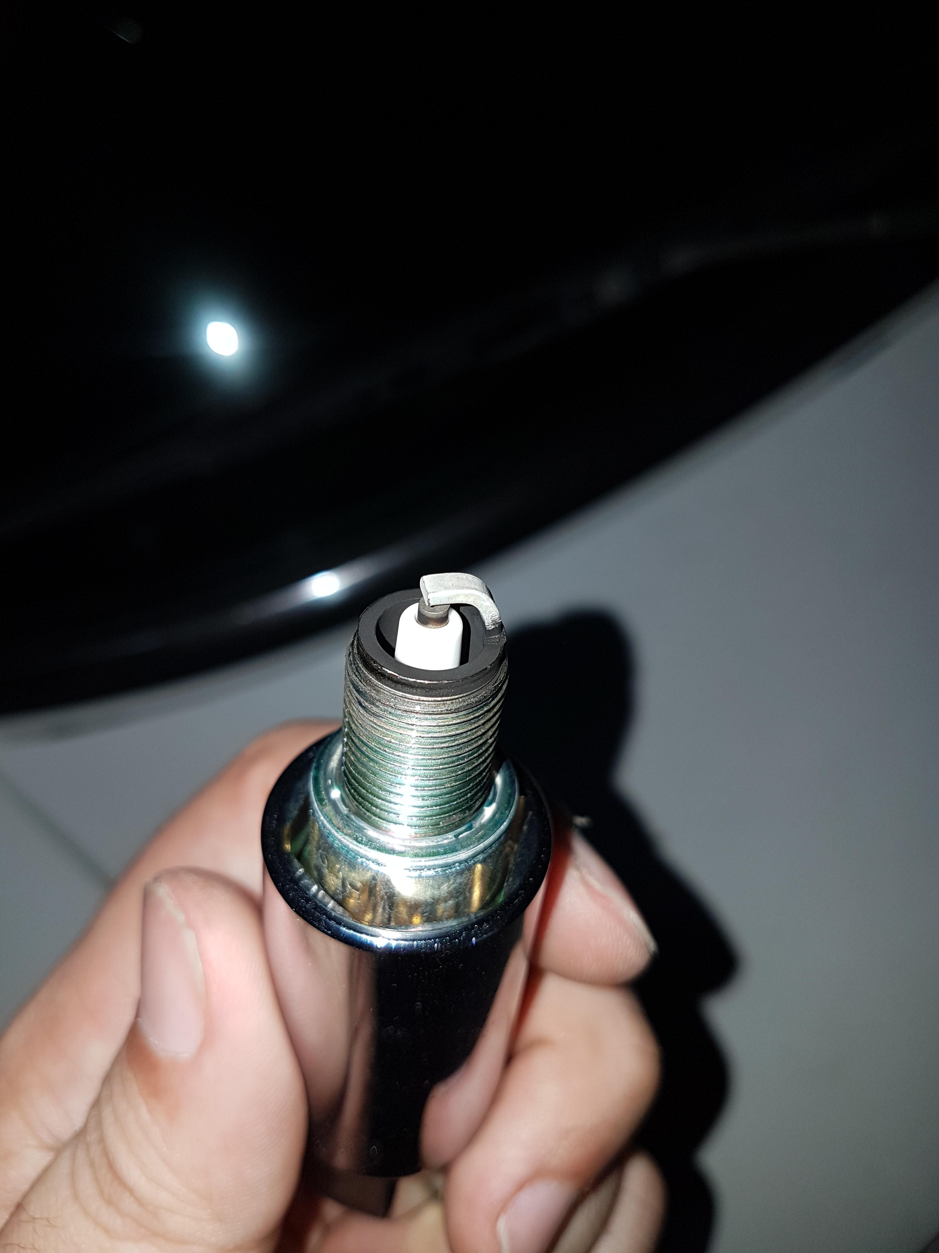

February 28, 20187 yr comment_543391 Plug 5 (rear carb) and plugs 2 and 3 (front carb). Idle mixture knobs both at 4 turns clockwise. Car gets stuck on 4 to 5k rpm. Needs more fuel at high rpm. Maybe wrong float adjustment. Link to comment https://www.classiczcars.com/forums/topic/47304-1972-float-adjustment/?&page=17#findComment-543391 Share on other sites More sharing options...
February 28, 20187 yr comment_543432 Looks lean. If fuel level was set correctly, I don't think you would need to be 4 turns down (I don't like clockwise or counter clockwise as it is specific to point of view). To me, clockwise is up or lean, but I think you mean clockwise as down/rich. So, have you removed the pistons and verified fuel is 1/16" down from top of nozzle at 2.5 turns down/out/rich? If not, why not? From there, fine tuning should get you darn near perfect with one turn of nozzle adjustment in either direction. Edited February 28, 20187 yr by David F Link to comment https://www.classiczcars.com/forums/topic/47304-1972-float-adjustment/?&page=17#findComment-543432 Share on other sites More sharing options...
