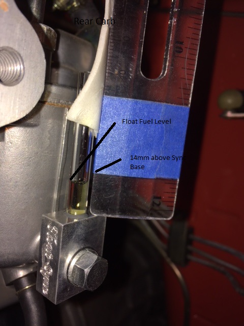

I have sync my carburetors and still have a stumbling problem. I am beginning the process of completely setting up the balance and fuel mixture. I first will set the needles and the float levels. Then the mixture. I have purchased a couple of items to help with the process. The "Float Sync"  setup and I have a color tune tool on order. I removed the air cleaner today and installed the "Float Sync" tubes. I have attached photos of what I have discovered.about my float levels. The "Foat Sync" instruction indicate that the optimum fuel level is 14mm above the base of the "Float Sync" tool. See photos. The front carburetor looks to be much lower than the rear and the rear is just a bit shy of 14mm. I will attempt to adjust and post more photos. I hope this works and that it will help others work through the process as I am doing.

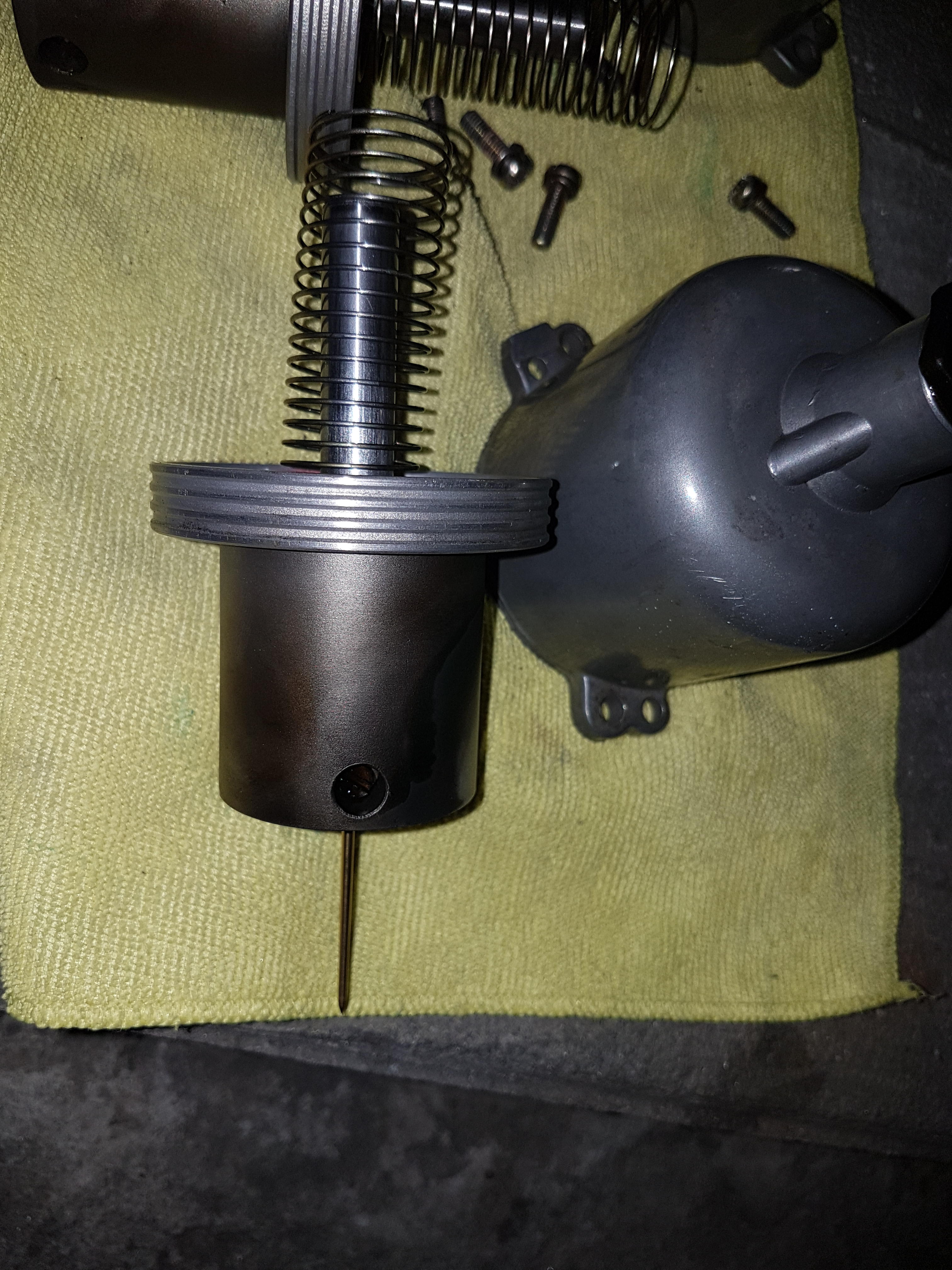

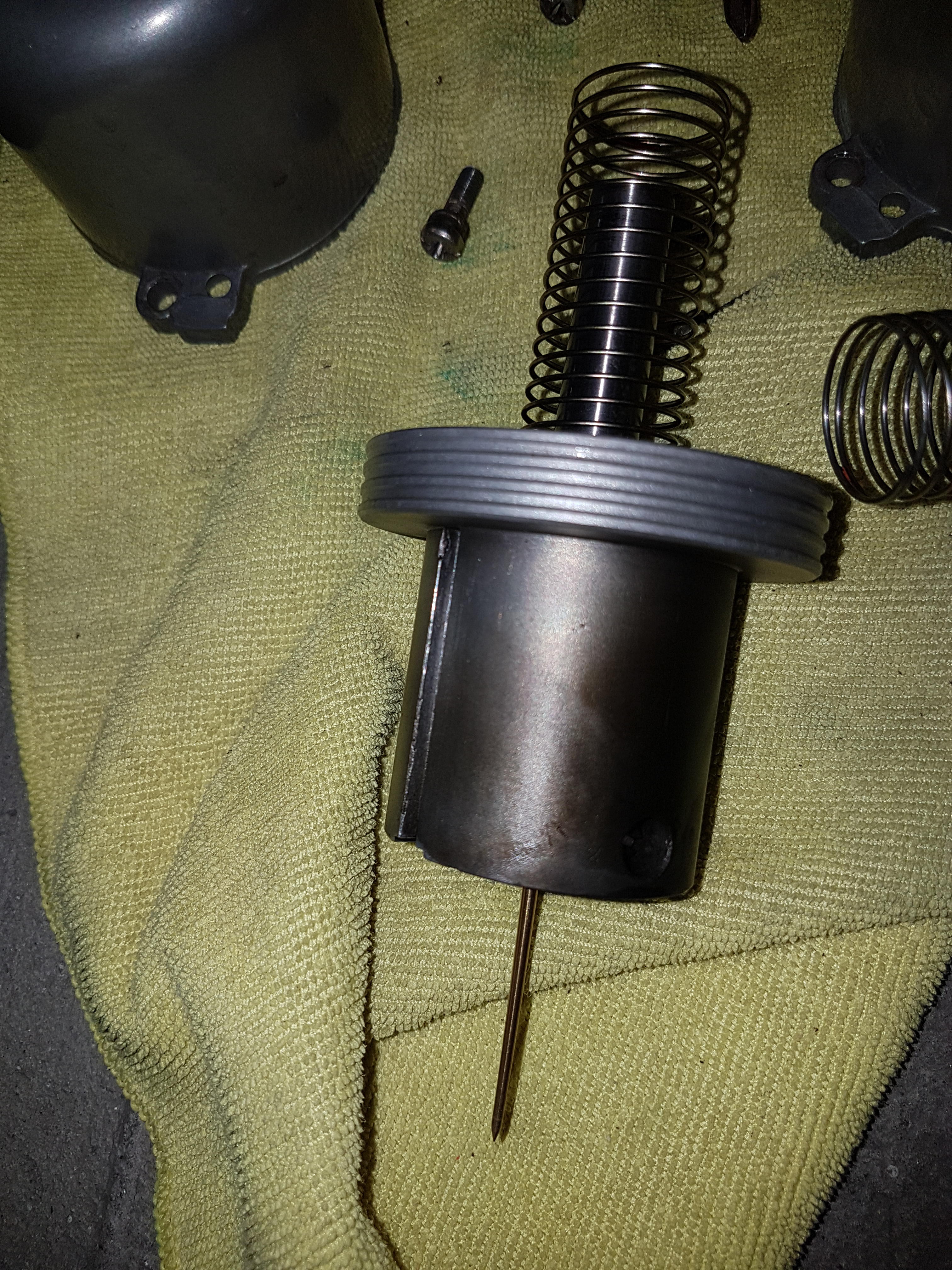

2 hours ago, jalexquijano said:
The weird thing is that i found both pistons black when i pulled them out. Could this be due to bad calibration of the .55 inch gap?
Based on that, are your plugs soaked too?
It just means they haven't been cleaned in a long time. They should probably be cleaned every year or two. Hit them with a couple good blasts of carb cleaner, wipe them off with a shop towel, and then give them one more blast. Same with the inside of the domes. Don't drop them or get them dirty before reinstalling. Don't set them down so the needle could get bent. It's a good idea to wear a gloves, goggles, and P-95 mask when you're using carb cleaner. When you're done setting the floats and tuning the carbs maybe blast the linkage with carb cleaner and finish with some lithium spray grease.
I would like to tune the floats myself. In trying to make him understand the both carbs must be at 2.5 turns clockwise and he said it is not possible as the car will run rich.
17 minutes ago, NVZEE said:
So a mechanic was “trying” to tune the carbs and the pistons looked like this? Maybe I’ll butt out now ...
What happened since they were rebuilt by ZTherapy?  Probably messed with to fix all of those other problems?
Let me add my $.02 on the blackened parts.
The inside off my air filter is black around the  bugle looking things that sit in front of the carbs. Don't know why but they've been like that all along.
Could it be the pcv blow back?  He's got one of those high quality California Datsun motors.
