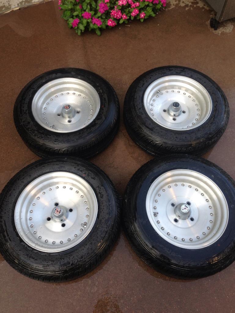

I actually recently purchased some 0 offset 16x7 Panasports with the intention of using them on this rebuild, but the shop that is helping me with the restoration has talked me into showing the car at some autorama events. As such, I'm am going to sell the Panasports. If anyone is in the market, I will knock off $150 from what I paid (I have the receipt). I also have 5 really cool and clean Centerline mags with very low miles on 185 70 14 Toyo Spectrums available for sale. Does anyone know of a good site to advertise these wheels and tires for sale?
The Panasports have been sold. The Centerline mags, plus the tires, are available for $200 if anyone is interested. They tires are very low miles and probably worth that much alone, for what it is worth.
