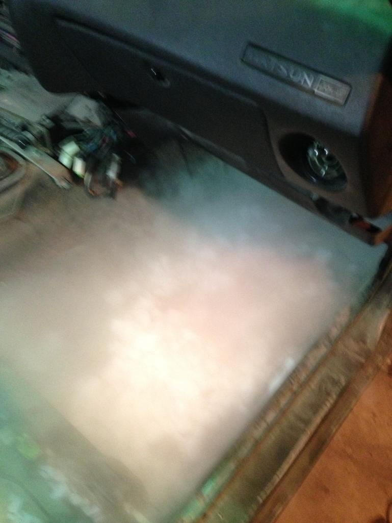

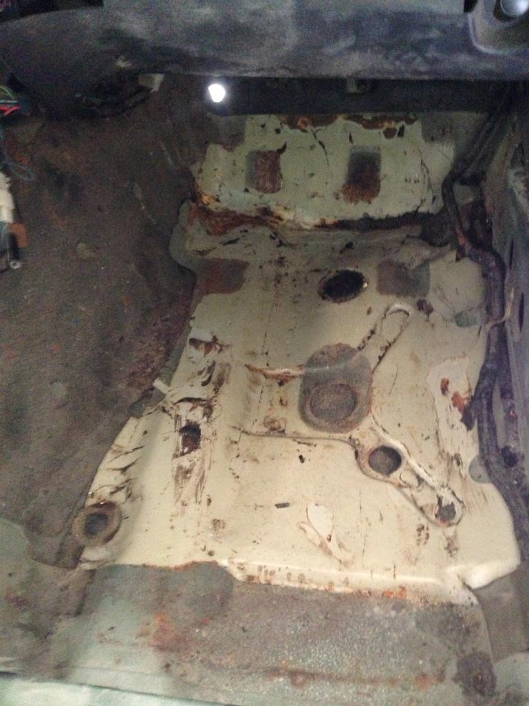

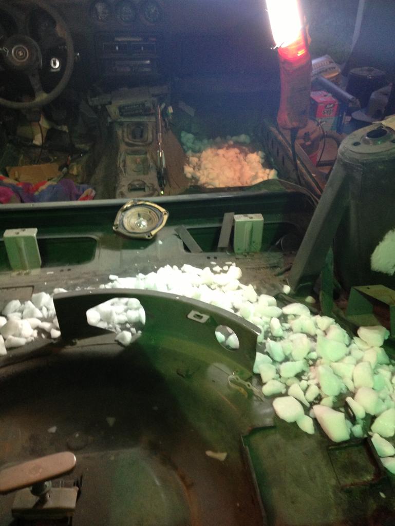

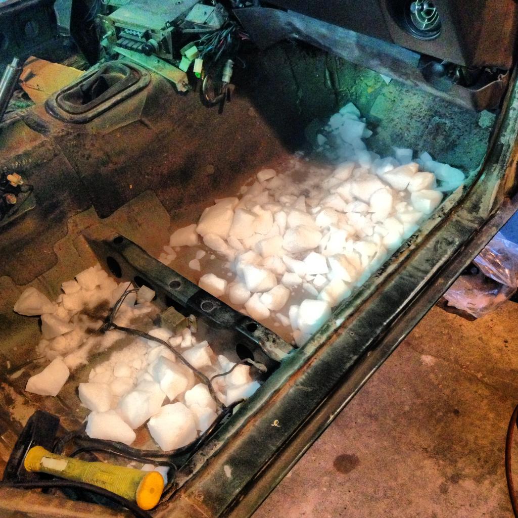

One more update, worked on removing the original rubber floor insulation. The driver side I used a heat gun, was messy and didn't come off that well. Passenger side and rear decided to try the dry ice method. I will never touch a heat gun again! Not only was it fun, but it worked great. The ice froze up all the insulation, and it came off in fairly big chucks with just a tae of a hammer in chisel.

Dry ice works great, you're right about never going back to heat gunning it.

Cheers and goodluck. Dry ice has the WOW effect.:D

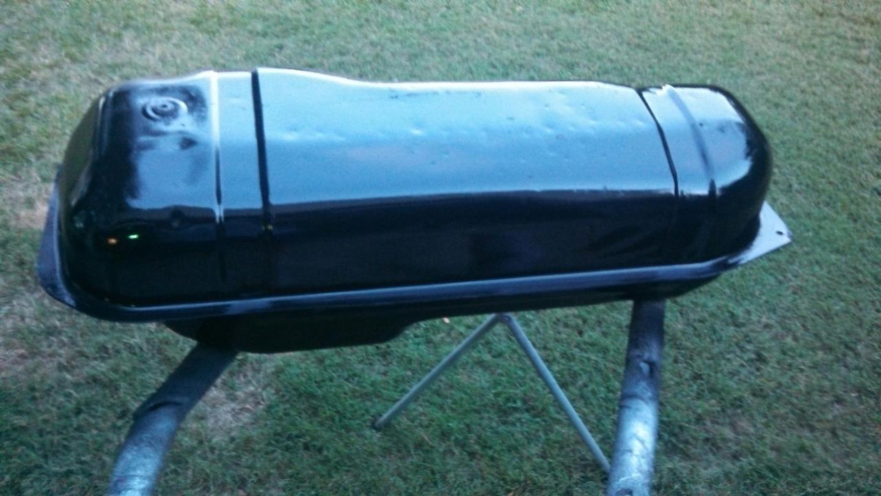

Gas tank painted, looks good!

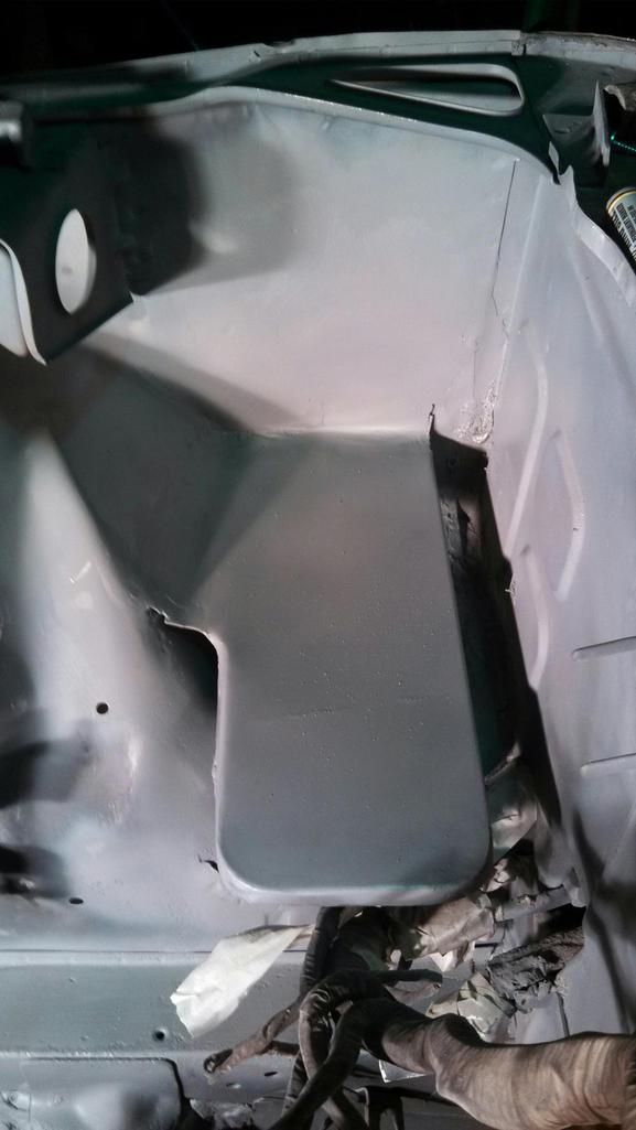

Got the patch for the inner fender and battery tray welded in. I know it doesn't look original, but it's rust free and it works. Plus the battery will be on top and no one will ever be able to tell.

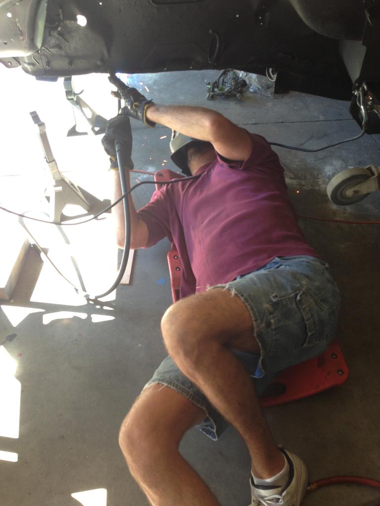

Pops welding in the sway bar reinforcement to the frame rail.

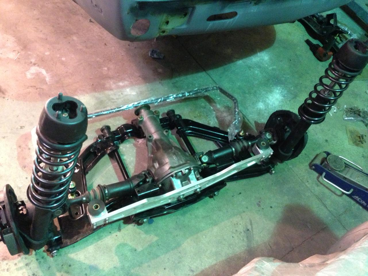

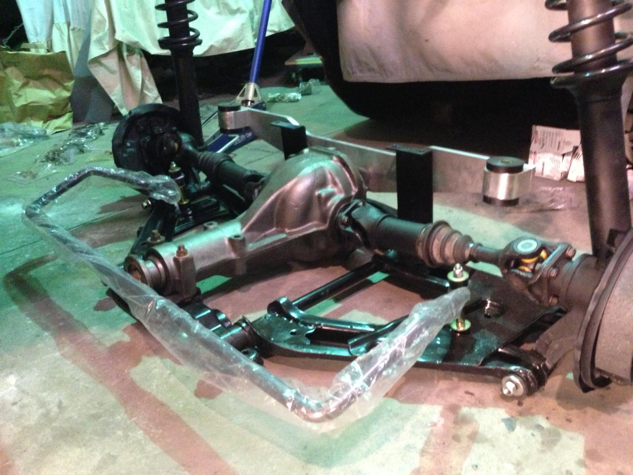

Front and rear suspension put in! The u-joints kicked my arse on the half shafts, the ears on the yolks were bent in so I couldn't get the C clips on. Had to heat them all up and give them some good smacks with a big hammer. The powder coated parts came out better than expected. Plus I added the Arizona Z billet mustache bar for some bling. It looks great.
The toughest thing about the front suspension was putting the urethane Tension arm bushings in. They have absolutely no give, so trying to get the bar to line up with the control arm was no easy task.
Also my driver's side bushing on the rack and pinion doesn't fit at all, in my opinion it's flat out the wrong design. I googled this and have read other drivers having this same problem. Some suggested boiling it and stretching it out, tried it, it had no give at all. I e-mail the company stating that their bushing was no where close to fitting, they basically said I was crazy, so I e-mailed them back with a picture of it not fitting. Then they e-mailed me with a phone number to a random "Z expert" customer saying call him and he can help. Thanks, that was a helpful answer...not at all.

Also I forgot to note that the MSA sway bars are thick and are pretty close to matching the paint. I like them a lot! They were a bit of a pain putting them in, just from the tension and getting in the way of things, but well worth it!

I forgot, also dropping the gas tank off this week to get it boiled. I tried running various chemicals through it to get all the crap and rust out. It looks a lot better than it did when I first dropped it, but it still has junk in it. Boiling should get it looking brand new.
