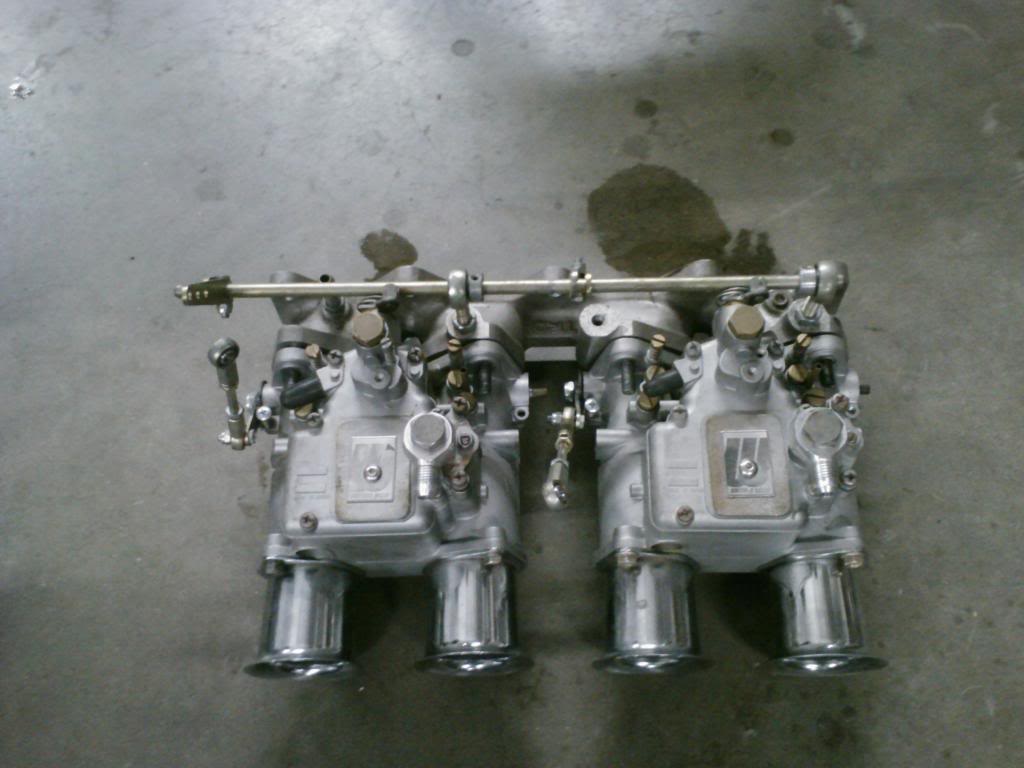

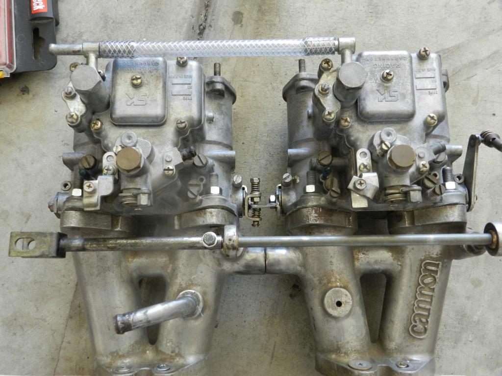

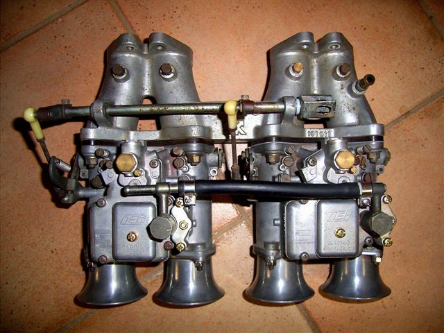

I have a set of sk 45 units with matching sk manifold and my roomate has oer 45 units with a mikuni manifold. We love these carbs. I will be doing a blow through setup with mine using an Hks surge tank. I have been searching for an sk unit but have come up short.

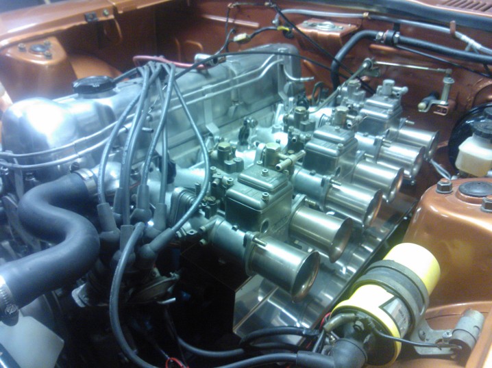

Good info and good luck with those. Remember to post (a lot of) pictures of your setup. I just noted, my first post was about selling these and now i have installed them in my Z, what the hell happened? LOL
Koalia, VERY pretty! Did you take pics while you disassembled and cleaned? Are you going to add air filter screens or "suck dirty" ? I saw 2 Z cars at shows this summer that had no air filtering of any kind and it wasn't just for the show, they drove that way all the time. Couldn't do it myself.

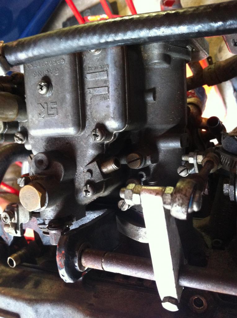

By chance would any one know if a webber dcoe throttle shaft would fit an sk? One of my carbs, shafts is bent and the throttle plate started digging into the carb itself. Not too bad, but enough for me to take it off and go with another unit.
Edited by mildsquare
You will have to check with someone who has dcoe45's. dcoe 40's are no go.
I just checked dcoe 40's with my sk40's and the sk's have a thicker shaft with the 4 plate screw holes having different spacing. The end fasteners seem 1mm bigger on sk's.
