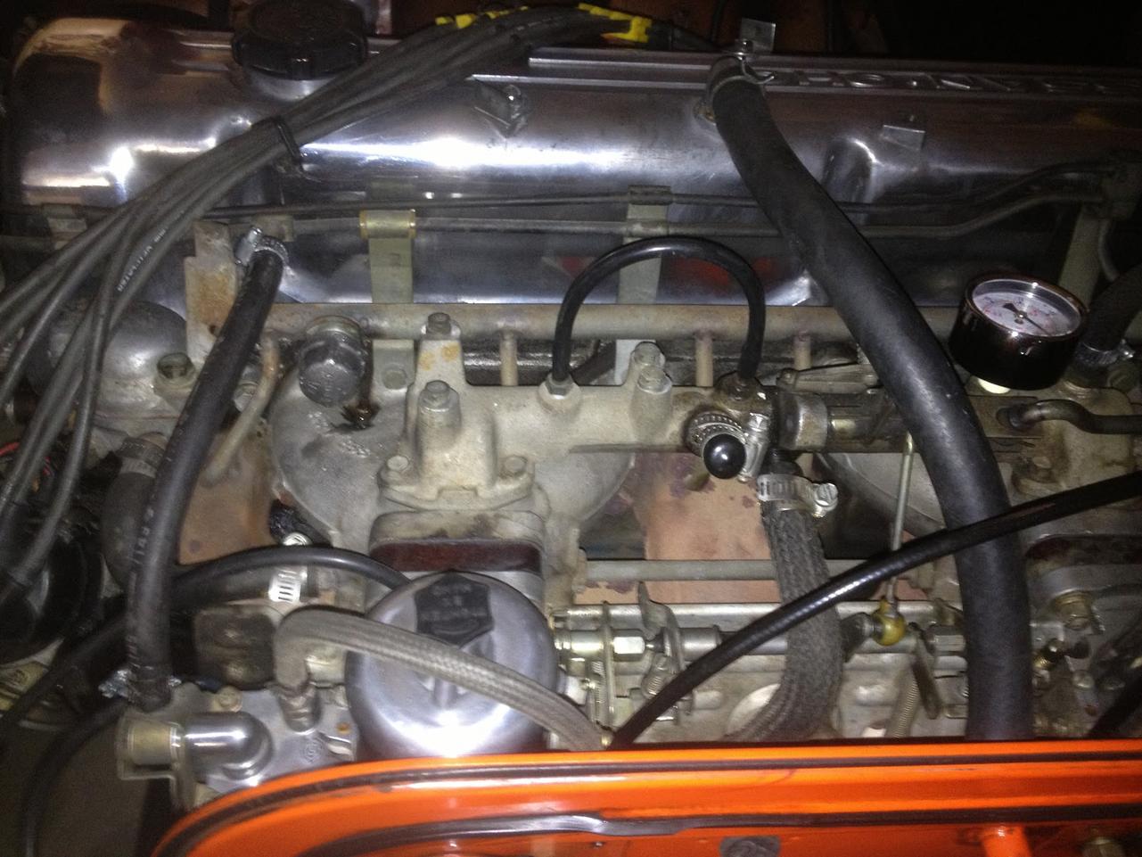

Weird dysfunctional SU carb issue, rebuilt and floats reset going on 8 times now.....
definitely running rich at idle....any chance the SMOG equipment you have installed is causing a lean condition below a certain RPM?
The smog stuff is actually unhooked at the source, only using blocked tubes to seal off any leaks, I haven't gotten around to making the blockoff plates for everything yet, as this current issue is draining every bit of mental capacity I can put towards the car LOL. I'll get some nipples to cover all the spots, or if you think maybe the parts are internally broken and hemorraghing through to the exterior, like a vac leak thru the housings.
Seems like something isn't flowing as it should. Here's what I ended up doing temporarily. On the air galley, a black-pipe cap fits perfectly.
