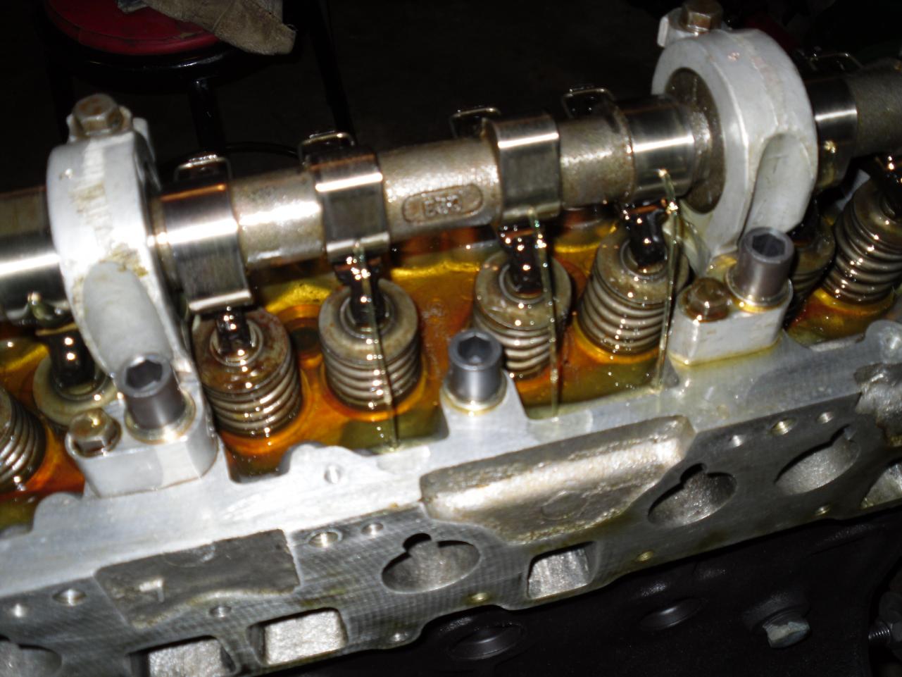

June 25, 201312 yr comment_426309 Turbo oil pump spun with a Dewalt cordless drill on low. Love that high flow oil pump even better now! Link to comment https://www.classiczcars.com/forums/topic/46829-camshaft-help-needed/?&page=2#findComment-426309 Share on other sites More sharing options...
