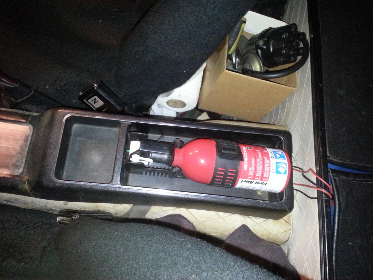

April 26, 201312 yr comment_421655 That's right. Any fire extinguisher that's bigger than a 1 LB. unit ( a 5AB) will probably not fit under the seat, and you should have a minimum of a 2LB (or 10 AB) unit.If anyone can post a picture of how they store or mount the fire extinguisher in the vehicle, such as mounted to the shock tower, that would be appreciated and meaningful. Link to comment https://www.classiczcars.com/forums/topic/46352-fire-extinguishers/?&page=2#findComment-421655 Share on other sites More sharing options...

June 6, 201311 yr comment_425059 my solution Link to comment https://www.classiczcars.com/forums/topic/46352-fire-extinguishers/?&page=2#findComment-425059 Share on other sites More sharing options...
