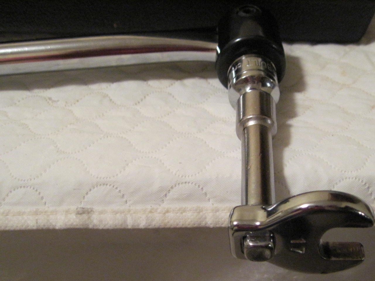

May 3, 201311 yr Author comment_422372 My biggest recommendation to anyone doing a valve adjustment for the first time, get this tool. It made the difference between an impossible job (I couldn't muscle the locking nuts loose with a regular wrench! Seriously??) and a highly pleasant job. The breaker bar was so long the handle was up over the fenders, so nothing under the hood could get in the way. Super-easy! Now that I've done them already and don't have bolts tightened by King Kong, I can do them again with just a regular 17mm wrench. 1/2" breaker bar 3/8" adapter 3/8" extension 17 mm crows foot Link to comment https://www.classiczcars.com/forums/topic/46257-compression-test-questions/?&page=3#findComment-422372 Share on other sites More sharing options...
May 3, 201311 yr comment_422383 I had to grind the sides of my 17 mm crows foot down quite a bit. Seems like it was hitting up against the next locking nut on #1.Jenny's happy, we're all happy. Link to comment https://www.classiczcars.com/forums/topic/46257-compression-test-questions/?&page=3#findComment-422383 Share on other sites More sharing options...
May 3, 201311 yr comment_422397 I use two different 17mm wrenches when I do my valves, a nice long one that I can tap the end of with a mallet to loosen 'em, and a little short thin jawed 1970s honda motorcycle toolkit wrench that fits in real nicely for adjusting and tightening. Link to comment https://www.classiczcars.com/forums/topic/46257-compression-test-questions/?&page=3#findComment-422397 Share on other sites More sharing options...

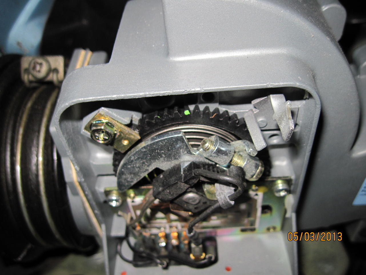

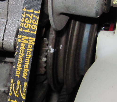

May 4, 201311 yr Author comment_422466 Update! Did a 2nd compression test today (cold motor again) after the valve adjustment and here are the results: Compression (psi) Cyl 1: 146 Cyl 2: 134 (144 with a few squirts of oil) Cyl 3: 153 Cyl 4: 146 Cyl 5: 145 Cyl 6: 141 What to do about #2? Is a gain of 10psi expected/normal after a few squirts of oil on a motor with 140k? Is it likely its compression rises with the others on a warm motor and gets closer to the others? Should I just keep driving it and letting the Sea Foam in the gas keep cleaning things up? Should I try loosening lash on #2 another .0005"? After the compression test, I adjusted the AFM one tooth richer. Good news is, the occasional hesitation I experienced on last night's drive was gone. Vacuum is now tested at 17-18 mm Hg warmed up. Bad news is, I have some horrible noise coming from the front driver's side (near the AFM or ignition coil). I heard it very loud climbing a hill in 2nd gear on the way out and so I turned around right away and nursed the car back. I thought it might be the motor...maybe cylinder #2 was complaining because of the oil I squirted in...maybe I forgot to do something or pick a tool up off the car....I stopped the car and just revved the engine and I heard the noise but intermittently, it was hit and miss. When I got back, opened the hood and looked in, the AFM front cover had fallen off completely and was just sitting there. I thought it might be vibration and that front cover causing the noise (is there vacuum present around the potentiometer where this cover should be sealed?). Do ignition coils make noises when they start to go bad? Do AFMs rattle if maybe the wheel isn't straight after an adjustment or something? I'll include a vid clip of the awful noise, I really hope someone can offer wisdom on what it might be! Thanks a million you guys!!! <embed width="600" height="361" type="application/x-shockwave-flash" allowfullscreen="true" allowscriptaccess="always" wmode="transparent" src="http://static.photobucket.com/player.swf?file=http://vid81.photobucket.com/albums/j219/amiamelodramatist/isis_garden/photos/2013-05-03_zps5eafb148.mp4"> Link to comment https://www.classiczcars.com/forums/topic/46257-compression-test-questions/?&page=3#findComment-422466 Share on other sites More sharing options...
