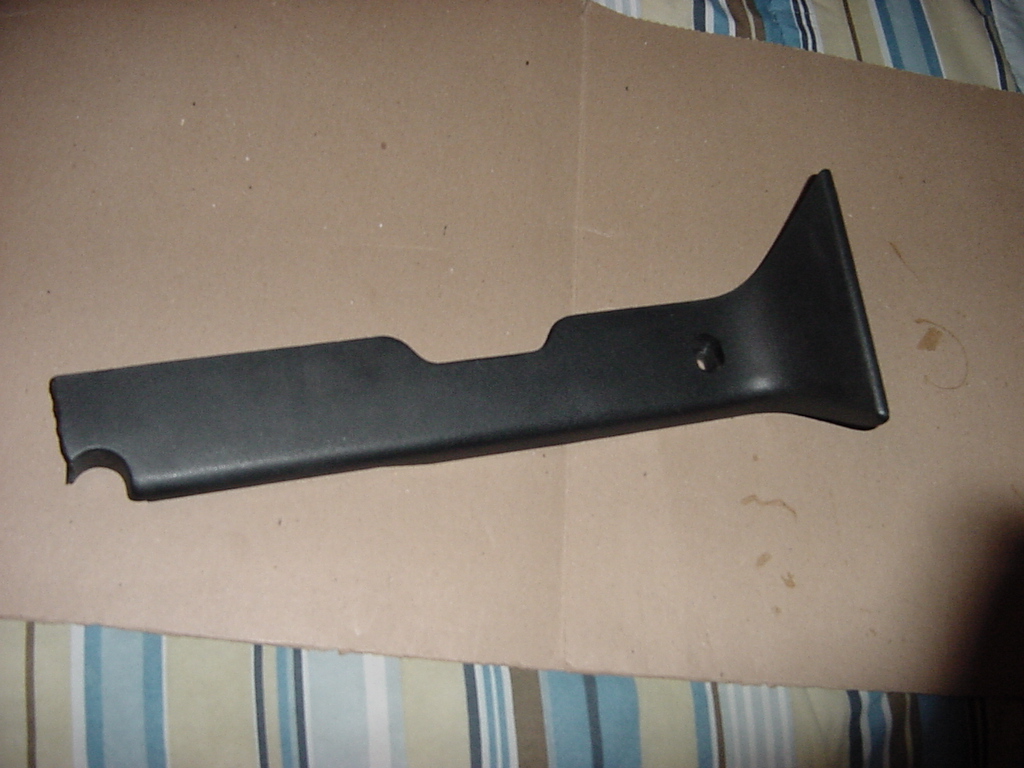

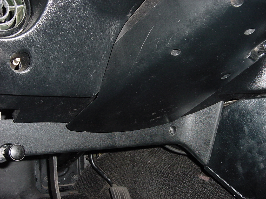

On the later years (mine is a '78) there is a lower cover that goes along the bottom edge on both sides. The first picture is the left lower cover, except the left end was broken off, and the second picture is the same cover when installed. There is a similar cover for the right side. Its function is to obscure your view so you don't see the wiring and such below- from a normal viewing angle.
'If you are asking if there is some kind of kickpanel for the side where the fusebox is; there is none, AFAICT, but you are welcome to fabricate one, and I'll buy a copy.
