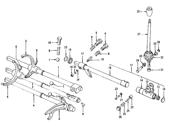

Is it possible to repair/replace the Spring Return(#24) and Spring Reverse Check (#25) while the transmission is still attached to the engine & its mounted in the car? My problem is that there is no spring rebound when I pull the shifter out of 1st/2nd (does not return to the center) and its very very difficult to move the shifter to the right to get it into reverse. Once Its in reverse I can move it back & forth freely until I let the car sit for a while. I'm thinking these two springs are all gummed up or something. Has anyone had any experience with this? If I need to pull the transmission & pull it appart, I'm probably just going to find a 5spd to put in & rebuild the 5spd at some point. Any thoughts would be appreciated!

My car has the exact same problem, won't return to center when I pull out of 5th making it too easy to tap reverse. What is a ring spanner? I imagine I will have to use a lot of force to get that spring back in there when I put a new one in, is that why I need a ring spanner? Just as information I notice the drawing above shows two springs, I recently was looking at this issue and noticed a similar drawing showing only one spring, maybe that was for a 280ZX transmission.

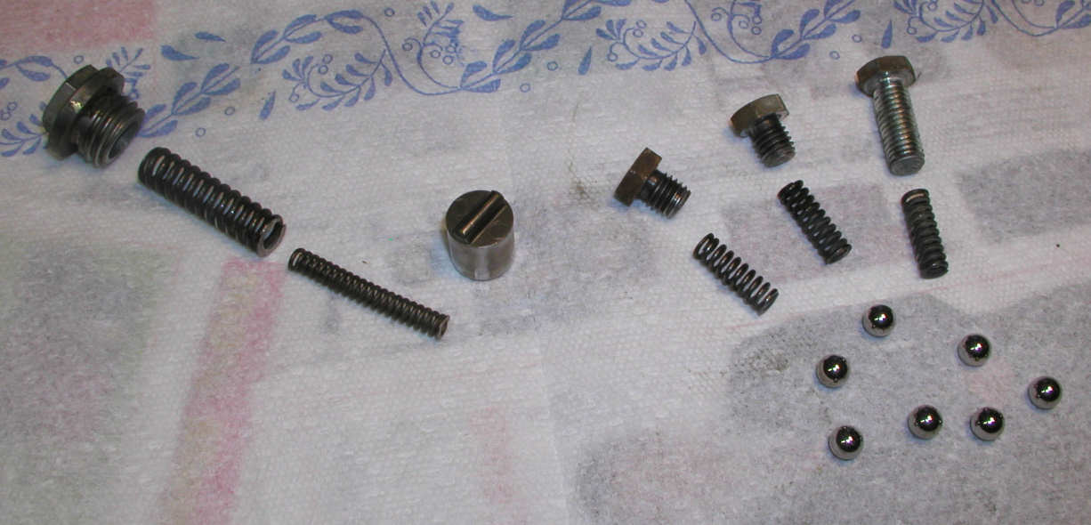

I've been looking around and I believe this is what the springs will look like when they come out...
[ATTACH=CONFIG]61216[/ATTACH]
The four items to the left are for the reverse lock out. They are what you will find in your transmission.
The other parts on the right are for the interlock and neutral detent. They are located in the iron plate where the front and rear section bolt toegether.
Chas

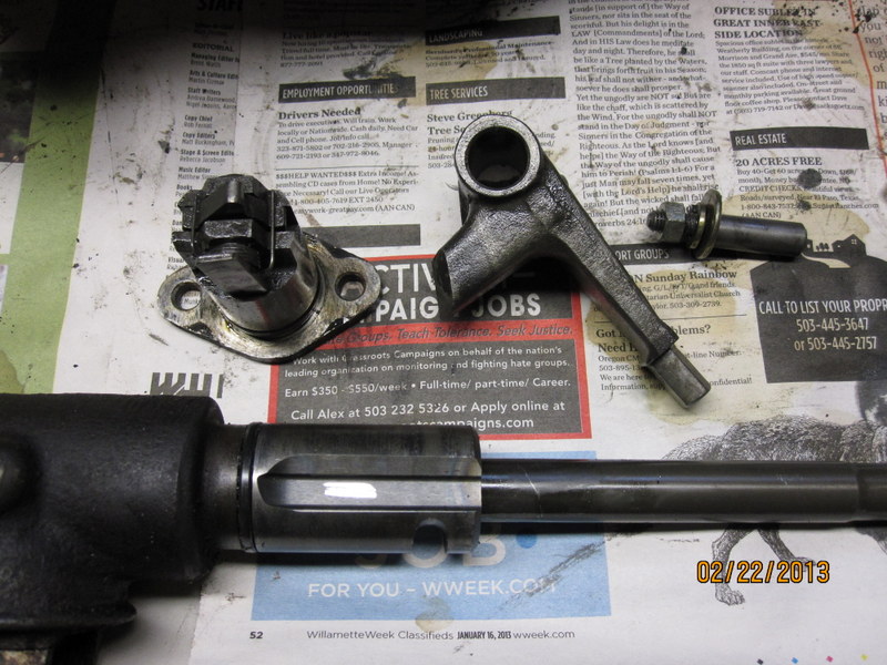

That picture jogs my memory. The projection on the metal slug fits in to a slot I believe. It has to ride up a ramp, going either way, against the spring pressure to move the lever over from center to either the 1-2 slot or the 3-4 slot. I think it has to work even harder (move higher) to get to 5-R slot. I think that I realized at the time that it didn't really stop the lever from going from 5th to Reverse, it only centered the lever from side to side. As EuroDat says, it's a good chance that's your problem, since that's the weakness you described. As you can see it's metal. I might have used one of those magnetic pickup tools that looks like an antenna to get the slug out of the hole. You'd probably have to break it to fit it into the tunnel space.
I might have that backward or just wrong, but I looked at those parts and couldn't see any way to to make Reverse more difficult to engage, from 5th. The 5th to Reverse action is controlled by the balls and springs in the adapter plate, as Nissan calls it, the iron plate between front and back. I think that the 71C has a special lever gizmo that locks out Reverse.
Fun stuff, the fine details of these transmissions.

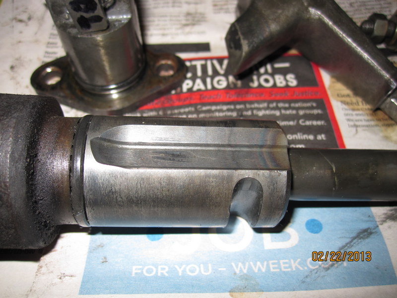

I took the striking lever out of a tail shaft housing that I had from a blown up 5 speed I used for a 71C bellhousing conversion. It's from an 81-83 ZX so it has an extra "reverse check sleeve" that the earlier 5 speeds don't have (shown in the MT chapter of the FSM). Took a picture of the "valley" that the centering plunger rides in. You can see that the ramp up to the 5-R position is steeper than the 1-2 position. I had already removed the plunger so it's not in the picture but the striking lever, its locking in and the reverse check sleeve are shown.

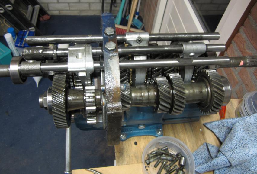

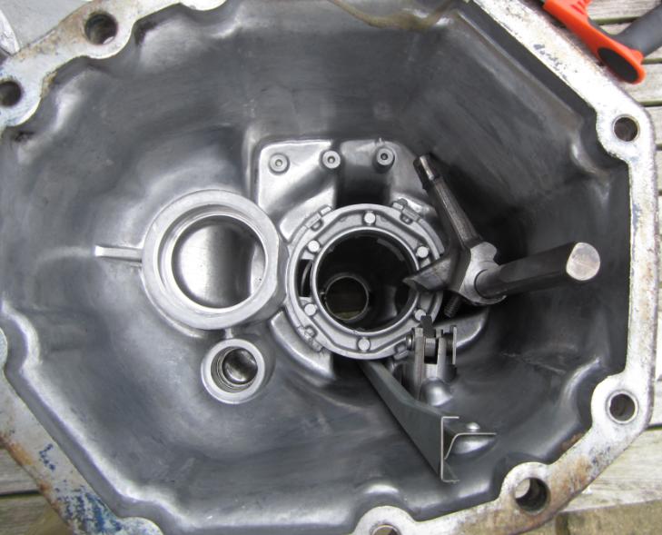

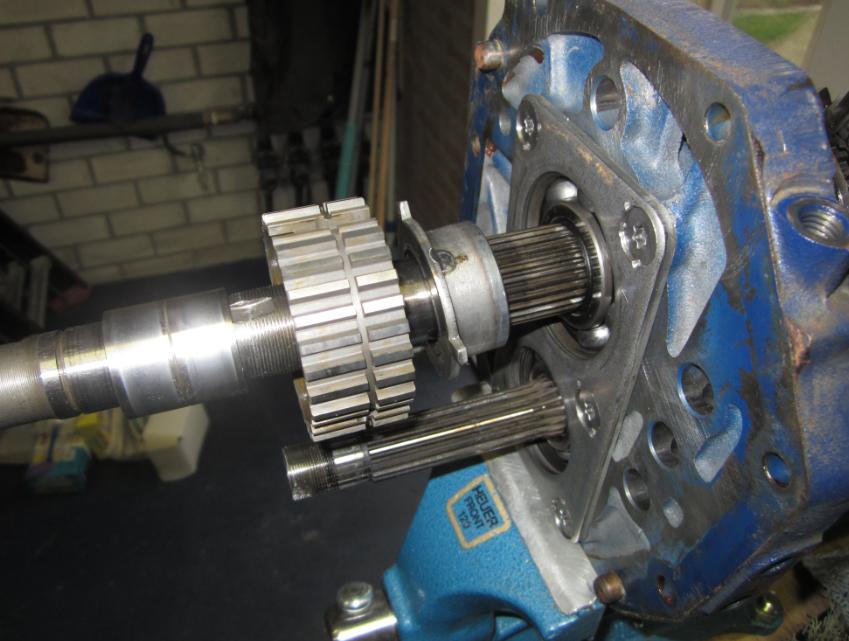

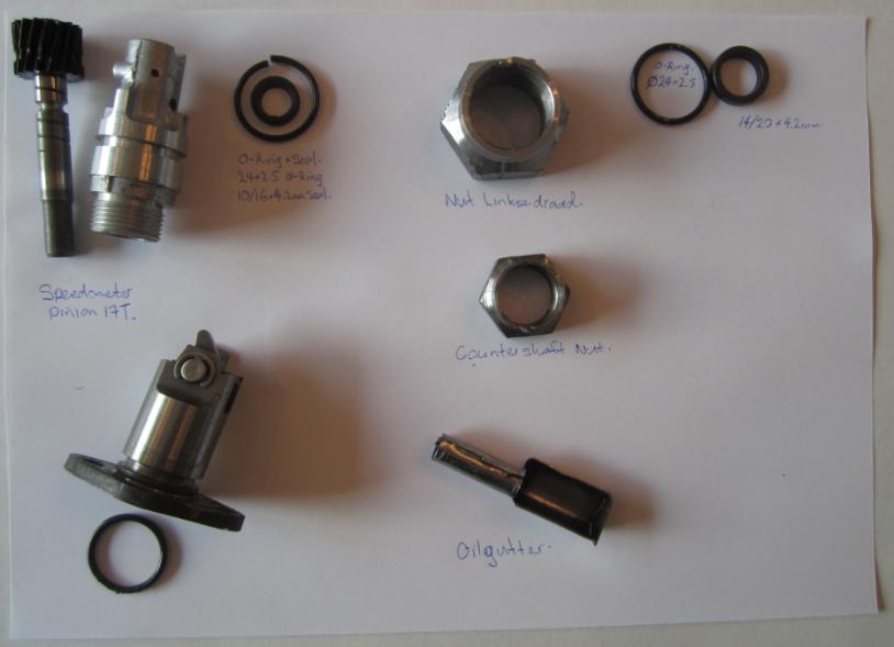

I searched through my photos, but couldnt find much on the old transmission. My 280Z also had one out of a 280ZX. It was one of those el-cheapo recon jobs the PO had fitted and was probably not much better than the original. They just replaced the standard bearings and a couple of seals.
I was planning to rebuild but after pulling it apart, decided to go for a 71C. Turned into one of those "While Im at it projects"
In the photo Trans3 you can see the detent plunger with spring and 19mm cap nut in the container. Trans3 shows the 5th gear bearing sleeve, but the pitting doesn't show up very well. It was whinning and clunking in every gear but 4th.
My advice: Be carefull buying reconditioned transmissions. Unless you know its history. You could get something that will only last 20 - 30k miles.
