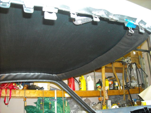

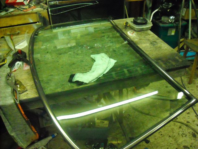

April 12, 201312 yr Author comment_420376 I think I have found something that is worst than sanding, gluing vinyl. Just finished the headliner and header, what a hateful job! You get like one and half chances to get it right. Nerve wracking. And you can see from the wrinkles one the DS header I didn't get it right, hopefully the heat of summer will relax that a bit. Got the rubber seal and chrome strips on the hatch window and windshield without too much trouble. Tried twice to get the hatch glass installed and failed, I thought if I can't handle the back glass I'll never manage the front but it went in about 20 min. Once the windshield is in the dash goes in and as soon as the fuel pump switch (oil pressure safety switch) arrives in the mail I can start the engine! Link to comment https://www.classiczcars.com/forums/topic/45430-240z-rebuild-restoration-right-down-to-the-shell/?&page=9#findComment-420376 Share on other sites More sharing options...
April 13, 201312 yr comment_420422 Hi Chris, You are not alone when you say this work is frustrating. The last head liner I did took me so much time and I was nether completly satisfied with it.Your project is coming along nicely though. It will give you a good feeling when you start the engine for the first time.Your at a point where most of us take years to get to, and some give up before they get there. You spent one winter doing a complete resto and I just did the brakes and PU bushings. Just amazing.Chas Link to comment https://www.classiczcars.com/forums/topic/45430-240z-rebuild-restoration-right-down-to-the-shell/?&page=9#findComment-420422 Share on other sites More sharing options...

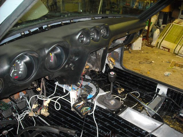

April 13, 201312 yr comment_420444 For your firewall insulation, did you just use the Murder Mat, or did you put another layer of insulation on top of that? Link to comment https://www.classiczcars.com/forums/topic/45430-240z-rebuild-restoration-right-down-to-the-shell/?&page=9#findComment-420444 Share on other sites More sharing options...
April 13, 201312 yr Author comment_420447 For your firewall insulation, did you just use the Murder Mat, or did you put another layer of insulation on top of that?I coated the inside of the firewall and the whole cab with my version of Lizard Skin, then Murder Mat then the stock firewall insulation. Link to comment https://www.classiczcars.com/forums/topic/45430-240z-rebuild-restoration-right-down-to-the-shell/?&page=9#findComment-420447 Share on other sites More sharing options...

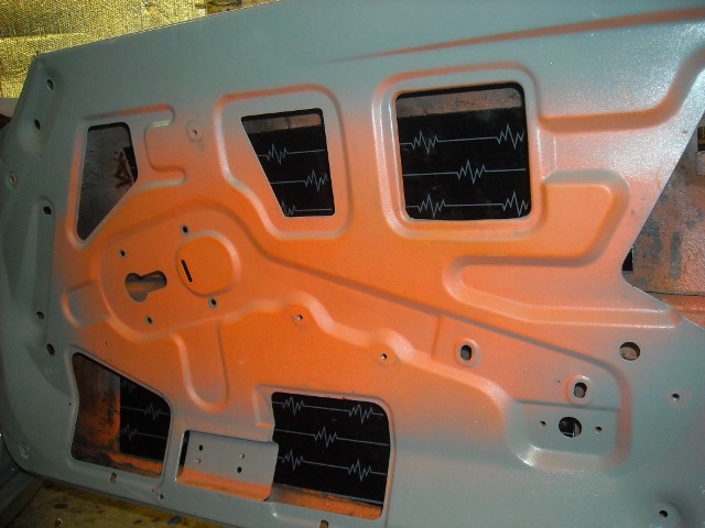

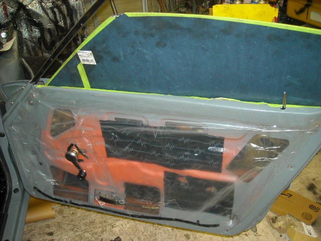

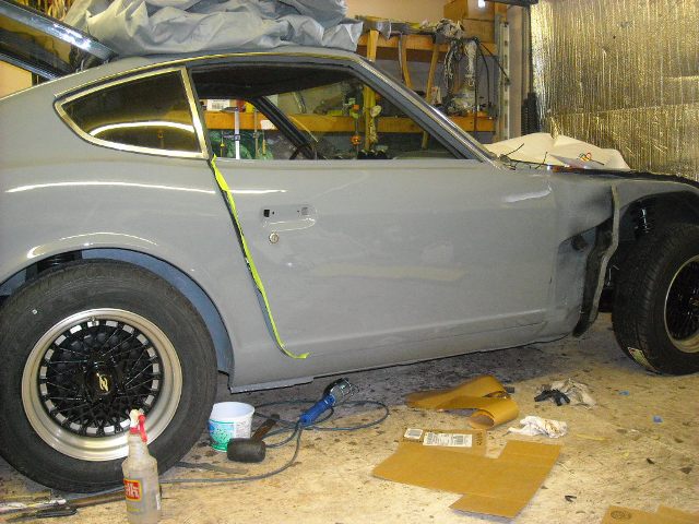

April 14, 201312 yr Author comment_420556 Got the passenger door on, glass in Had enough left of the Murder Mat to do the inside of the doors and so the interior door panels never have to be replaced again because of rain I lined it with plastic the way modern cars do. The black paper on the inside of the glass was to protect the tinting layer during installation. I really wanted to put the panel on and finish it off but I think I should wait until the carpets and seats are in so nothing scratches the new panels. Somewhere on this forum I read about the little trick of wrapping the inner and outer door handle linkages in vinyl or rubber tubing to quiet them down while driving and when closing the door. When I actually slammed the door after all the fitting was done it was a nice thud, solid sound. Chas, even though we just had 3 days of ice pellets and snow, spring is here in a big way and that is really pushing me to get the car road worthy. I tried for a third time to get the hatch glass in with no luck, I don't know what I'm doing wrong, now I'm just going to leave it to the old guy at the local auto glass place. He'll have it in ten min. flat Link to comment https://www.classiczcars.com/forums/topic/45430-240z-rebuild-restoration-right-down-to-the-shell/?&page=9#findComment-420556 Share on other sites More sharing options...
