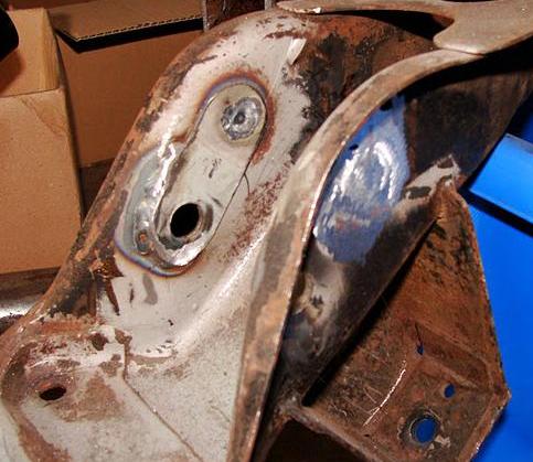

June 6, 201312 yr Author comment_425001 Update time: Since I was painting and everything was off on the front I decided to take an extra step and start removing both fenders so I can lessen the eyesore of the damage and rust. On to the pictures.. Today I managed to do the passenger side. After some brushing with the drill since the home electrical circuit can't handle my die grinder. Erhm... I have a feeling this is not suppose to be. The infamous dogleg.. Damage... this is another consequence cause by hit. Looking directly from below.. The day ended after I sprayed it with rust primer. This is definitely not going to be a show car result since I have limited supplies but atleast the car will end up being all one color. More to come tomorrow... Link to comment https://www.classiczcars.com/forums/topic/45374-homeboyxs-280z-thread/?&page=8#findComment-425001 Share on other sites More sharing options...
