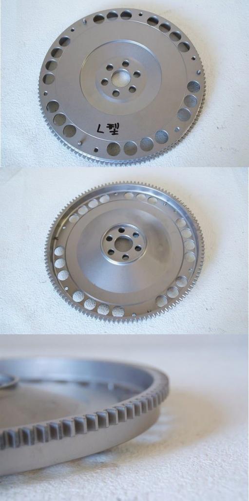

Interesting to know how heavy the flywheel is? I take it the photos are first removing the back section and then complete with holes.
My flywheel has 18 holes against the 21 holes in the photo and ended up about 7.8kg. It started at just a fraction over 10kg.

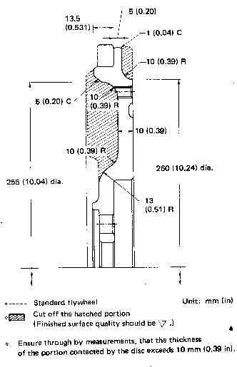

Hey Blue, Thanks for the diagram. I need to do this to my race car's flywheel over winter. Do you have any idea what the weight is of the one in the sketch? I assume that the pics in post #4 do not go with the sketch in post #3, so it would be nice to know how much is removed.

A little info on Blues photo's. Its an interesting drawing. Have not seen a Z flywheel lightened like that. They have taken metal off almost every unused surface.
The flywheel with the holes is a Kameari chromoly steel flywheel (based on cs1.0619 steel alloy). Its around 4.3kg and very thin due to the high grade metal used to make it. Even so thin as they are they dont easly get heat spots. Again the metal used distributes the heat better. If your driving on the street its no option.
You can't get a standard flywheel down to this weight because the metal is just not strong enough and the flywheel would fly apart. Flex could also be a problem when engaging the clutch and cause fatigue.
The left photo is a machine shop job, but its not quite as light as the drawing. The drawing looks like it would be another 25 to 35% less weight again.
