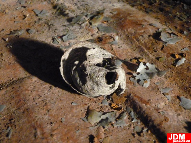

3) while cleaning the car a bit i found this wasp's nest inside the drivers door :D
