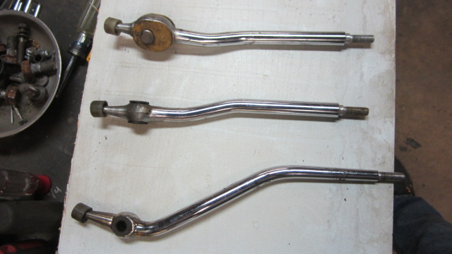

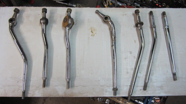

Here are the pictures of my selection.

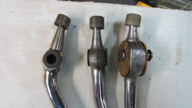

The group of three on the left are the most common. I believe the first or second are Z, the right one of the three is a zx variant with a spring loaded center. The ones on the right side are all "A" type shifters. Others feel free to chime in with further identifying remarks.
Let me know. Yours for the price of postage.
Jim

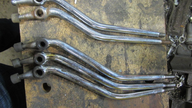

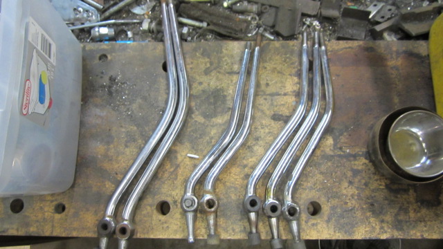

So after digging through the shifters trying to find a suitable candidate, and comparing a bit more closely, it seems there are no less than three variations on the ones with a pronounced "S" curve.
I'm pretty sure the group of three match the front one in the center picture above.
I have NO idea what those extra longs are for or from.... Anyone need then for joke? I have a Hurst shifter handle that would look right on home on one of them!! LOL
