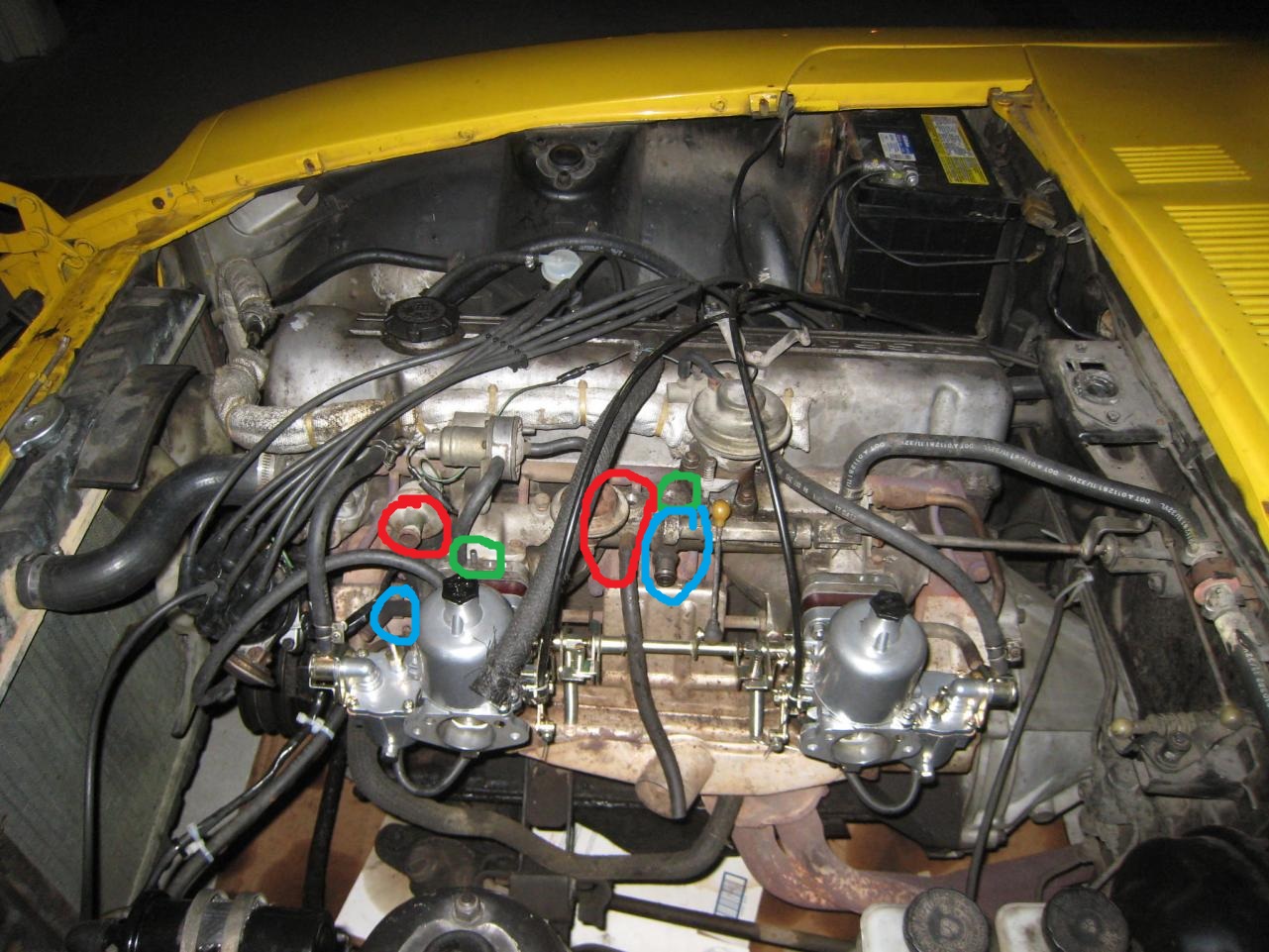

Guys, i'm having issue tuning the carbs. I hooked up the antibackfire(green), plugged misc. holes(red), and connected the pcv(blue). The carbs won't run well without running rich or run at all. The mixture adjusting nut has to run really rich, dont know what to do. Help guys?
I suspect you've got a vacuum leak somewhere and you are running way lean. Are you sure you didn't miss a vacuum port somewhere?

okay so I'm getting a vacuum leak somewhere. I know theres a slight leak in the throttle butterfly but would that really cause this much of a problem? idling at 5-7 turns of the mixture nut. Ill post a video when I work on it again tomorrow. also, I noticed the linkage bar/balance screw that shuts the car off smoothly is too short, is that a common problem? I'll try to take a pic tomorrow as well.
