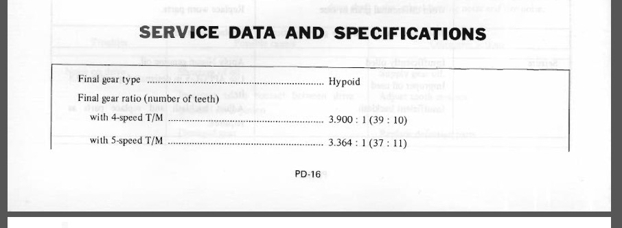

The 1972 240Z FSM, PD chapter, has the ratios the other way around from the Zhome site. Kind of confusing.
As stated above, a stock 240 with a manual tranny should have a 3.36 diff. With the gearing of a 5 speed (certainly for an '83 5 speed) you will have very tall gearing. This means that you can cruize at 85 mph on the highway at 2,300 rpm but getting off the line will be very sluggish.
To confirm, either the 72 FSM is wrong or the zhome numbers are wrong for 1972. The FSM says the 4 speed is 3.9, zhome says the 4 speed is 3.36.
I've always heard that 3.36 is the stock 240Z R180 ratio, but the FSM says otherwise.
The tranny and diff (3:90) were made for each other and are a very nice combo. If you have room take the engine as well.
