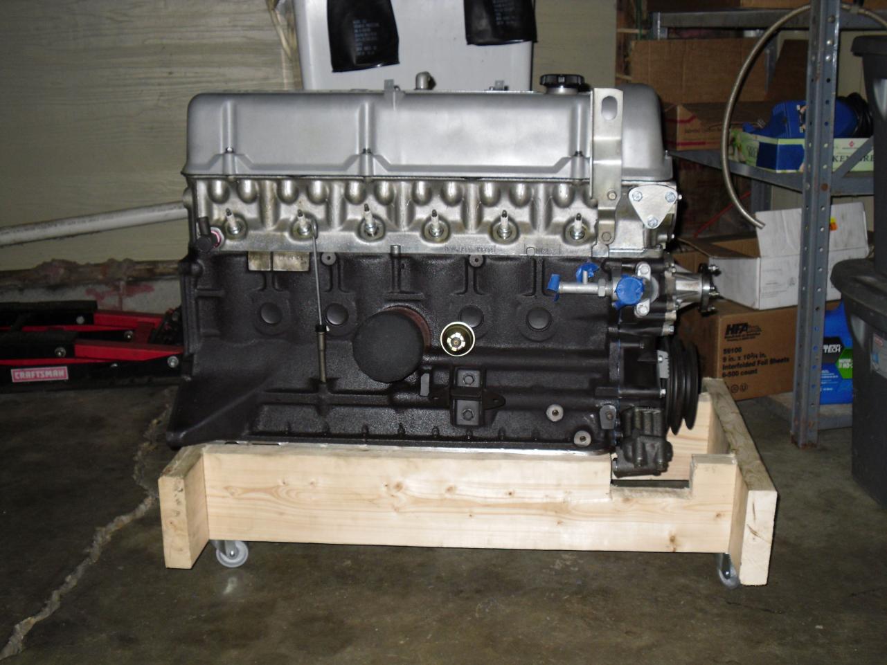

Take a bunch of pictures before you tear into it. Go to your local building supply and get some lacquer thinner and some small wire brushes, brass for the pistons, they're in the welding section and look like a toothbrush. You'll need a roll of painters tape and a Sharpie for labeling things as well as a box of zip-lock baggies for small parts. I left the bolts in the part and put a small wire on the backside to hold them in place or a paperclip. Put your stuff in boxes and write what's in the box on the boxes, you can keep them in the hatch. Clean and clean then clean some more, you'll be glad you did. Zedyones thread on his rebuild has the dimensions for a wooden crate you can build for your motors. I built one out of 2x6's but I think 1x6 would do and put wheels on the bottoms. I had never built one of these engines and Tom Monroe's "How to rebuild your L series" book from amazon.com was the best $20 I spent. Step by step instructions with lots of pictures.
