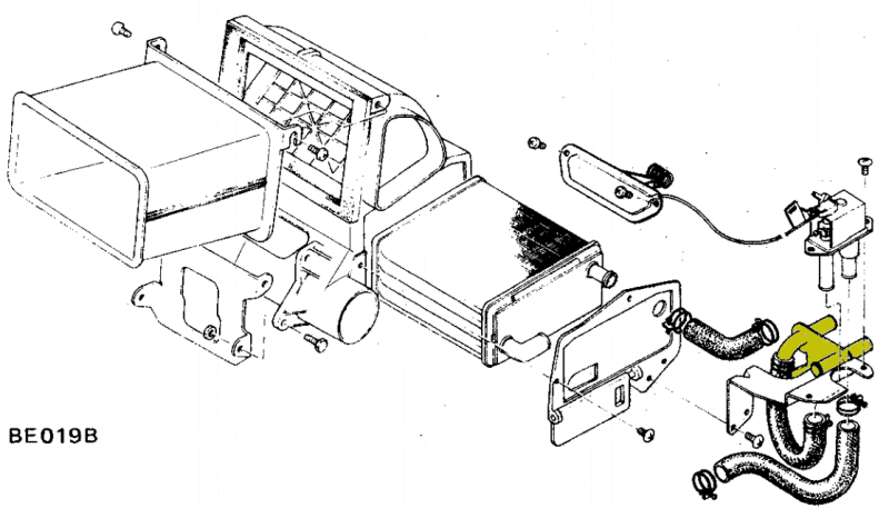

What is the purpose of the capillary tube on the water **** valve for the heater system? The car in question is a 77 without air conditioning.
They reference the capillary on page BE-51 (Body Electrical) section of the 77 FSM. They talk about being careful not to damage it, but I cannot find any description of why it exists in the first place.
Some kind of attempt at feedback to stabilize the output air temp in the face of changing heater core temperatures?
It's more of an "access panel" than a door. It's screwed into place and doesn't move once installed. They coil the capillary up and run it to a little access panel screwed to the heater box downstream of the heater core. In other words, the coiled portion of the capillary sits in the air stream after the air has gone through the heater core.
Best pic I could find is from http://www.zparts.com/zptech.html:
They are clearly sensing the temperature of the air after it has been heated, but the question is... Why? Are they adjusting the opening and closing of the valve with the pressure from the capillary?

I removed my water **** from my car and took a good look at the design. Based on that investigation, I'm going to change my guess a little...
I now theorize that it is an over-temperature prevention device. The reason I say that is because it appears that the device can only reduce the amount of water flowing through the valve, not increase it.
I'm guessing that it operates like the thermostat on the cooling system... The material inside the tube expands when it gets hot and pushes on a lever inside the valve which closes the valve. The hotter it gets, the more it presses down on the lever, and the more the valve closes.
All that said, I tried to test it by heating the capillary and valve with a hair dryer, and it didn't do anything at all. So, either I'm completely wrong, didn't get it hot enough to hit the threshold temp, or mine is simply broken.
Sure seems like an unnecessary piece of over-engineering...

I took the capillary device off the rest of the valve today and added heat again. Now that it doesn't have the pressure of the valve's spring pressing against the little plunger tip, the tip did extend a little when I heated the coil. However, it was compressible back with finger force. Also, when I was done, there was a tiny bit of some kind of liquid seeping out around the plunger tip. Not much... Only seen under magnification, but there was something coming out.
I stand by the theory that it's an upper-temp limiting device, and I believe it is supposed to be filled with some kind of liquid. I suspect some of my liquid has leaked out over the years and the resulting bubble is compressible which renders the device useless in application.

I think that you're right about its purpose as a control device. The idea is probably for BTU or calorie control, limiting flow as temperature (heat content) increases, so that you don't have to move the heat control lever as the engine heats up. The concept probably looked great on paper.
Just searched the web:
Some heater control valves are "thermostatically controlled" with a capillary tube that extends into the heater air outlet. The capillary tube reacts to changes in the heater's output. This regulates the opening and closing of the control valve to maintain a more consistent level of heater performance.
