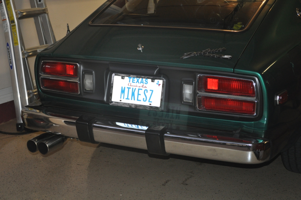

I used a dual tip from Magnaflow. It is part number 35167. Here's a picture of it:

It was actually meant to be welded onto the muffler but I ended up using a band clamp as well as some aluminum tape to take up a little slack and it worked great. It protrudes a little further than I would like but I get no discoloring of my bumper and no exhaust fumes in the car at all.
I actually purchased one almost exactly like the one pictured in your first post and it turned out to be pretty rough and cheesy. That Magnaflow is made really well and polished up nicely. Here's a picture of it installed on my car:
Hope that helps.
