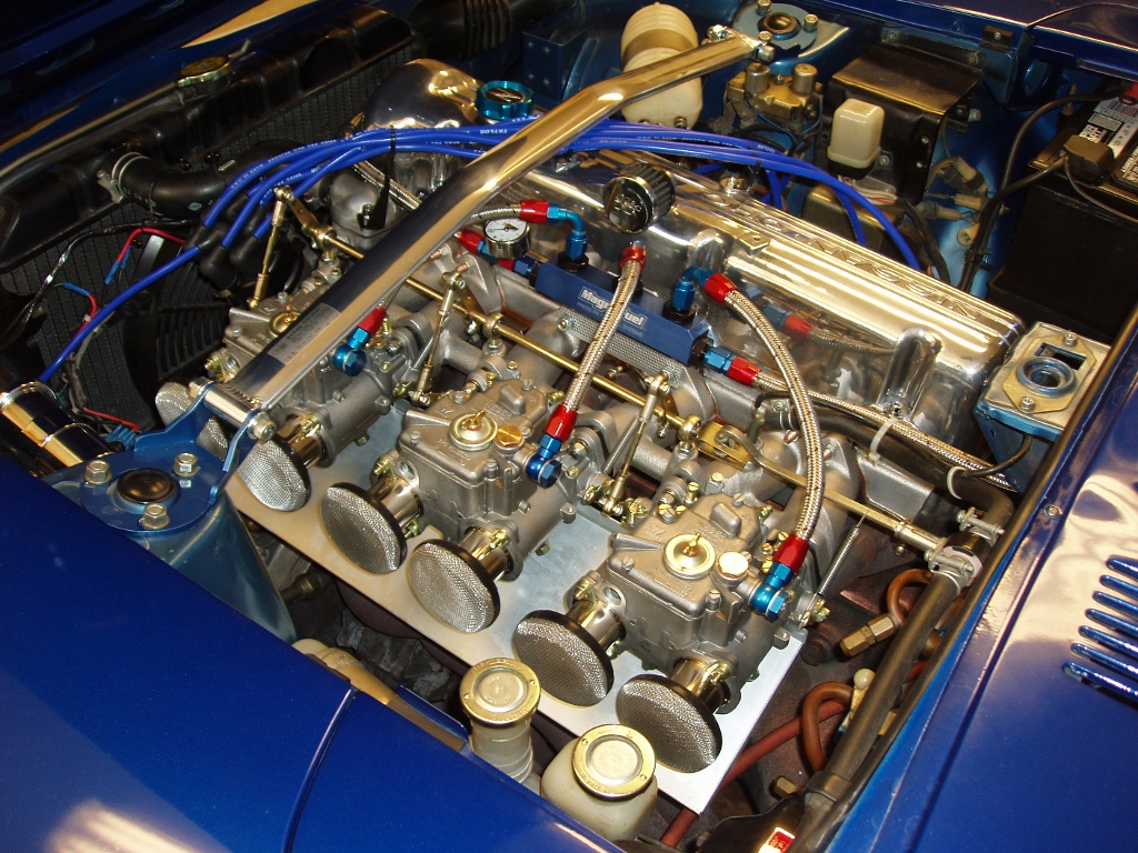

The Webers are 40 DCOE 151 with Main jet 130mm; Air corrector Jet 170; Emulsion tube F11; Idle jet 55 F9. The package came with Cannon intake and throttle linkage to fit to stock Z throttle, some basic rubber fuel hose and a few hose clamps. The first thing I had to do is swap the throttle levers to the correct side. The kit came with additional throttle levers which I later ended up using to connect the return springs. When buying the kit MSA didn’t even suggest new manifold gasket and studs and the fat washers, which they should have. I had a “well, duh” moment when I started ripping the old stuff out and ordered them.

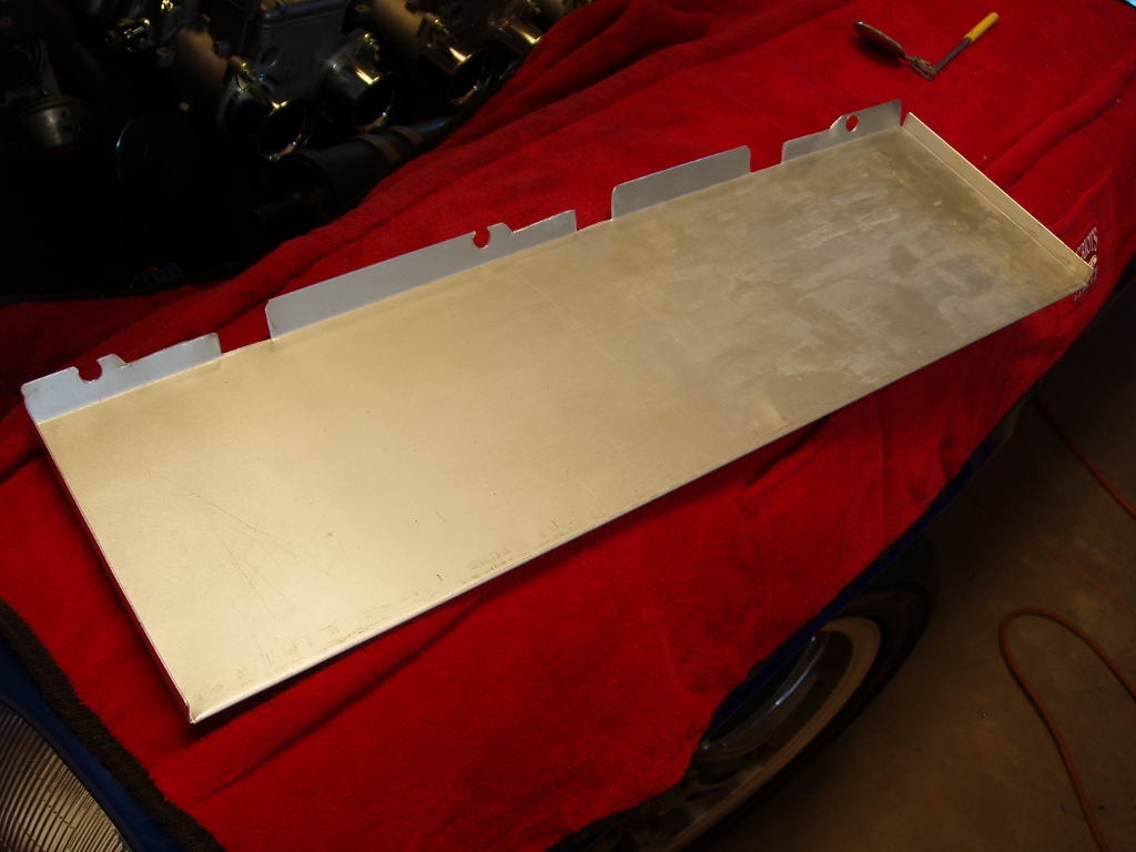

Heat Shield: I had a heat shield fabbed from aluminum: 21" x 6" with a 3/4" lip in the back bent at 120 degrees so the shield drops down from the carbs at a 30 degree angle. I drilled out one hole for each carb to mount and cut out sections for the other 3 mounting studs. Don't need 6 nuts holding on a piece of aluminum. Had to do a little hand cutting with tin snips and wire cutters to get it to fit under the carbs. Used Mike W's idea of the shield, a washer, spring washer and nut. With the shield angled down a bit I could fairly easily reach the washers and nuts by feel and tighten with a ratchet extension.

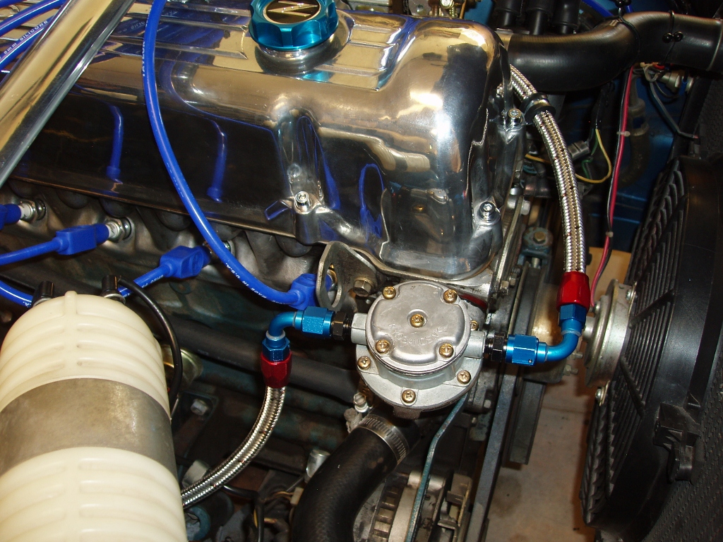

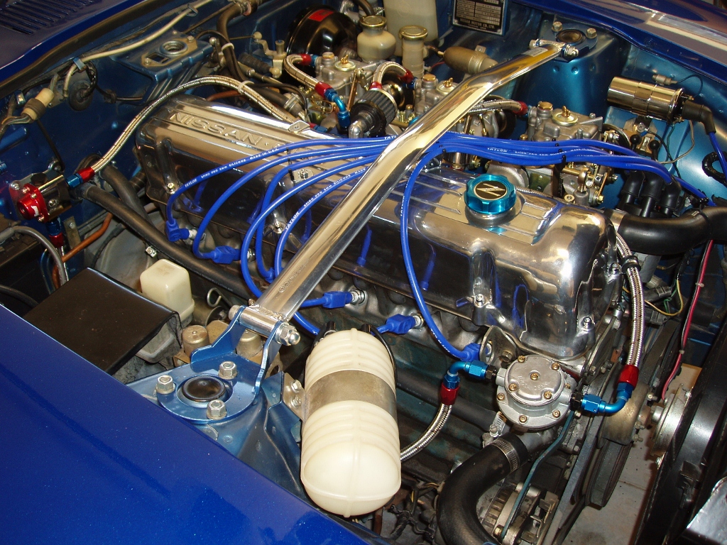

Fuel system: I wanted to use the OEM mechanical fuel pump with the stock electrical pump at the tank. The specs for the mechanical pump should be enough both in PSI and volume. I didn’t want to have to wire in a new electrical pump and emergency shut off. I purchased most of the 3/8” SS braided hose and Earl fittings from anplumbing.com. Everything is sized to a 6AN. Be prepared for sticker shock as many of the end fittings run from $8 to $21 each! The Magna Fuel Log I got from Summit as well as the fuel pressure gauge. Before ordering I drew out a diagram of what goes where and then made up a parts list…and checked it many times. The fittings are a classy red and blue aluminum and very high quality.
Cutting and installing the SS lines was very easy. Follow the tutorial video on the AN website which uses a sharp chisel and 5# sledge to cut the line. I got a 2 ½” wide chisel from Ace and sharpened it very sharp. Since I didn’t have block of aluminum for a cutting block I used an 8”x8” chunk of wood column I had and stood it on end on the concrete floor. Put the chisel on your mark; whack it a couple of times with the sledge and it cuts slicker than frog snot! Using a vise per the video to hold the fitting and a tiny screw driver to push errant SS fibers in is quick. Screwing on male fitting was easy. Each fitting end probably took only 5 minutes or so. Earls also has a connection for fitting to the 5/16” hard line fuel lines. Works exactly like your standard compression fittings in some of your house plumbing. Cutting the hard lines was tough because of tight space. You want a very straight section for the fitting to work. I used my tiny copper cutter which took a long time. I used a tiny round file to deburr the inside of the tube.

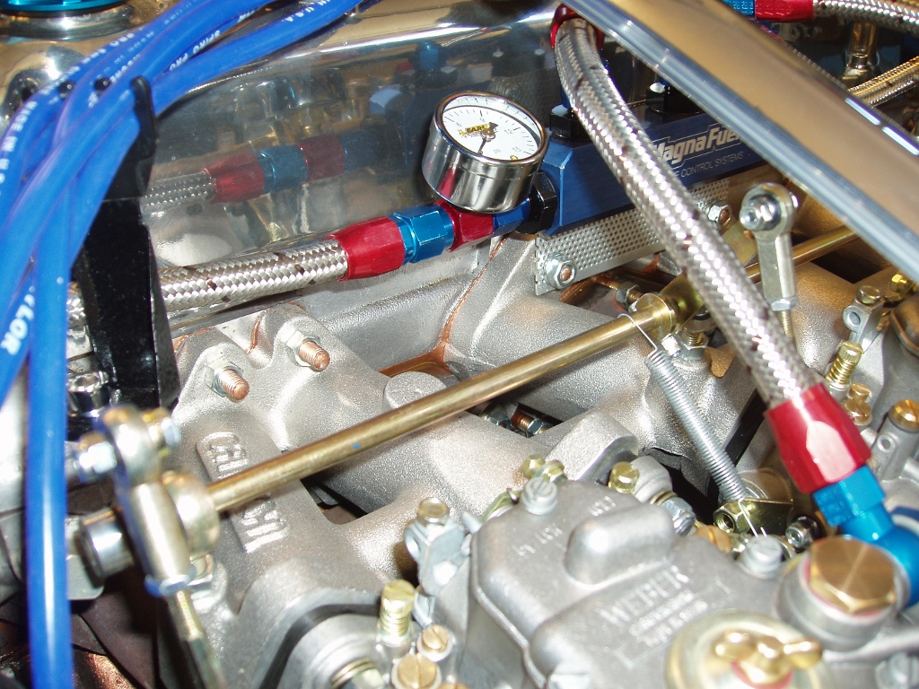

I fabbed a piece of sheet steel to bolt the fuel log above the intake manifold. Since I decided to use the fuel return line I installed the pressure gauge on the fire wall and ran the return into the stock hard line. Finding the right fittings to replace the stock in and out nipples on the fuel pump was tough. Since it was Japanese I assumed it was metric. After many attempts I finally got a 1/8” NPT thread to 6AN to work, though it was tight and I had to remove the pump from the engine work carefully to get it to thread. Perhaps there is a “metric” NPT…anyway no leaks.

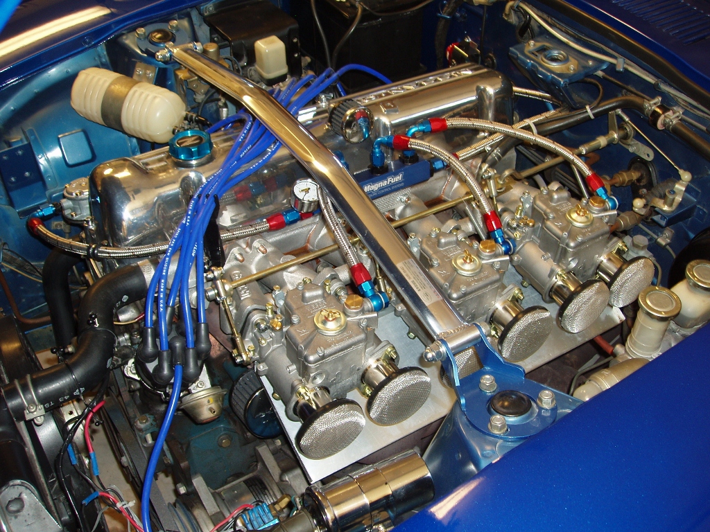

Fire ‘em up! After adjusting the throttle linkage for equal action on each carb and assure pedal hits bottom right before full throttle, I set the idle and mixture screws to initial settings per spec. After cranking a bit to get fuel flowing the babies fired up. Lots of fine tuning, balancing followed to get them basically tuned. The initial drive was awesome for throttle response and power. Definitely feels 30% increase in power/torque. The usual hesitation spots at 1800 and 2700 rpm as others experienced and eventually worked out. I don’t have an oxygen sensor so tuning is by balance gauge, sound and seat of pants. After a bit more tweaking I took it for a longer drive. At 70 mph when you punch it, you can feel the pull. Before returning home I tried a full throttle through the gears. At high rev third the engine started stalling out and worse in forth. No power so limped along the side of the highway for a bit and then it started running well again. Fuel starvation.
I never could get the fuel pressure gauge to register at all. I wondered if the fuel pump was worn out or perhaps the return line was too open (OEM had a restriction in the line). I assumed the pressure regulator would help manage the flow. I bought some more fittings from Earls and moved the pressure dial to right before the fuel log and plugged the fuel return at the log. Gauge now showed 4 ½ to 5 psi so fuel pump is putting out okay. I wanted pressure at 3+ psi to keep the Webers happy. Keeping the dial at the fuel log I reconnected the return line and was now only getting 2 psi at the carbs. No wonder fuel starvation. I tightened the pressure regulator screw in as far as I could and the PSI finally rose to 3psi. I retried the hard acceleration again and absolutely no problems, even after three consecutive runs.
Living at 4000 feet one would think I need leaner jets, but currently I’m about 90% there with tuning. I richened the idle mixture screws less than ¼ turn and seemed to get rid of the 1800 rpm lag. Viewing the progression holes I am pretty much right on where the throttle plates should be. I’ve added a third return spring as idle wants to return only to about 1500 rather than the 8-900 I tuned it for. I need a better source for springs as choices around here are slim.
