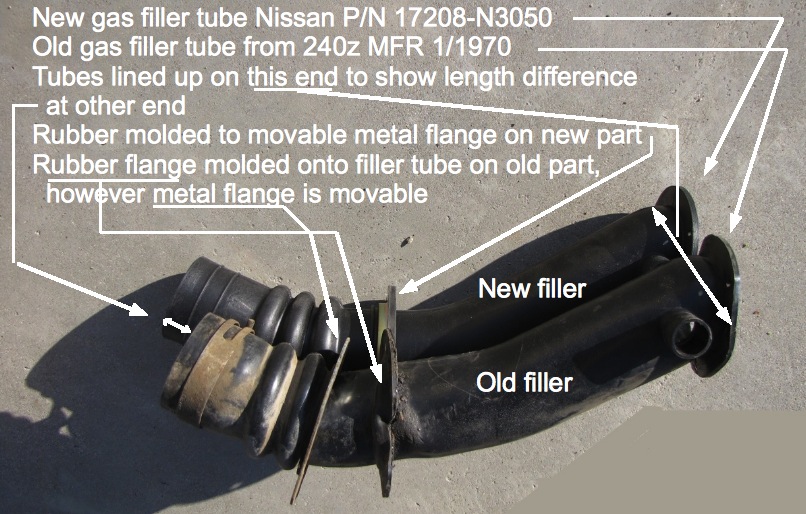

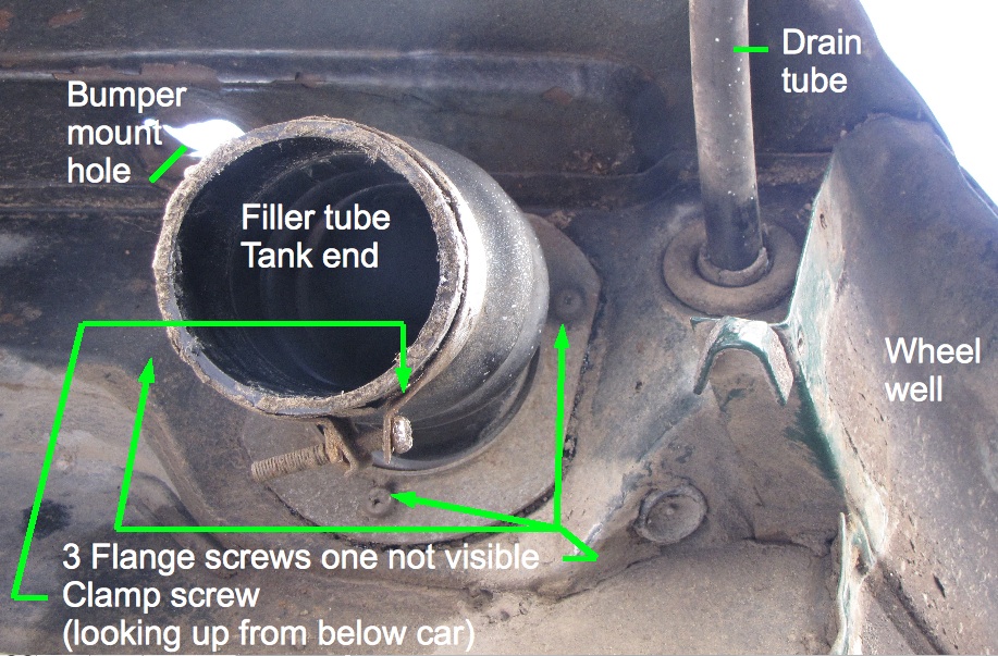

Posted May 17, 201213 yr comment_390315 Hi all, I pulled the gas tank on my 240 today to replace a leaky fuel vapor hose on top of the tank though I could not get the clamp screw on the filler hose on the tank to turn without springing back to the original position as I tried to turn it with vise grips. Also I could not remove the three screws holding the filler tube lower flange on with the tank in the way. This meant the filler tube was holding the tank to the car since this early 1970 model has the lower rubber flange molded to the filler tube. In direct violation of Murphy's law as I pulled on the tank it fell off of the filler tube where the tank clamp was solving the problem. I notice the early filler tubes are different apparently than on later model cars as the one on my car has the molded on lower rubber flange and the new filler tube I have has the lower rubber flange molded onto a metal flange that is slid over the filler tube making removal much easier I think. Was there some other way to get the filler tube off without cutting it? I wanted to save it as they don't seem all that cheap. Mike Hose comparison old to new View under car Edited May 17, 201213 yr by Mikes Z car Link to comment https://www.classiczcars.com/forums/topic/43244-filler-tube-removal-on-very-early-z-11970-with-molded-on-lower-flange/ Share on other sites More sharing options...

May 18, 201213 yr Author comment_390407 Carl, Sorry, I didn't mean to be unclear. I didn't have to cut the filler tube as the tank finally fell off of it. I was wondering if it hadn't fallen off if there was some other way of getting the tank off of the filler tube given that I couldn't get the screw to turn on the filler hose at the tank clamp and I couldn't get the 3 screws at the lower flange under the car to unscrew that hold the lower flange on because the tank was in the way so I couldn't get the vise grips on those 3 screws. The filler hose on my early 1970 car has the lower rubber flange molded into the filler hose so they are one piece meaning if I couldn't get those three screws out of the lower flange I couldn't drop the hose down to let the tank down for better access to the screws. The new replacement hose I have has the lower flange slid over the hose; that design would have allowed the tank to drop down even if I couldn't have gotten the lower 3 screws loose. I still am not sure if I am being clear enough.Mike Link to comment https://www.classiczcars.com/forums/topic/43244-filler-tube-removal-on-very-early-z-11970-with-molded-on-lower-flange/#findComment-390407 Share on other sites More sharing options...
