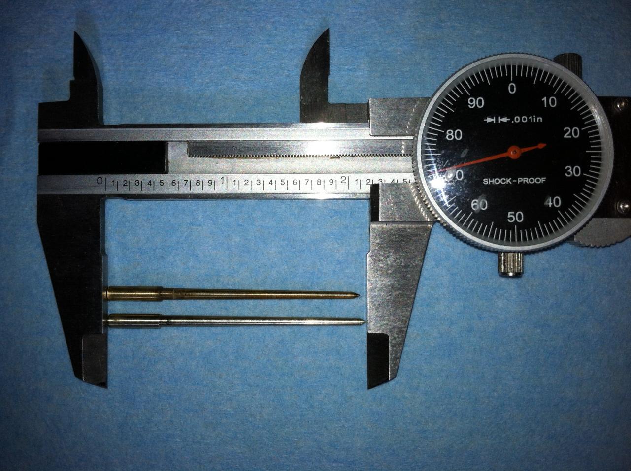

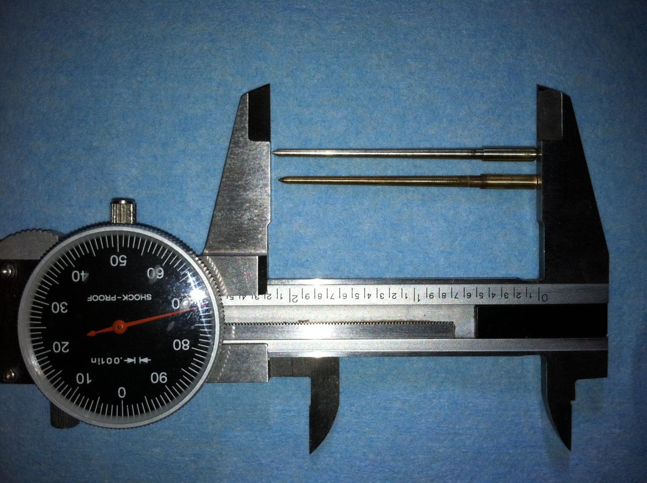

Hey, now that you don't need those carbs to run the car, how about that shot of the SM's and the N27's next to the ruler?

Thanks for the pics. Not as much of a length difference as I was expecting. Looks like less than one station. I'll double check the length on some of my needles and see if I can figure out where the original confusion lies.
Do you think that silver needle is OEM Nissan, or do you think it's aftermarket?
Okay, the silver needle was one I got from Ztherapy. My Ztherapy carbs came with the Gold SM needles. I thought I was running rich 12 pages or so ago, so I asked Ztherapy to send me some OEM needles. The silver ones are what I received. I no longer have an OEM non rebuilt set of SU's to check the needles.
I'm no authority on needles, but I just asked about the plating because I've not seen OEM (Nissan stock) needles that have been plated. Everything I've seen that I was positive came from Nissan was unplated brass. Now mind you... that's maybe twenty Nissan needles, so as I said, I'm no authority. :)
Only plated needles I've seen were supplied in aftermarket rebuild kits. I've got a pair of plated N-54's and a pair of plated M-49's (from memory) from said kits on the bench right now.
So, I'm drawing a distinction between OEM (Original Equipment Manufacturer, Hitachi in this case) and "OEM" ("form fit and function same as original, but not necessarily made by the same mfgr").
All that said, I did a little photo editing on your original pic and can tell you that the length of the N-27 needle you have there is the same as the ones I have, and the SM is a little shorter than the literature would lead you (me?) to expect, but not by much. It's missing the narrowest station (station #14), but even with the piston all the way up, you would still have needle in the nozzle, so it doesn't matter in application.
