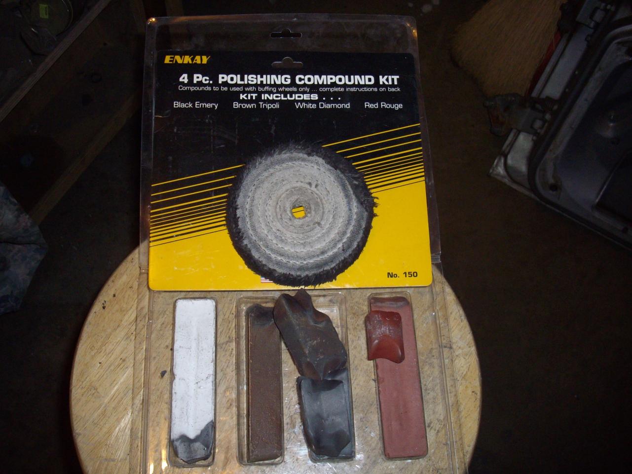

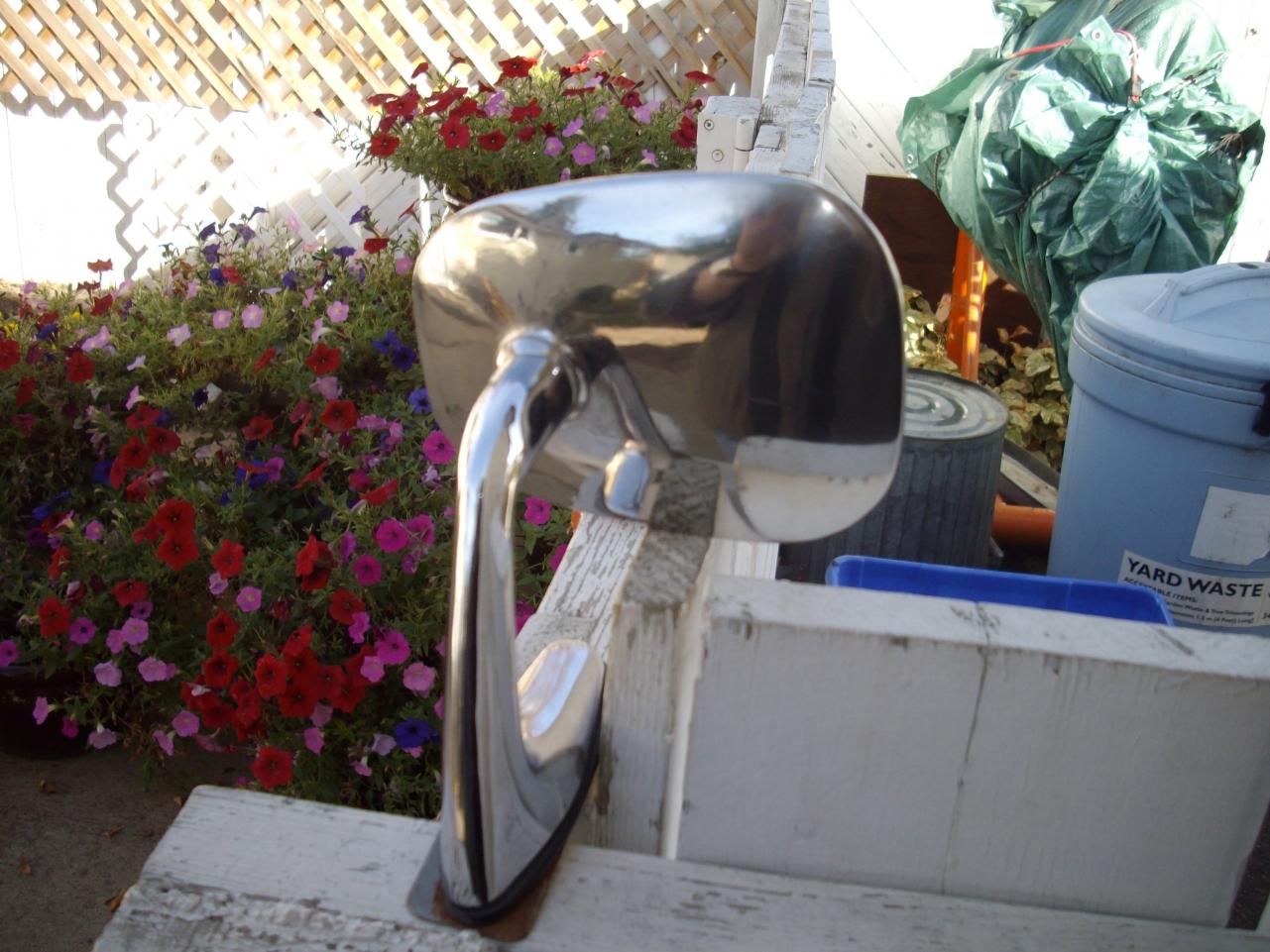

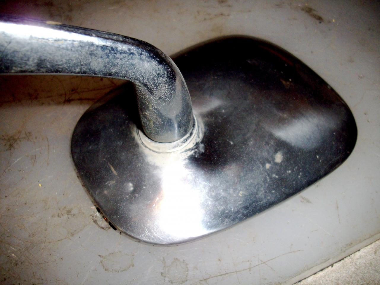

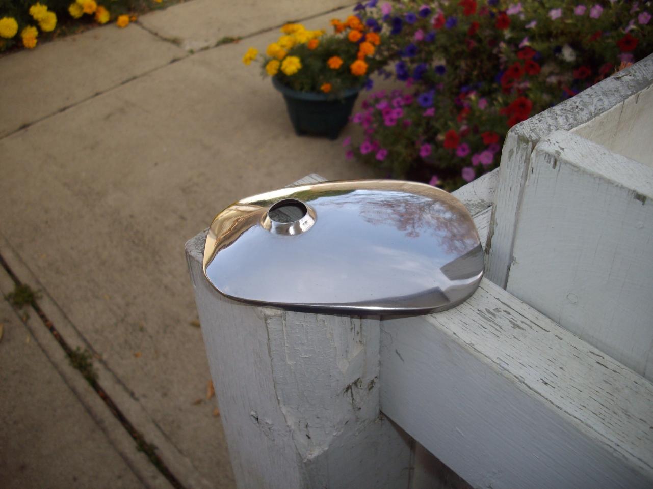

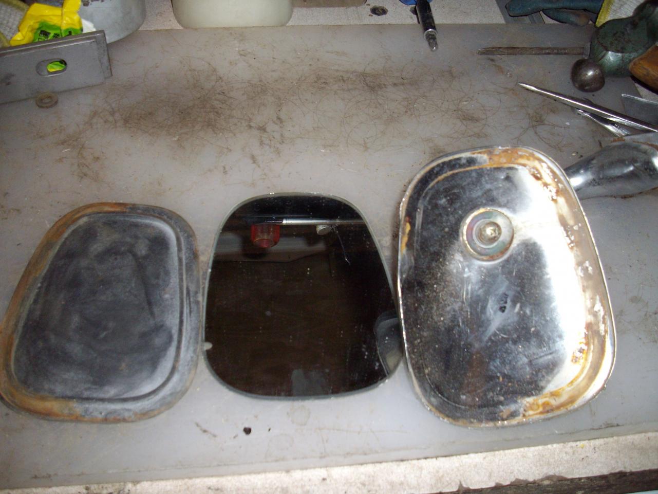

While digging through my pile of parts, I found that I did not have a good outside mirror. So I decided to try and see if I could bring one of the damaged mirrors back to life. I picked one that had a major crease on the backside and a couple of small dents. Using a hammer and a blunt chisel I was able to open up the outer fold that holds the mirror in place enough to get the mirror apart. After some hammer and dolly work, a file to knock down the high spots it started to look OK. Some sanding, a bunch of power buffing and polishing and it looks good. Slowly folding the lip back over the mirror with a body hammer and it is ready to use.

btw, How did you get the stem so smooth after all that chalky corrosion in the first picture?
Blue I wondered the same thing, my original one to the car is good but the base is pitted, the only thing is to get the base off I got to remove the mirror. I might try this on the spare.
With this, it was not as pitted as the photo looks.

Siteuneen: FYI the second photo shows the parts, the mirror is not glued in, there is  a rubber backing pad and they just float in the body held by the rolled edge. The metal is quite mailable just take your time.
