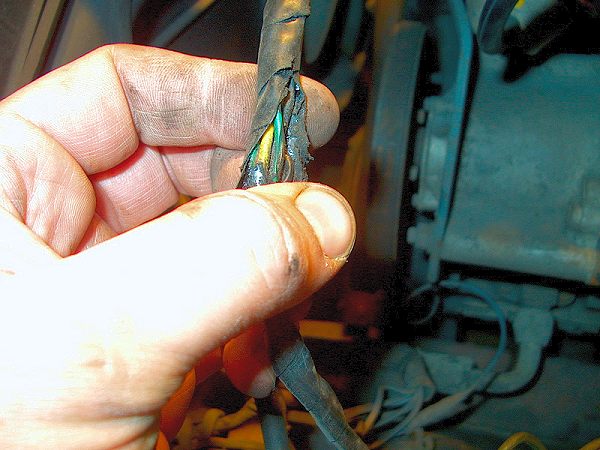

A friend's 260z would randomly die and it turned out to be an exposed wire from the distributor that had it's insulation damaged by the fan and it would intermittently be blown by the fan wind when driving and short to the metal in the area and kill the ignition system. You seem to have a similar strange happening. Check the low voltage wiring closely at the distributor/fan area.

My apology and correction, the wires were not damaged by the fan, it was damaged by a pulley (back in 2007). Here is a photo of the damage:

Checked the wires between the coil and distributor, no problems there. Checked the connections and tested the continuity, both seemed fine. Noticed some of the spark plug wires had a white corrosive buildup on the distributor ends, as well as the center distibutor to coil wire. Any reason I would have that issue? Replace the wires? Any other thoughts?
