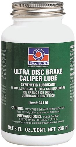

You will need brake fluid and caliper grease.
