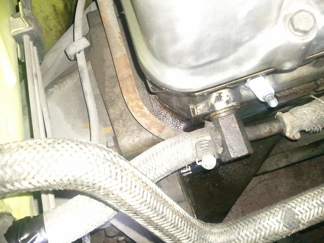

It seems i need to change my head gasket, i removed the oilpan and there was some white substance with oil..
I've never changed head gasket, so all the hints are valuable to me. I really hate the idea that i need to dismantle half motor but guess i have to.

Bump. Now i've located a coolant (?) leak in the 6th cylinder. Also the gasket is a bit swollen from the rear. That explains why i have to top up the radiator quite often. All hints are more than welcome to ease this task. I need to have this car running in 2 weeks so..
edit. i have no oil on the water and no goo on the oil.
