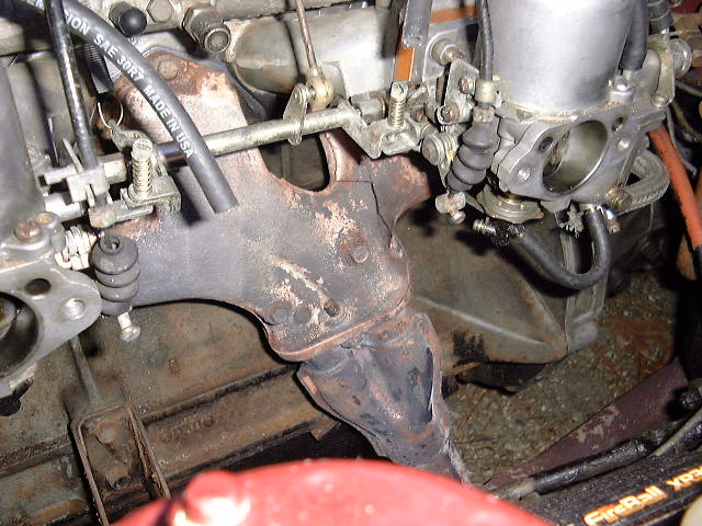

I cranked the 260Z up this morning to do a bit of tinkering & I heard exhaust sounds in the engine bay. I'd wrapped the exhaust with a heat blanket a couple of weeks ago to reduce the heat in the engine bay. Now I have a crack along one wing of the manifold (picture).:dead: Anyone seen this before? It's a first for me.
I'd had overheating problems for most of the time I'd owned the car. New water pump, new fan, system drained, radiator removed & cleaned, replaced the exhaust manifold gasket, all leaks fixed -- still some heat. So, I'd added the blanket. It did reduce the engine temperature a bit ... but it looks like it overheated the exhaust manifold -- or maybe I got it in a bind when I replaced the gaskets?

Could have been heat, stress, or just plain old age or corrosion that cause it to crack like that. You could have it welded, but you will need to find someone that can weld cast iron. Cast is one of the hardest things to weld correctly. You might be better off either finding another manifold, should be quite a few up for grabs since so many people have already replaced them with headers. It would probably end up being much cheaper in the long run if you replaced it with another used manifold as the cracks are so large.

Been there' Ruined that!! Once upon a time I wrapped my header tubes with a blanket type stuff also. Same results. Seems keeping that heat in is not good.Mine was done in an effort to stop vapor lock.As best as I can recall it worked ---except for that one small drawback---holes blown out of the header!!! Oh yeah in case you're following my footsteps-you can't sandblast headers either. Have fun!! Daniel
Thanks Daniel. I thought it might have been the blanket. Think I'm just going to park it till after Xmas & then look into getting the header. Means I'll have to sort out the temperature problem as well! :ermm: Good advice all...
