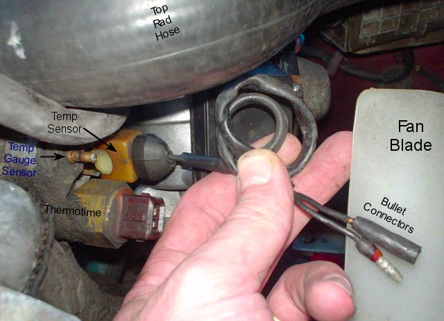

Check your water temperature sensor. It's on the front of the thermostat housing. It might be loose or disconnected.

I concur. There are also bullet connectors ~ 1 foot from the thermostat that could have come loose. Take a look at the photos here to see what I mean: http://atlanticz.ca/zclub/techtips/tempsensorpot/index.html

[photo]-The sensors themselves are mounted directly below thermostat. Check connectors for proper seating (clips), corrosion (accelerated by old/crumbly/broken rubber boots).
Stray coolant could have even contaminated AFM connector (bottom)
Don't ask how I know this...
fwiw, when I had my coolant temp sensor unplugged, it wouldn't idle at all and I could barely get it to run. LIke already mentioned though it could be loose or corroded connection. you can test the sensor with an ohm meter, the values are in the FSM

It's the same type of connector as on the injectors. If it's crumbly (which it probably is), go to a wrecking yard and get a quick release version of the connector from a Volvo (?) or some other car. The quick release connector releases when you squeeze the sides -- very handy for the front of the engine. While you're at it, grab a second connector for the thermotime switch next to the coolant temp sensor.
