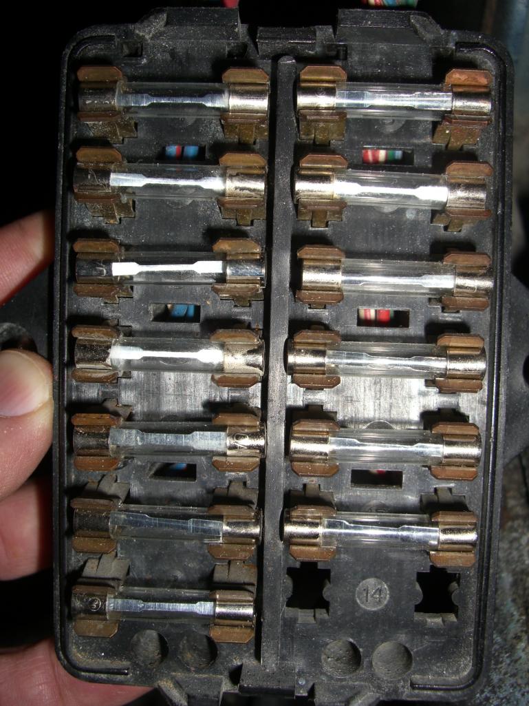

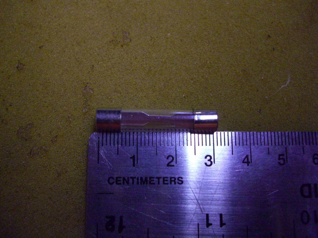

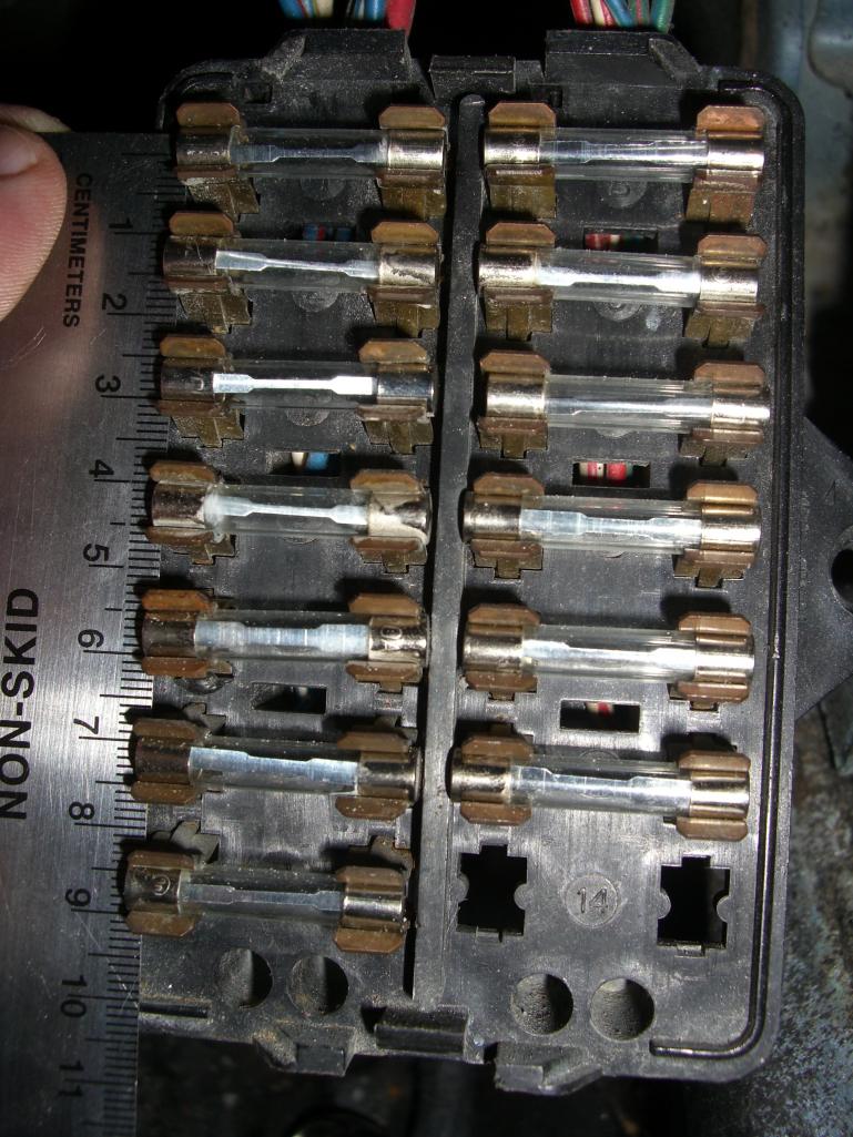

Here are some Fuse Box pictures from a 1978 280z to help you out. Notice the ruler for your reference.
IMHO - buy AGC style fuses, clean the Fuse box connections, Install correct Fuse in correct place with dielectric grease. Relax.

Thank for the pictures and answers. I ended up getting this job done tonight. I bought a bunch of fuses, of ACG and SFE. After I saw the SFE fuses, I could see that they were not going to fit into the 1978 fuse box. OK, will maybe one or two of them might fit, but as the amps went up they got longer. That is how they are designed I learned today.
Sooooooooooooo, I ended up buying a bunch of ACG fuses. Once I pulled out all the old ones, they were definately shorter than the new ACG fuses. But after disconnecting the battery, I was able to start popping in new ones to see how they fit. While they seemed longer, I realized after doing this, that the center of the fuse box has a plastic wall in it. Which protects both sides from each other. I didnt notice that the night before LOL
