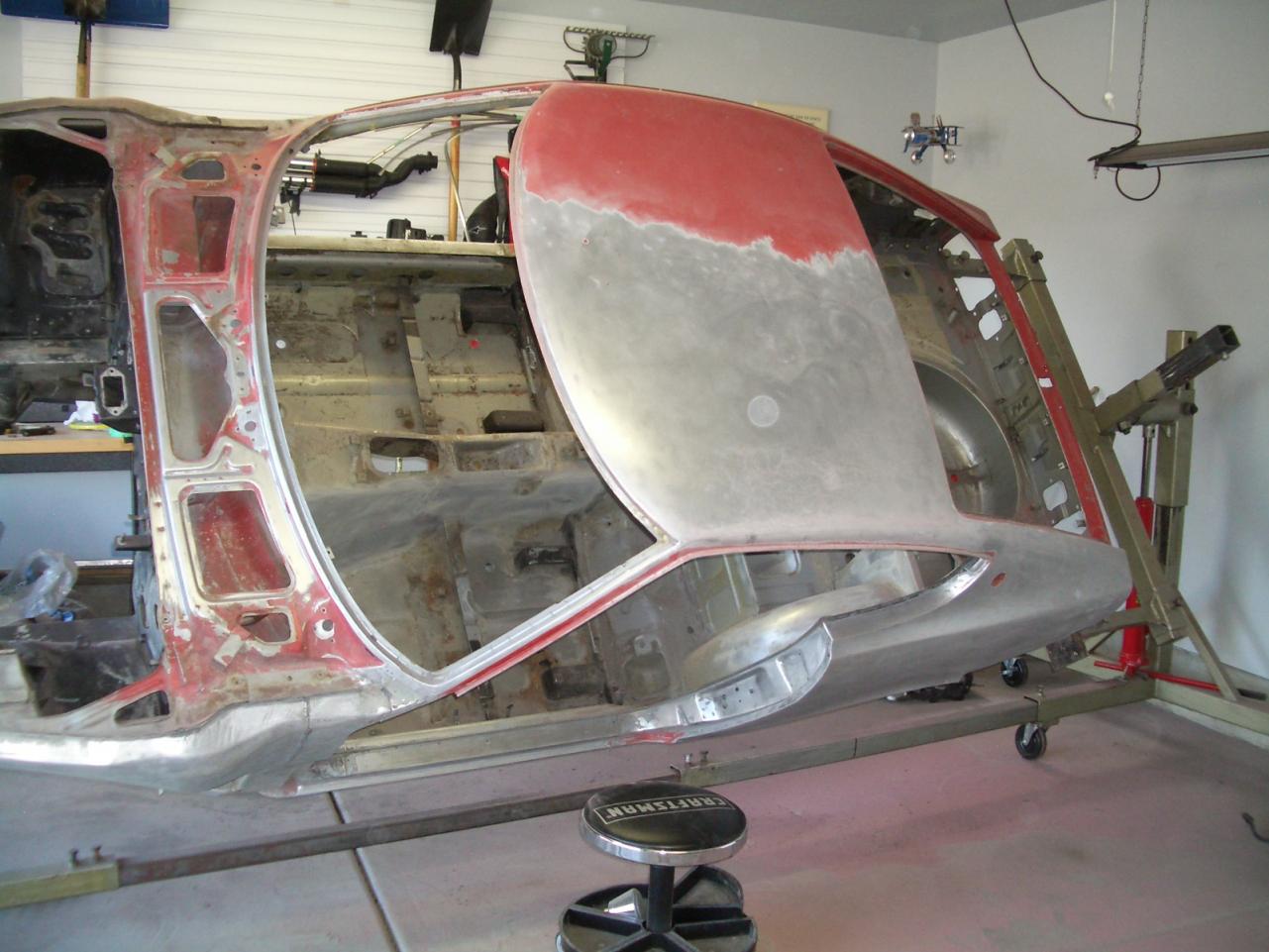

Started tearing her apart on November 21st and made good progress with the help of a great friend from Lithia Nissan and my Brother-in-Law, Steve. I've got a rotisserie that was loaned to me by some very generous and helpful 'Z Car Club of Southern Oregon' members (Thanks Steve and Ken!!). In the past eleven days or so, all that remains on the car is the rear suspension and drive train. Steve helped me get the engine and transmission out and all the parts transferred to the storage unit over one very long day. My Dad helped me get the asphalt floor board insulation and the remainder of the interior out of the car while he was visiting over the past few days.
I had to rearrange my garage to accommodate the car with the rotisserie attached and thankfully, it will fit in the garage. The rotisserie is attached to the car but I have yet to true it up and tighten all the hardware. I also removed the front suspension from the car yesterday with the exception of the front sway bar which has a broken nut inside the frame rail. Bummer!!

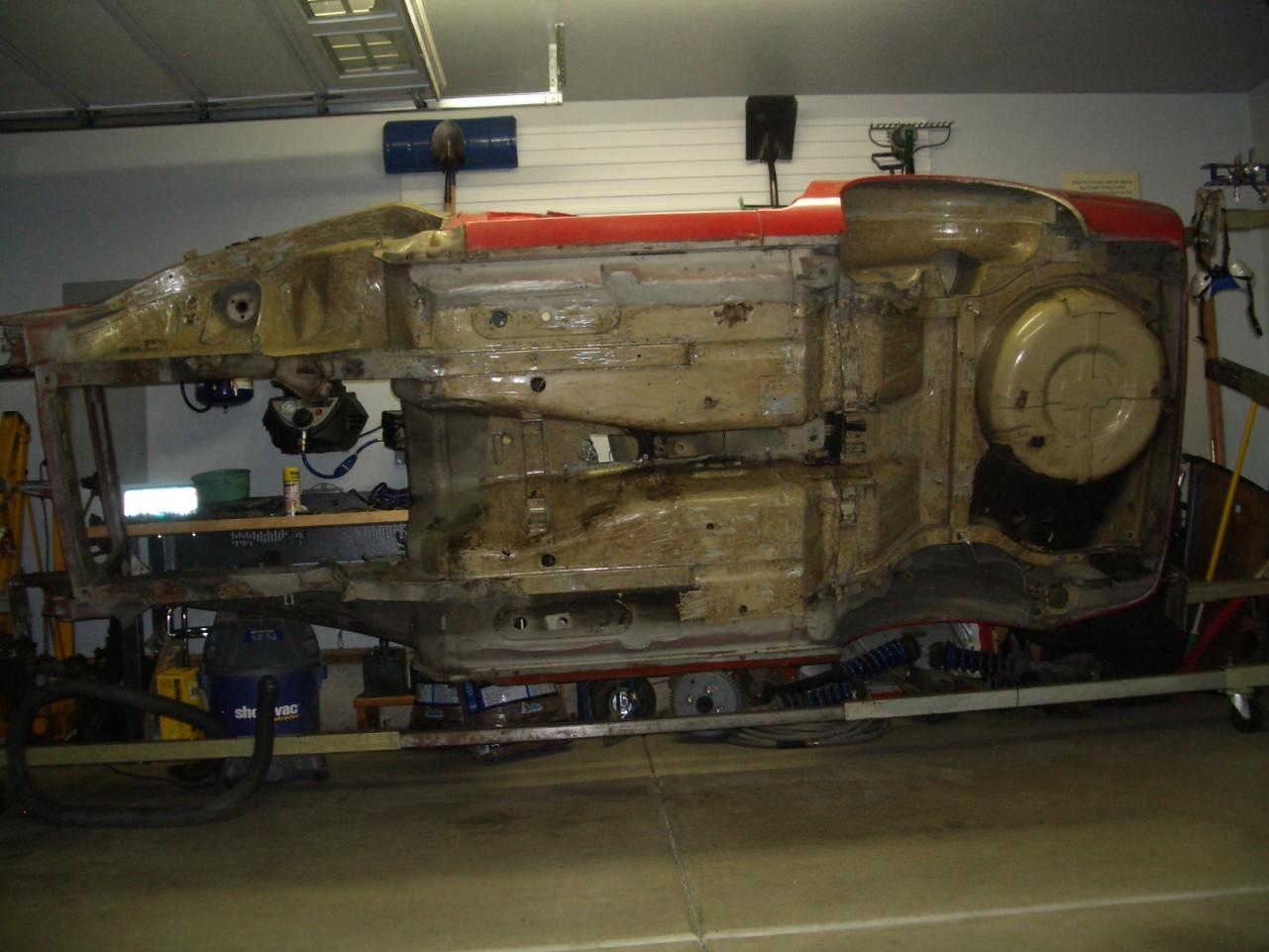

So here are a few pics of where I'm at now...
No more of that nasty insulation on the floorboards...

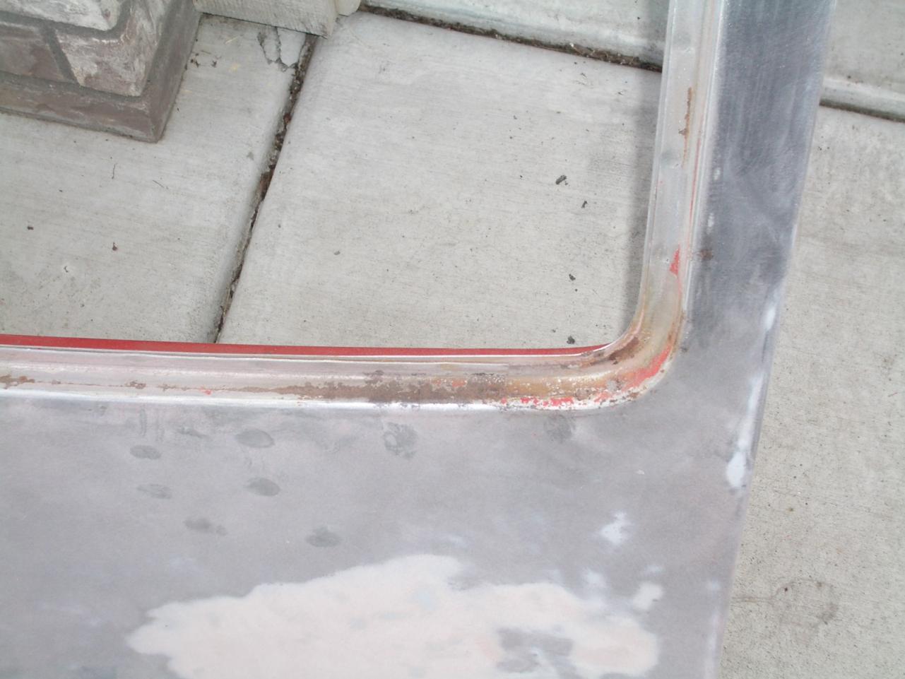

There is a little rust that will need to be repaired...
Looks good other than that...

The good news is the body is on the rotisserie and it's nice and stable. I'm taking apart the doors now and need to get the suspension pieces torn apart and all the hardware over to a friend's place. He's got a cleaner/polisher for all the nuts and bolts. That'll be great!

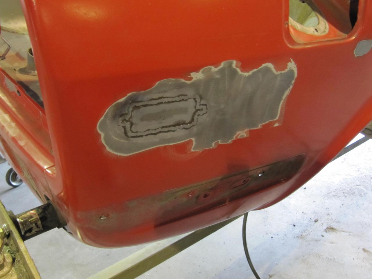

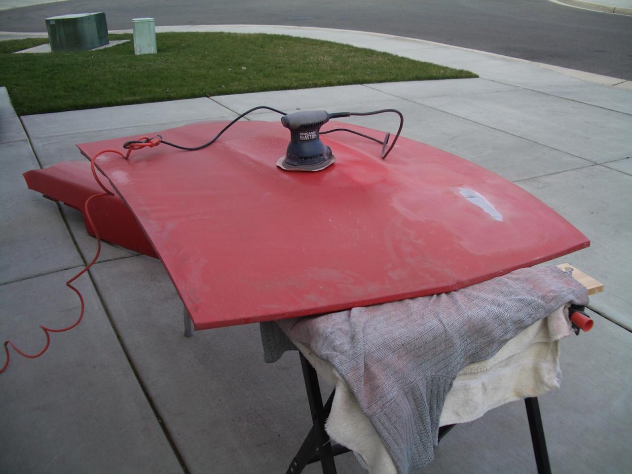

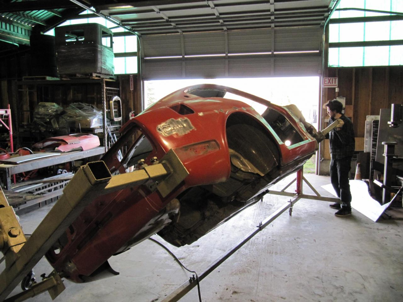

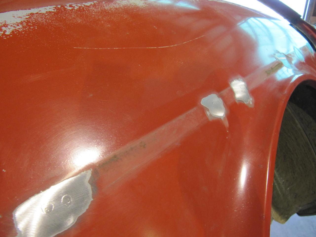

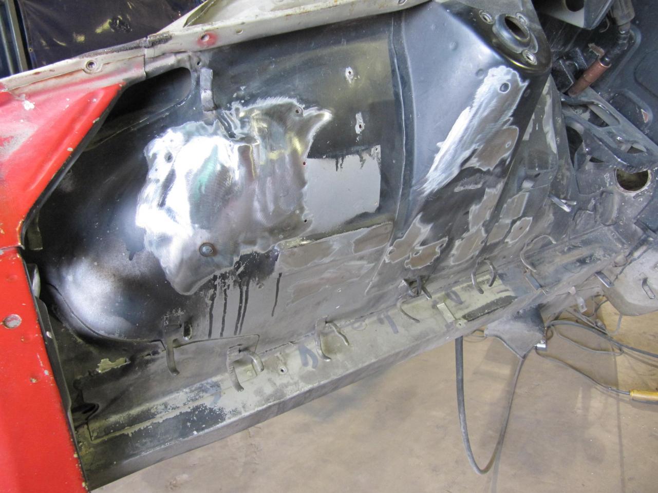

I spent the last week removing all the undercoating. Started sanding the paint off the bigger areas of the car but ran out of time before it was scheduled to go to Ferguson's Fabrication in Merlin, Oregon. They have the car now for rust repair, some filling of various holes in the body and finally media blasting. Still need to get the hood, doors and grille up to them today, that stuff wouldn't fit in the truck on the first trip...
Everyone at Ferguson's is great and they are making great progress as you can see by the photos they sent me last night after one day at work. Should start media blasting soon.
More pictures at my photobucket account if you're interested.. I think I posted it earlier.
