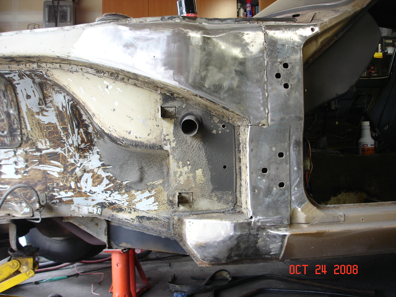

You may be refering to the 12 clips that hold the rubber strip to the body, that seals dirt and water from going out and over the inner fender into the engine compartment.
There are 6 clips per side, they hold a rubber strip that is about 1/8" thick, 30" long and1-1/4" tall?
In the picture below, the highest lip that you can see (with some black tar stuff on it) is the lip that the clips attach to and the clips hold the rubber peice up, to allow it to press against the fender, to stop water from going from the wheel well area, over the lip and into the engine compartment.
Confused yet?
Dave
