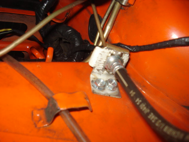

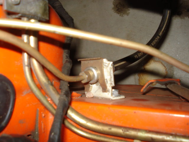

Guy, I think you will need an inner shift boot retainer like the one in the 1st photo attached. I put a 5-speed from an '82 ZX in my '73. No cutting required. But, you will probably need to install the tab to clip the clutch line into. It mounts on the passenger side inner frame rail close to the firewall. My '73 was an automatic car and did not have the tab. There were a couple of dimples there, presumably for locating the tab when they were welded in at the factory. I simply drilled a couple of holes and mounted the tab with sheet metal screws. Attached are a couple of photos of it. Hopefully you can get both of these items from the donor car. To remove the clutch line tab, simply drill out the spot welds.
Ken......Thanks for your reply......The inner shift boot retainer looks easy.....how about the outter leather shift boot cover.....how is that attached? As far as the hydraulic clutch line, I think I'm going to get Eiji to make me a flexible hard line to go from the clutch master cylinder to the slave cylinder. Mine has no stationary clutch line clip either. Oh by the way....where do you buy an inner shift boot retainer? Thanks........Guy
