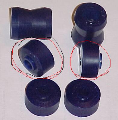

That's an interesting idea. That modified mount may want to walk side to side on the cross member as it is no longer solidly bolted to it. Possibly increasing the size of the hole in the cross member and using a poly bushing with a shoulder that would fit in the hole could eliminate that. Something like the shock absorber bushing I circled. At the very least it will keep the bolt from contacting steel.

I thought about that but then wondered how much side-to-side movement the whole drivetrain experiences since the motor mounts and mustache bar mount should prevent that...(?) I like the shouldered isolator idea or I could just have a spacer machined up that does the same thing if I can't find a properly sized shouldered bushing and put the urethane under that, then nut.
