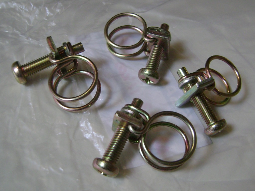

Here find attached original image of a NOS fuel hose clamp set. Note yellow zinc plating.
Edited by redzedsled
On the silver vs gold on hose clamps the small size on the vent tank 4/71 build was silver the rest were gold. The remaining original clamps were gold including under the dash.
Before y'all get into a scrap about the plating color of hose clamps...they were both...depending on year and design type. Early hose clamps, like on Her Majesty the 26th are silver zinc.
