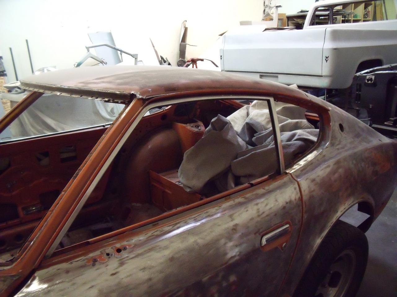

Seeing the donor roof sitting there in the first picture, I strongly suspect it was done as a roof skin replacement, same as mine documented in the thread linked below.
I gave a lot of thought to how to best do this. I don't know of many people doing the hole-patch job - all of the recent sunroof eliminations I've heard of have been using the entire skin.

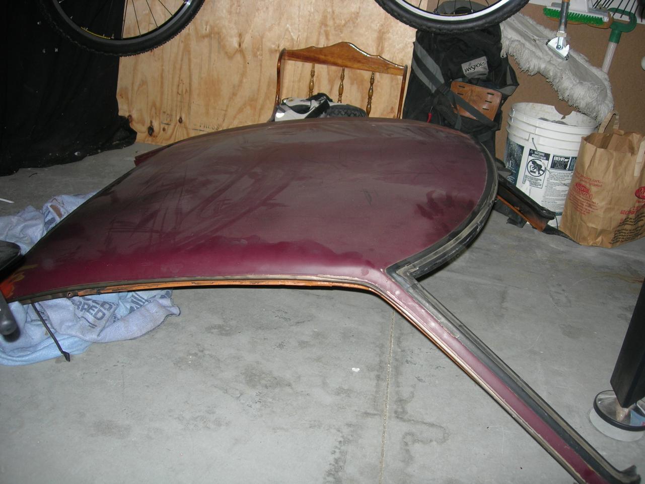

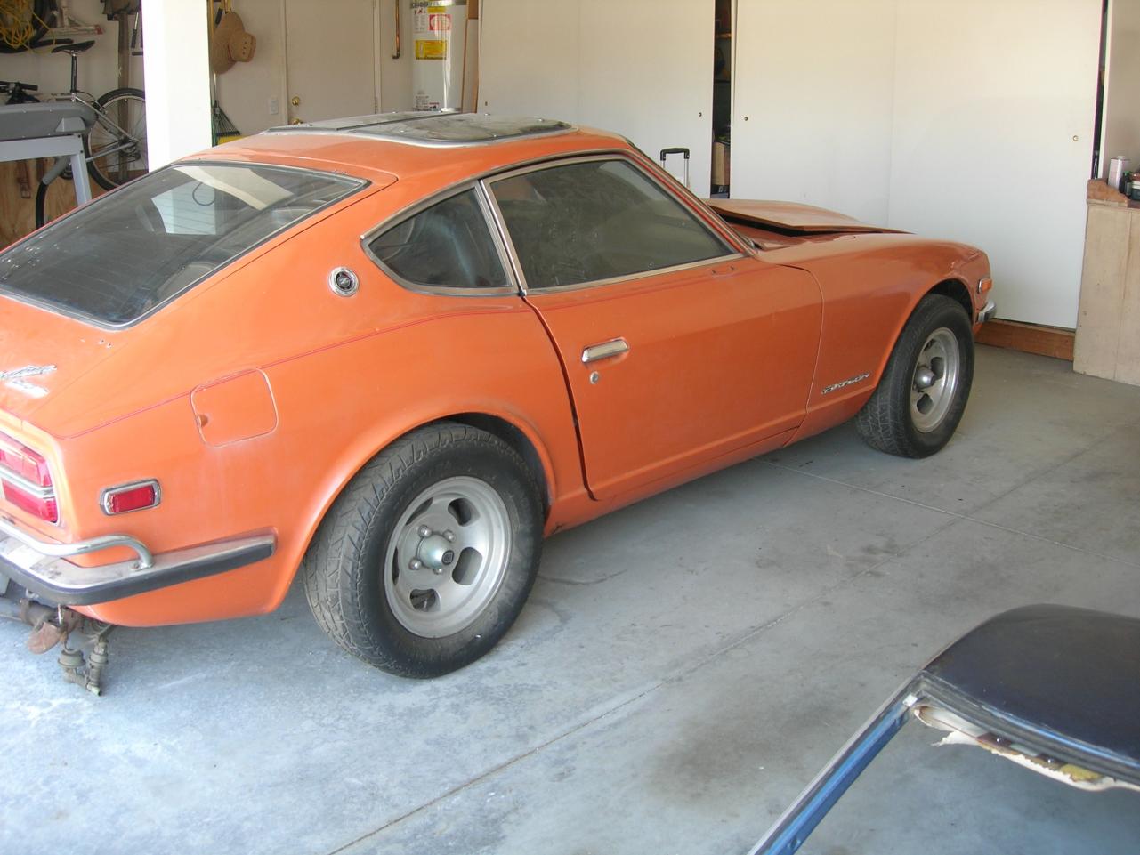

Yes, this was a complete roof replacement. Arne proved to me that it could be done. Thanks so much, Arne for the helpful pictures and advice!!
My suggestion to those who wish to attempt this is to make sure the donor roof is in good condition. The roof shown in my original post--did not work out, as it had too many 'waves' in it. The donor roof I used was acquired from Mike's Z Shop in Whittier--they do have more available.
Below is the donor roof--only the panel portion was actually needed (as can be seen in Arne's posts). In the other picture the panel is being tried for proper fitment. More photos to come....

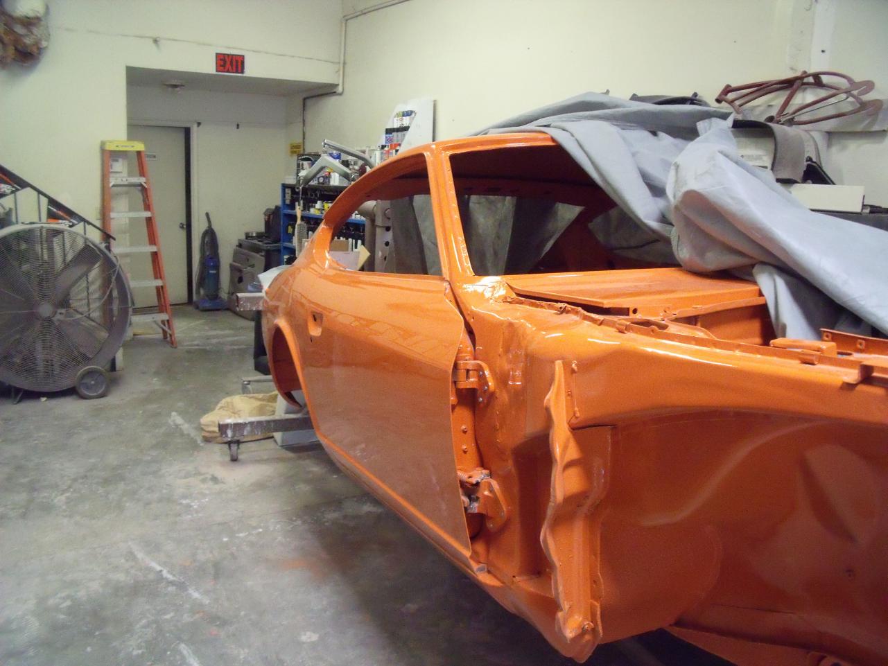

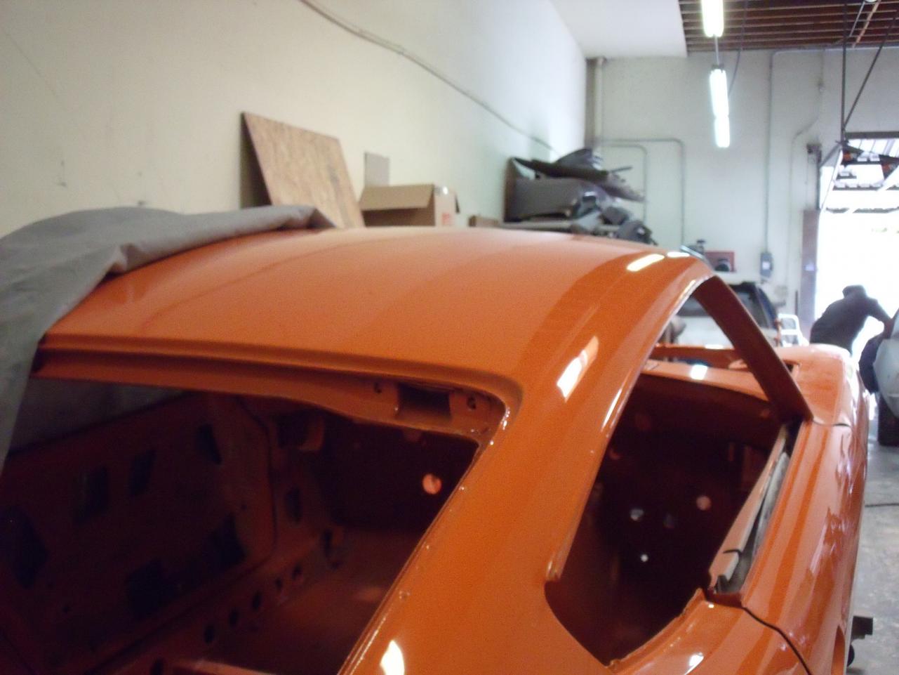

Carl...that is a fair question to ask... however, it is hard to give an exact answer as the "roof" was included as part of the body work.
Here's how it reads on the invoice:
"remove and replace roof panel" (part supplied by customer)
"remove and replace rear hatch panel" (part supplied by customer)--via Banzai Motorworks!
"cutout any cancered metal and replace (parts supplied by customer or fabricated by shop)"--this included replacing partial floor panels, repairing rocker panel rust, and fixing hole beneath the battery
The total bill for the body work portion came to $1,500
