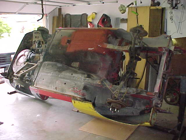

Ed, I built a rotisserie for my car when I restored it. The stands mounted using the bumper mounts (in the rear) and the under-tray mounts on the frame rails (in the front).
The stands were able to take the weight of the car minus doors, engine, transmission and glass. The suspension was still on the car when I first put it on the stands. It held up fine.
I have pics up on my website.
