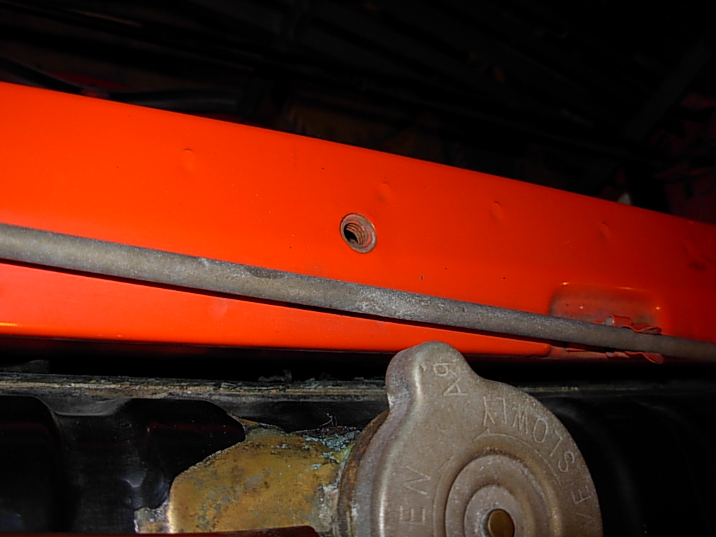

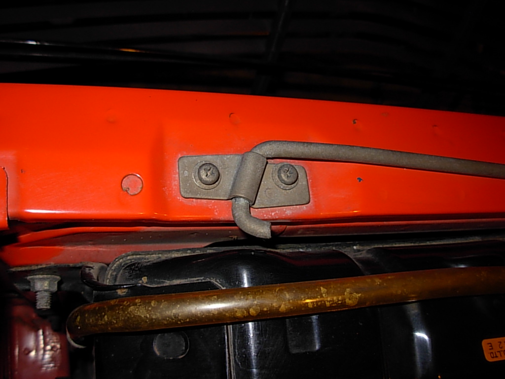

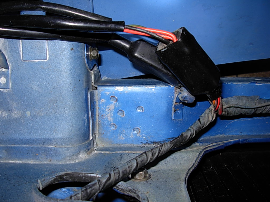

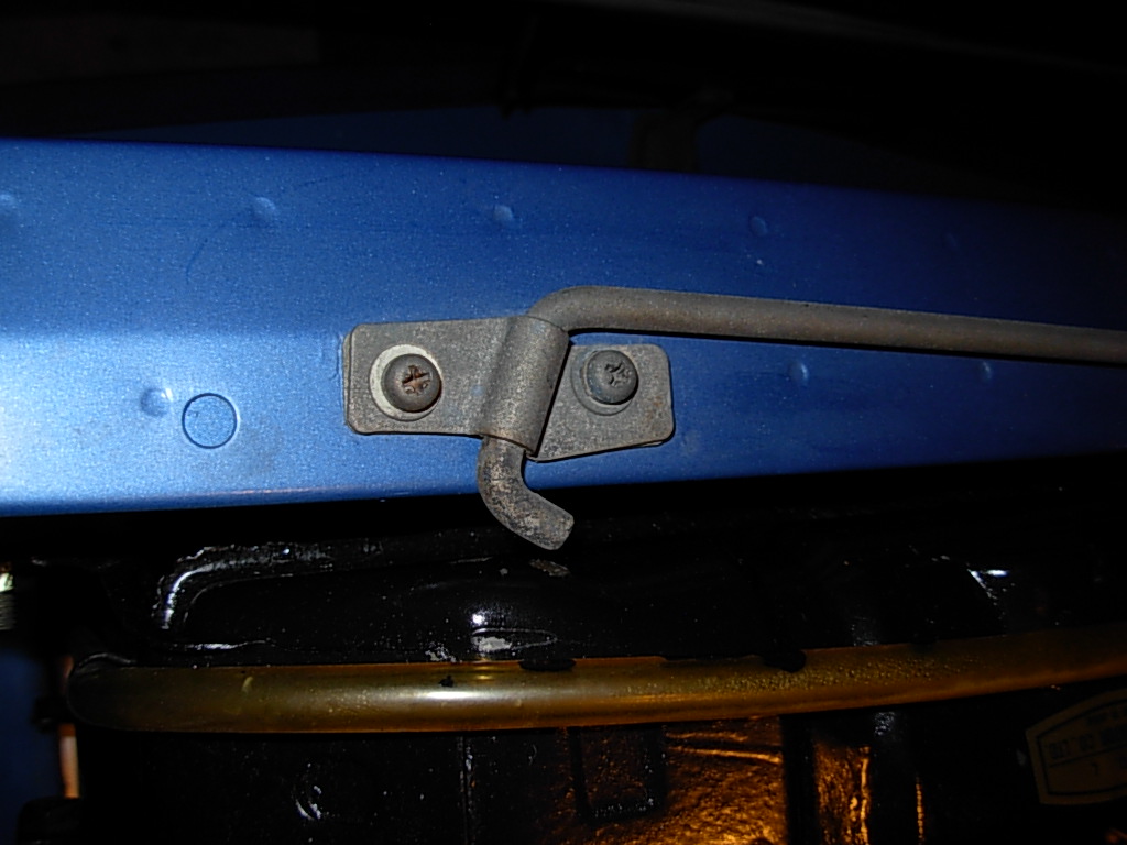

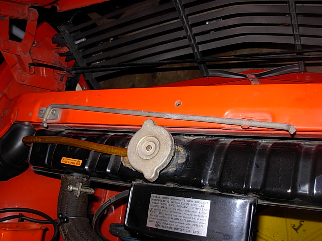

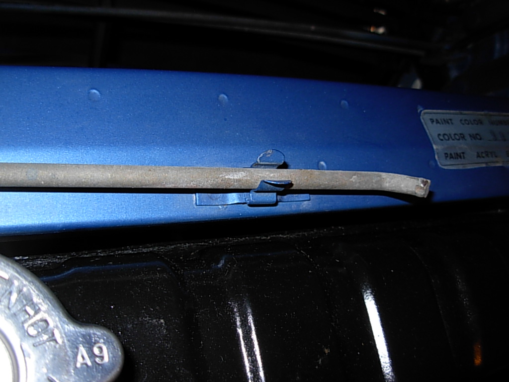

I happened to notice that the upper radiator support for my 5/72 is slightly different than on my 1969 production cars. The red car in the pictures below is my 72 and the areas where the hood support rod and the rod storage bracket are mounted are countersunk slightly. There is also a threaded hole near the radiator cap that isn't there on my early cars. I wonder what that hole is for?
-Mike

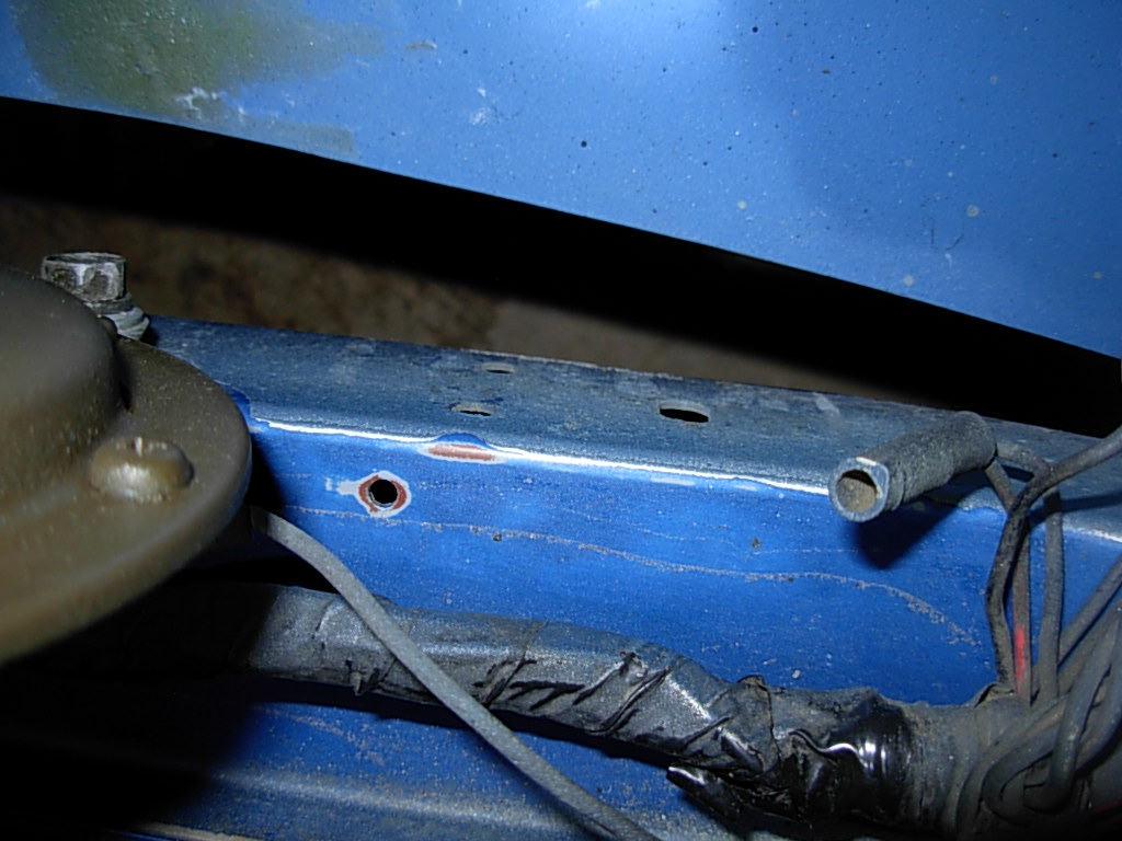

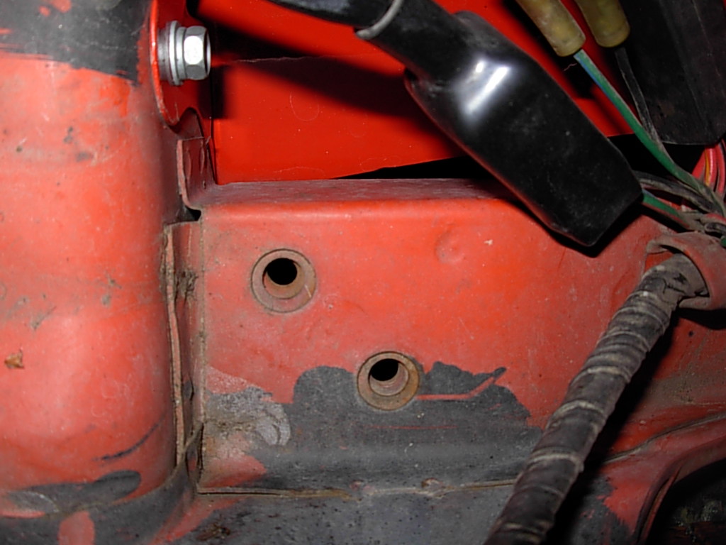

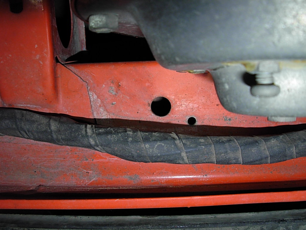

I checked and both the blue and red car have the two threaded holes in front for the oil cooler. It looks like the red car (72) also has a third smaller unthreaded hole. It seems I need to spend some time cleaning up the front of the radiators and supports on both my cars :).

My car, 4/71, also has the mystery threaded hole. But then it is an "early series 2" by the North American reckoning, (Vents on the side, not on the rear hatch) so I suppose it should resemble your 72 more than the 70(69).

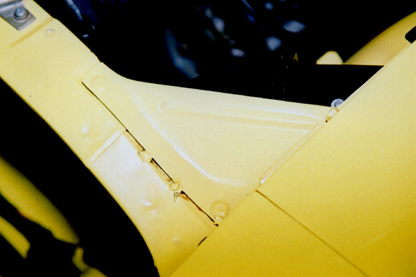

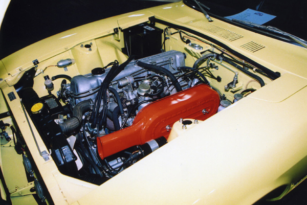

Here is a picture of a low mileage July 1970 build car that 26thZ posted some pictures of from the 2005 Zcon. It looks like it has the countersunk areas and threaded hole on top of the radiator support.
-Mike

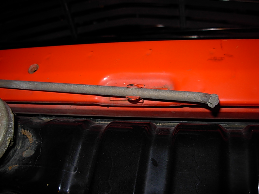

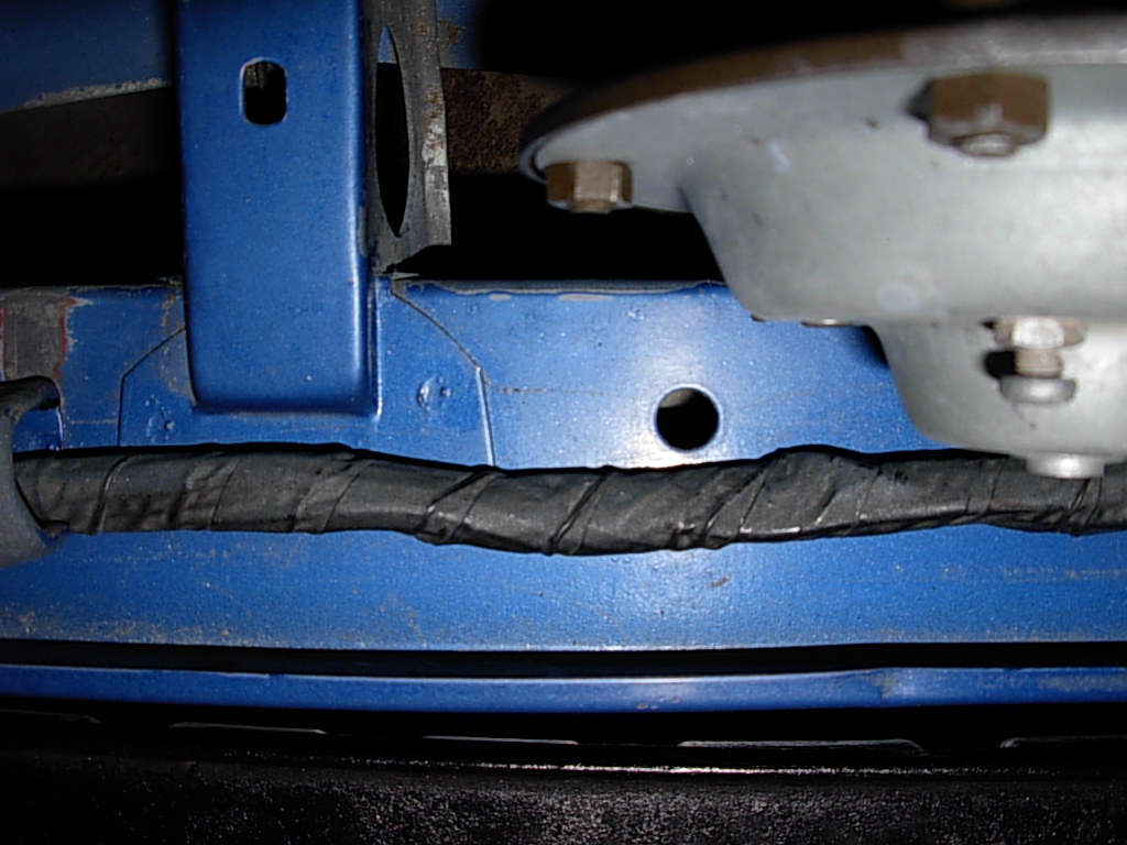

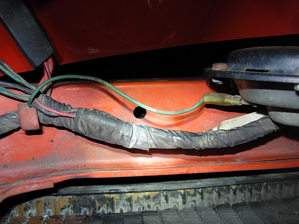

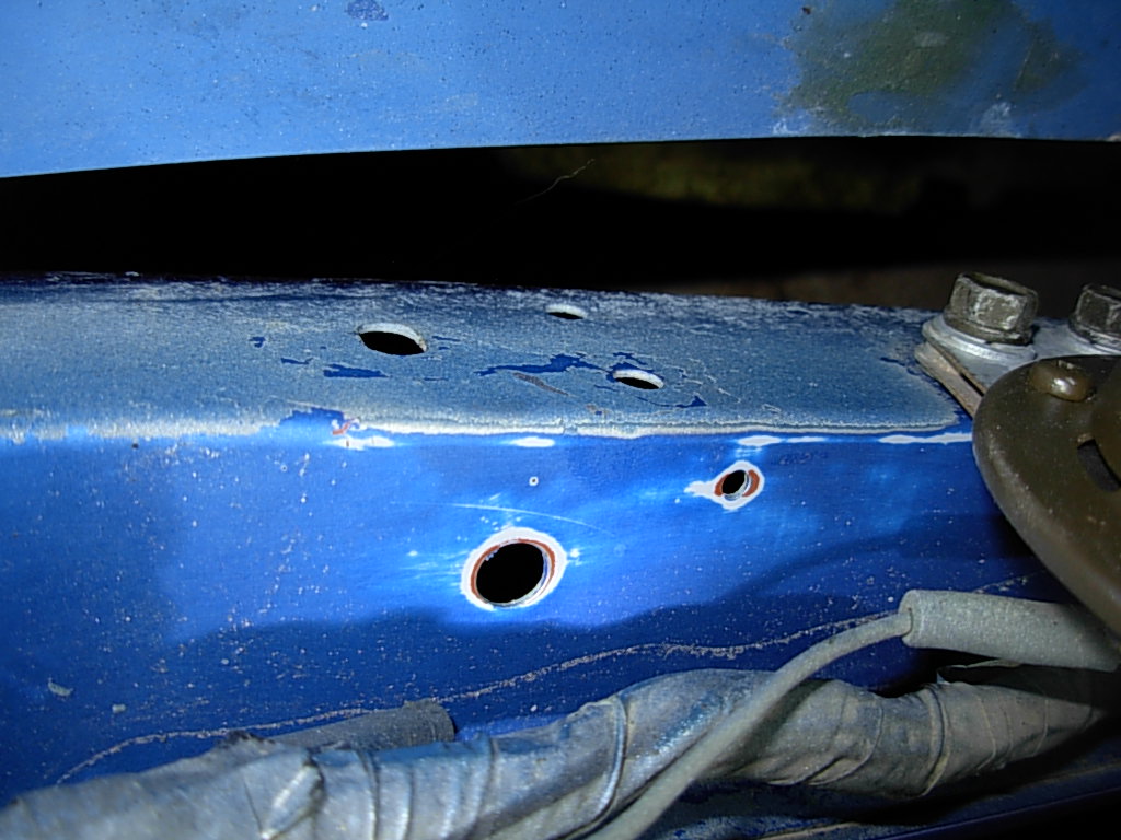

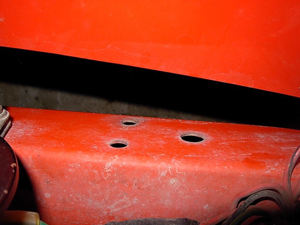

Kats, I was wondering about the bottom holes. Are the lower holes used to mount the oil cooler on the top of the support or on the front (next to the holes used to mount the horns)? On both my cars it looks like there are three hold on the front of the support next to each horn and a couple of holes on the top of the support. None of these holes look like they are threaded. Are nuts needed to attach the bottom of the oil cooler?

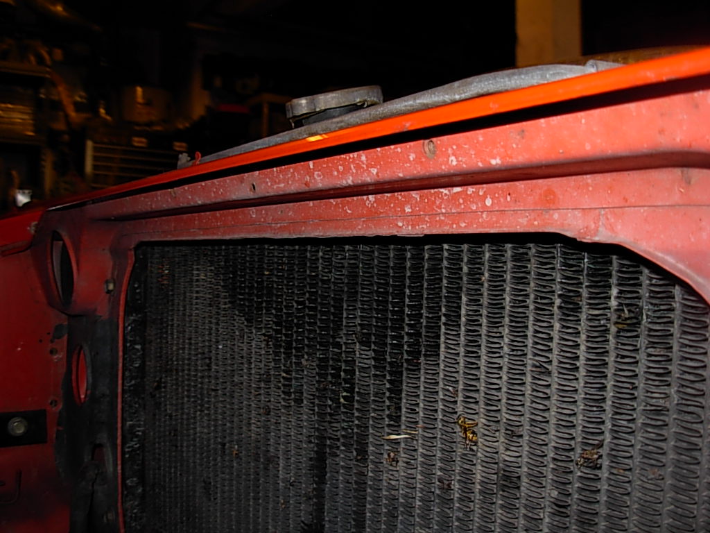

I also noticed that my red 1972 has two threaded hole in the top of the left corner of the lower radiator support, but the blue car does not (see the last two pictures).
-Mike

My 10/70 has the mystery weldnut on the top also.
